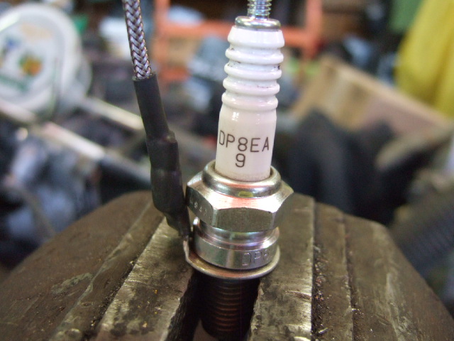

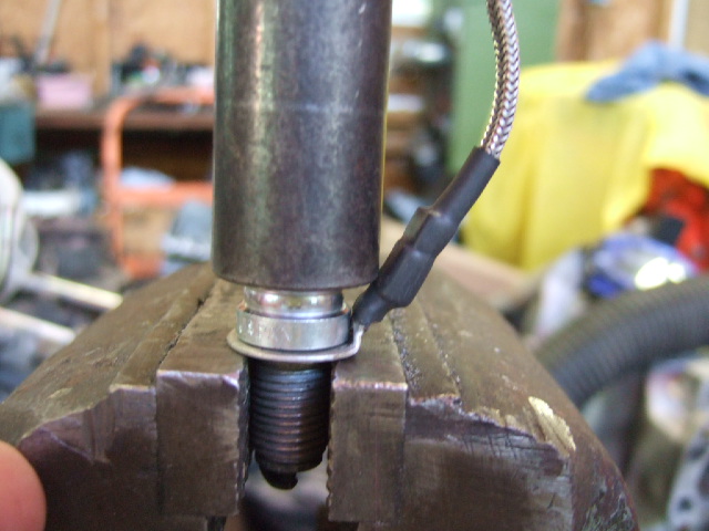

I recently put in a CHT. I typically see temps around 350 with spikes near 400. The temps vary a lot during a typical drive. I installed it with the engine in the car.
My friend had taken a spark plug and cut it in half, leaving only the threads, filed it with epoxy and put a screw driver slot in the epoxy. I used his "plug" in my spark plug hole while I used a dremmel to modify the head to accept the ring terminal. No metal in the eninge.
