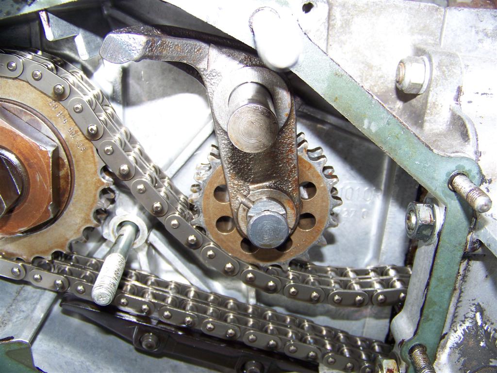

Pulled off the covers today. Not sure where to go from here. I guess I need to find a book or site with some directions.

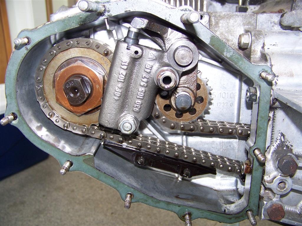

These came off easy enough and the glides that the chains ride on
came out without much effort.

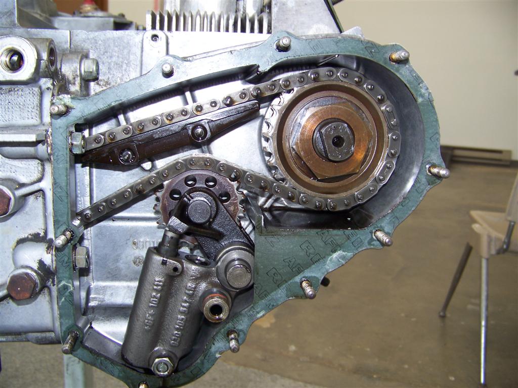

I'm going to try to keep track of what part goes where
