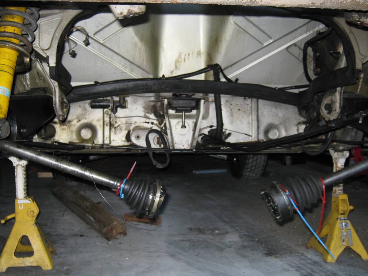

Okay, Okay, Okay.....I couldn't resist.
Here is what I want removed and I can't get them out of the trailing arms. ?

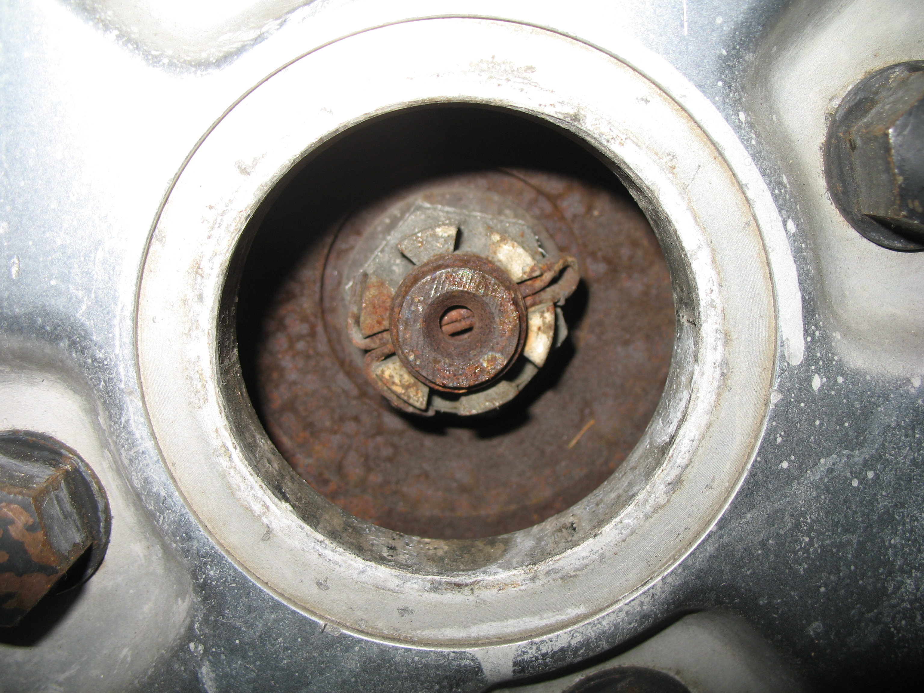

Here is what I did. It seems possible to do it this way on the car. I'd tried liquid wrench, a torch, and a 1/2" impact socket before this without success. That is a 3/4" breaker bar with a 4' pipe.
(IMG:http://www.914world.com/bbs2/uploads_offsite/www.914club.com-11782-1315102885.2.jpg)
