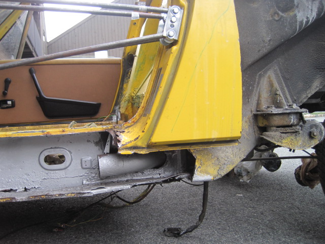

As much as I want to build one, I dont think have room for a rotisserie in this garage. I'm going to have to do the repair from under the car.
After looking at pics on the forum and crawling under the car I see how the longs and floor pans sandwich together now. I need to replace the bottom 2-3" of the inner long in places along with the complete floorpan.
Which bracing setup do you think will work better for inner longitudinal and complete floorpan replacement without a rotisserie?
These are from the Tangerine Racing site:
(IMG:http://www.914world.com/bbs2/uploads_offsite/www.tangerineracing.com-2075-1321115011.1.jpg)
And here is an integrated floor-to-door brace that scottyb has posted on a thread I found while searching the forum:
(IMG:http://www.914world.com/bbs2/uploads_offsite/lh3.googleusercontent.com-179-1353971333.1.JPG)
How much access to the passenger compartment will I need during the entire process? Will the bars that mount to the door provisions be strong enough given that I need to do work in the inner longs? Or, do I need to fab something that ties the hoop and floor together and leaves the doors in place so I can watch the gaps?

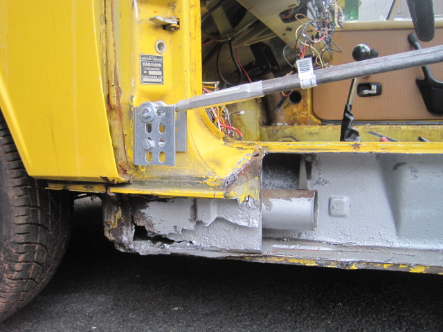

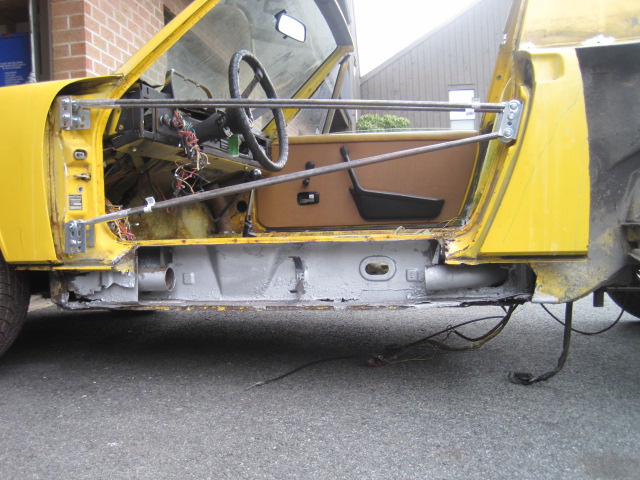

You can easily fabricate your own using readily availale turnbuckles and steel bars. My set up has 4 bars. I bought everything I needed at Lowes, but HD has identical stuff.
