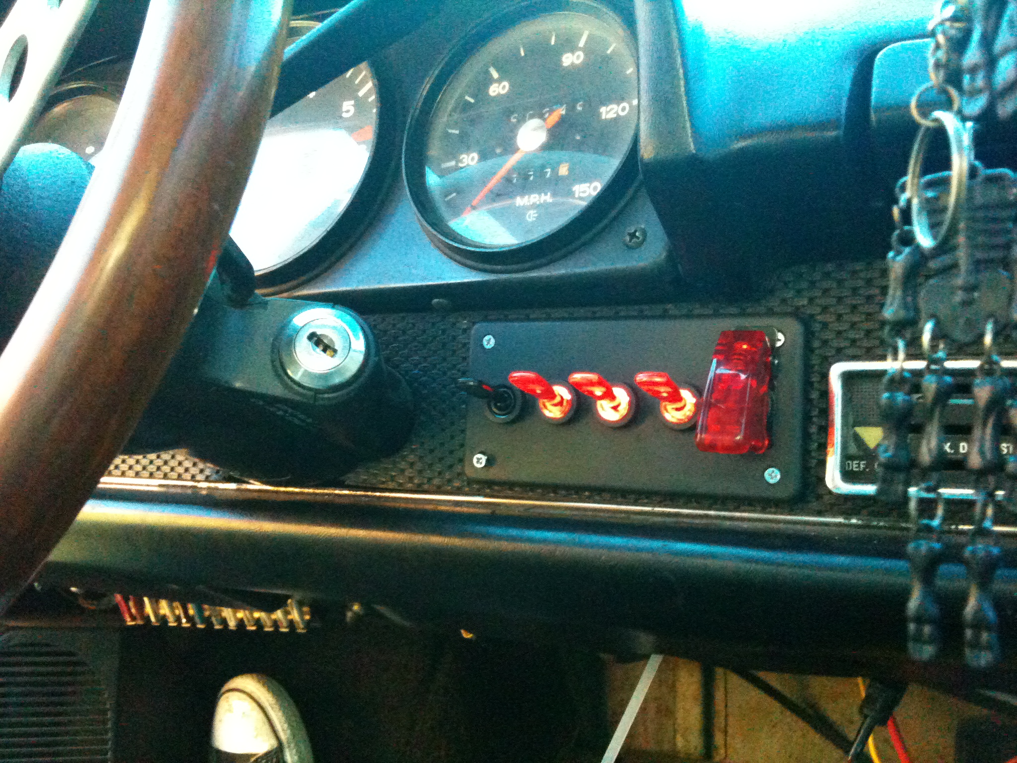

Howdy, first time caller, long time listener. I've got a '73 in yellow in the Austin, Texas area. PO did some mod stuff like the 911 master cyl and lowering the car. It has the requisite amount of rust and will be getting a whole lot of new metal when I pick up a mig machine. Also, I am probably insane - it is my daily driver ( I do have occasional access to a bug I work on) and after six months of working on it in a dirt driveway I finally have an old shed for a garage. The only real mod I have done is replacing the ignition switch. Those connections were all kinds of wonky when I pulled the old one so I put in a panel that separates the circuits with toggle switches and soldered the whole thing point-to-point. Master switch on left creates a hot bus, also mimics factory "off" or actual off, then radio, accessory, engine systems and then starter. Key is still needed to unlock steering wheel.
Now I have come across something strange. Alt light is on and gets very bright when I use blinkers or brake light. Headlights don't help, either. Idle is hunting like crazy and gauges seem a little erratic. Did the alternator diode test as per PP's article and neither B+ nor D+ tests killed the light, although they dropped the idle until the engine died. Problem started when I lost the alt belt and I replaced the belt and volt regulator at same time and was surprised to get no change. I want to get as much insight as possible before I tear that thing out. Any ideas?

Electrical is not my thing but you said you replaced the volt regulator. Just wondering if you tried others. Maybe its faulty? Also why did you change it?
The switches you posted seam to have quite the heat shown on the wires from the three middle switches. Was this from soldering or is this from over heating? If its from over heating I would check that out right away. I would hate to see a fire!

I replaced the regulator as I had been driving with no alt belt and since it was still messed up when I put one on I figured I had toasted the regulator. The burn marks are from me trying to hold the flashlight, hemostats and soldering iron at the same time while shooing mosquitoes. A touch sloppy but I over-engineered it so there wouldn't be any heat buildup - 10ga wire with lots of surface contact. Previously I was having to tap the back of the switch bundle every now and then when my headlights went out. I don't like those loose blade connections in a plastic housing business. AS far as the electrical problem goes, new reg's can always be bad too, but why did the idle drop when I shorted the two separate circuits and why is my idle hunting?

Alright, the switches wiring looked clean I just wanted to double check. I love the look of toggle switches!

(IMG:style_emoticons/default/welcome.png) If I were you I would get a dash and ignition harness and get rid of the toggles and all that solder. You have open hot wires and your asking for an electrical fire. You would be far better off finding where the DAPO started cutting wires and replace everything from there. As far as your wonky charging system, revert to the first suggestion then see if the problem still exists.

I like my version better than the factory's (no cluster of blades and an acc position) but I should cover up that hot rail. I have a feeling it is not the regulator since the D+ to DF short didn't kill the light. I am guessing I fried something in the alt, maybe these symptoms are the result of a busted winding trying to push two phase through the rectifier? I was hoping for a second opinion saying my alt was F'd in the A before going through that mess... I am an A&P student so I have a loose grasp of things but you just can't beat the hivemind of 914World! Thanks for the welcome, too!
