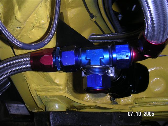

Thanks for this very helpful info One of the memers here posted this pic. I am doing a front cooler with AN lines and may do this to drain my oil.

QUOTE(Krieger @ Dec 16 2011, 01:14 PM) *
Traditionally the front cooler is in the scavenge circuit, while the tank drain line is in the pressure circuit (tank -> pressure pump).
Having a drain at the front for the cooler and the lines is sometimes done, but it's no substitute for the standard tank drain line (you'll never drain the tank through the scavenge side...).
Having a capped Tee is definitely convenient, although I doubt it's more so than just using a separable fitting with either two female hose ends and a union ( AN-815?) or a male and female hose end. Once you get into AN-16 (or larger) hose, all the ends and fittings are expensive...
That capped Tee scares me tho, without some kind of positive anti-rotation device. Maybe the cap is drilled for safety wire on the other side where we can't see... (As long as we're being picky, that Tee should be a bulkhead Tee with the bulkhead fitting on the Tee (they also come with the bulkhead on the run) and a proper bracket...)
brant
post Dec 16 2011, 01:15 PM
Posts: 12,278
From: Colorado
Member No.: 47
I chickened out on the T-drain idea when I built the race car
I like being able to split the hose, angle or point it where I want, and knowing that there are less fittings to come loose or create problems.
I actually saw a motor die once on a friend at the track... due to poorly designed oil line coming loose.
I put ALOT of money into the race motor and can't stand the idea of any unnecessary risk related to oil
(I do a full royal purple oil change every single weekend as an example of my "cheap insurance" thinking.... about 1 case on our system)
Krieger
post Dec 16 2011, 01:22 PM
Posts: 4,881
Joined: 24-May 04
From: Santa Rosa CA
Member No.: 2,104
I was planning on drilling the cap for a safety wire. I hadn't thought about a bulkhead T.

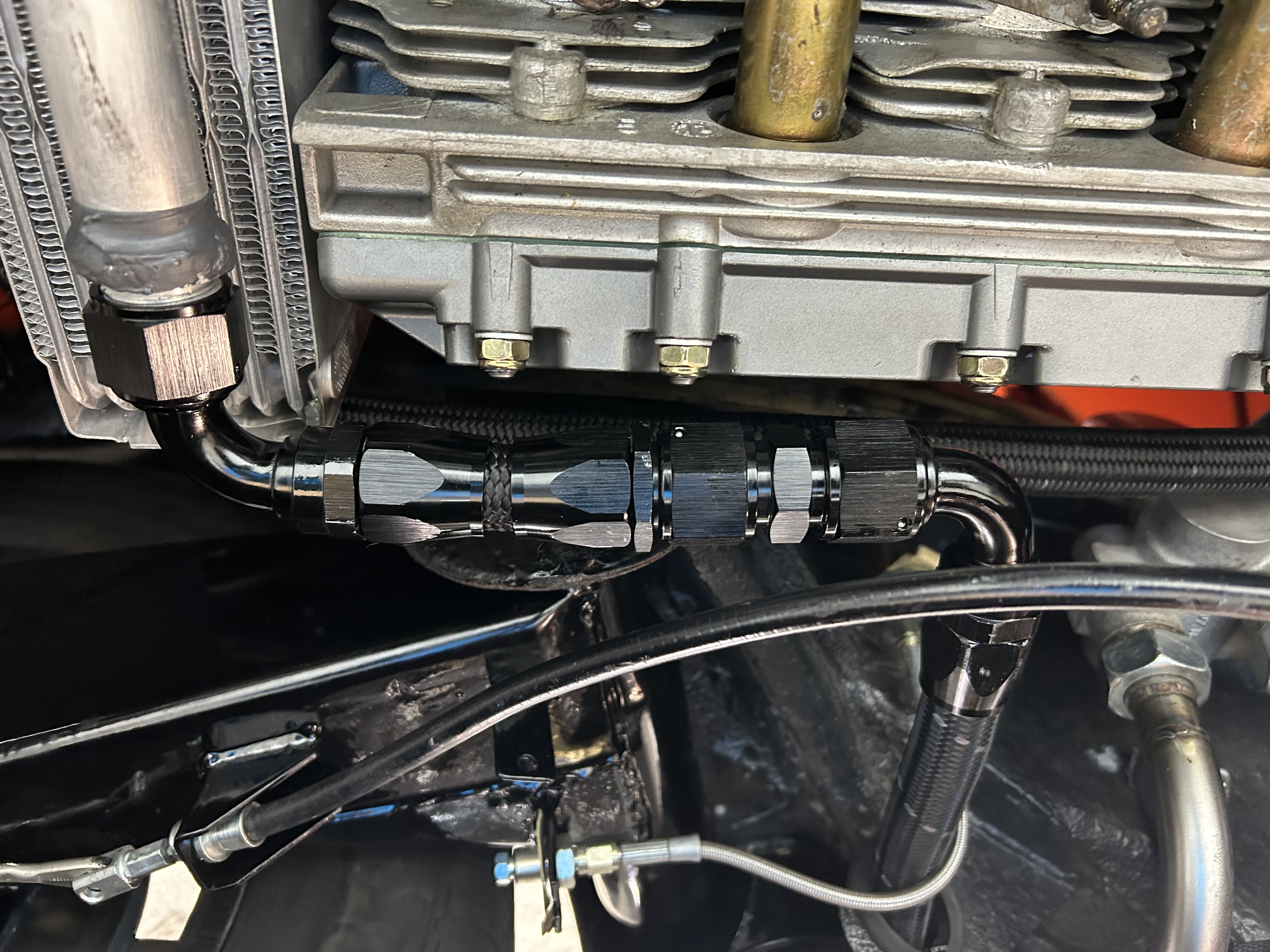

I did this for mineAttached Image

QUOTE(mb911 @ Jul 9 2024, 05:14 PM) *
Looks slick, no interference with your exhaust pipes? Mine is vey tight in this area
mb911
post Jul 9 2024, 05:47 PM
Posts: 7,813
Joined: 2-January 09
From: Burlington wi
Member No.: 9,892
QUOTE(930cabman @ Jul 9 2024, 03:35 PM) *
None whatsoever

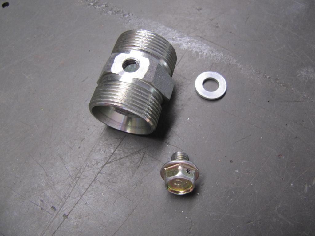

This is the solution I came up with. I ordered the factory oil lines from the the tank to the cooler. It came with a union. I had a face machined then drilled and tapped it for a drain plug. I drilled the plug so I could safety wire it.
Krieger
post Jul 9 2024, 07:43 PM
Posts: 4,881
Joined: 24-May 04
From: Santa Rosa CA
Member No.: 2,104
I am very happy I did this. It drains very quicky and isn't messy like disconnecting fittings. I use an aluminum washer from the valve cover as a sealing ring.
brant
post Jul 9 2024, 08:17 PM
Posts: 12,278
From: Colorado
Member No.: 47
QUOTE(Krieger @ Jul 9 2024, 07:43 PM) *
That’s nice
-12 or -16? Scratch that ….. pipe thread what size?
Where did you find it?
I’ve been splitting aluminum AN fittings in my line since 2005 without issues
Probably over 150 oil changes/events
Krieger
post Jul 9 2024, 11:17 PM
Posts: 4,881
Joined: 24-May 04
From: Santa Rosa CA
Member No.: 2,104
@brant I bought the oil lines from a major supplier. I cannot remember who. They were advertised as OEM. I was surprised to see the union when it shipped. I think the threads are the same size as the tank and oil cooler. M22 ?? I could dig through my receipts and find where if you want. I'm glad you have been able to get so many cycles out of your AN fittings.
