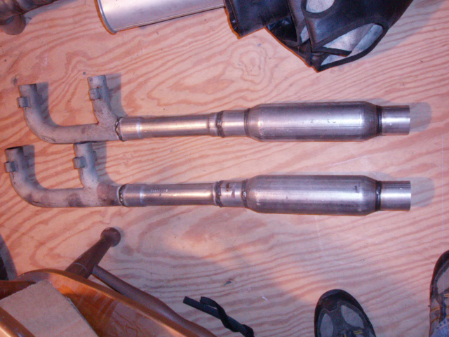

I have some engine run stand exhaust that you might be interested in!?

You’re right, it is a great exercise. I will be backdating exhaust using SSI HE, that's why I built the stand high like that for easy access. I think that for running FI I will need to connect the relay board somehow. I will probably use the main harness. I'm not sure that I'll be able to wire starter and fuel/fire separately like you did, I'll try though as I think that it's a great idea. What king of ignition switch and push botton start did you use?
Thanks,

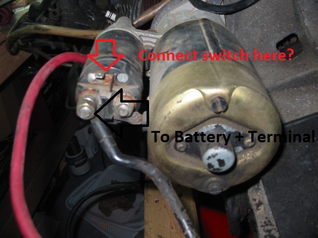

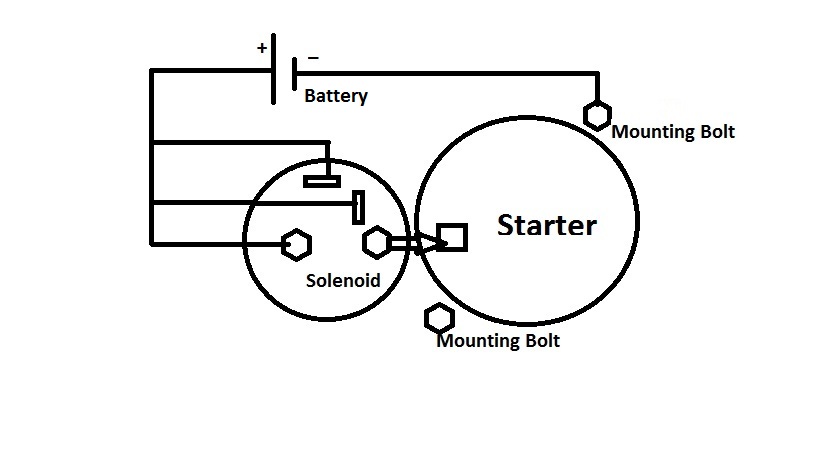

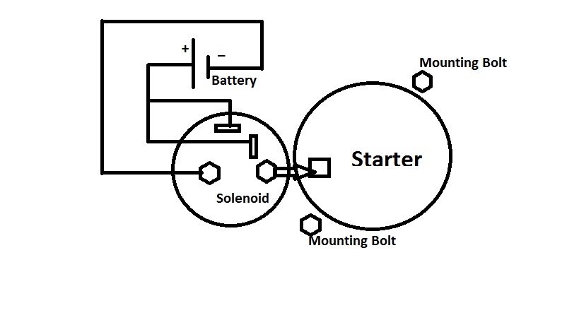

I'm having trouble with this seemingly easy task. I tried set up above with no luck. I then studied electrical diagrams on Pelican and changed the set up and still no luck.
Picture 1 shows set up #1 as desribed above - power from battery to the big left terminal and 2 small spade terminals. Picture 2 shows setup #2, as I understood it from diagram, power to 2 small spade terminals and ground to the big terminal.

The battery + should connect to the big post on the solenoid. The first pic has that right. The battery - would connect to the mounting bolt as in the first pic as well.
The flags on the back of the solenoid are electrically the same thing as each other. You connect one (any of them) to the battery + when you want the starter to crank.
--DD

Thank you Dave. I got Cranky! The ground connection was loose, once that was taken care of, everything fell into place.
