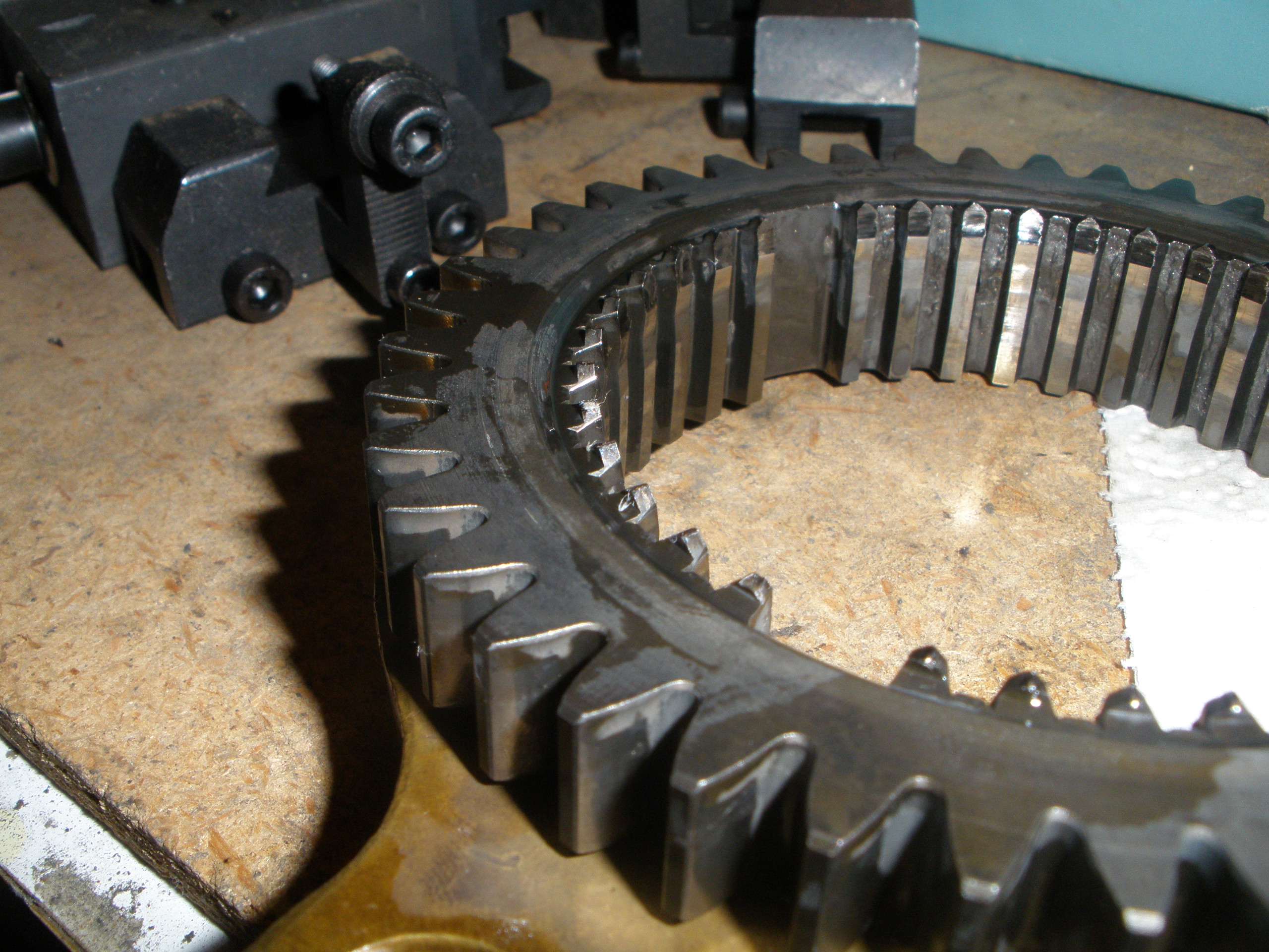

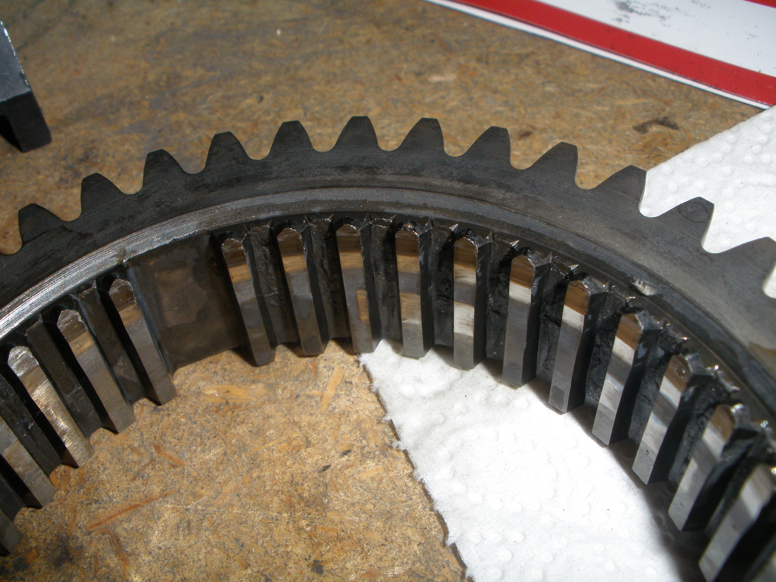

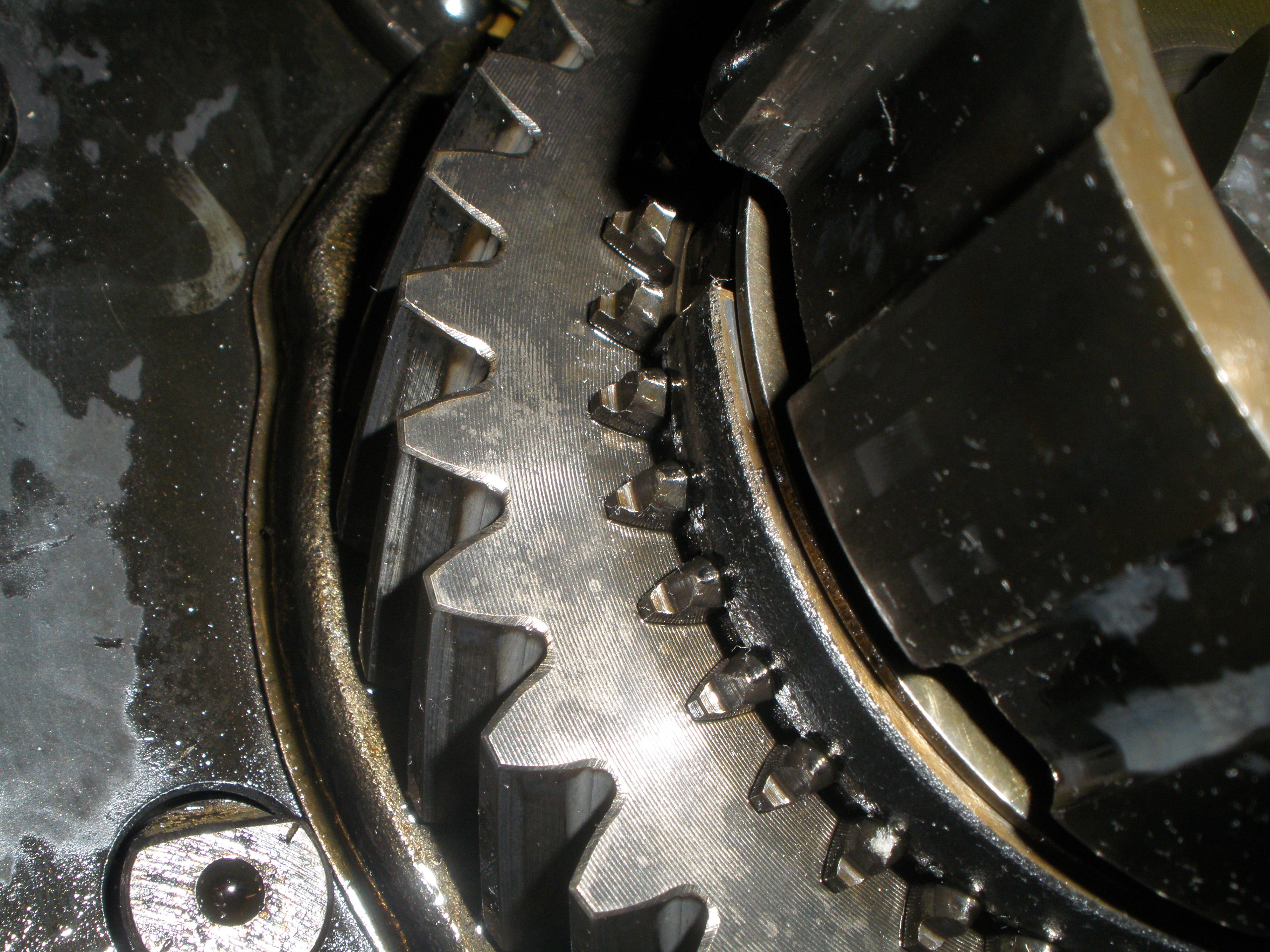

Hello guys,
I've bought my car without any test drive because it was unsed many years. Now my transmission is on my todo list. I already opened the case to inspect the 1st gear. I saw a syncro ring which seems to be less used but the dog teeth and the slider speeks other words. My impression.. I have to change slider, dog teeth and syncro. I added some pictures, who can distinguish between poo parts and reusable ones.

Your slider looks fantastic. The gears show typical wear. I do not see any galling in the pics so they should be good to go (IMG:style_emoticons/default/smile.gif)

Oh, while you are in there, you should change out the band and teeth. The teeth are not worn out, but they are on their way.

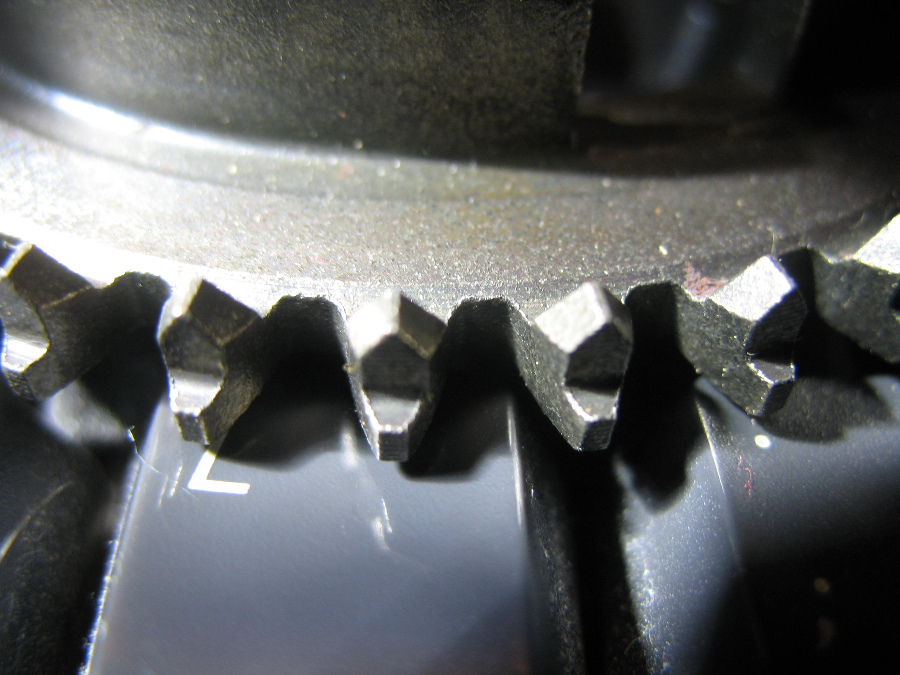

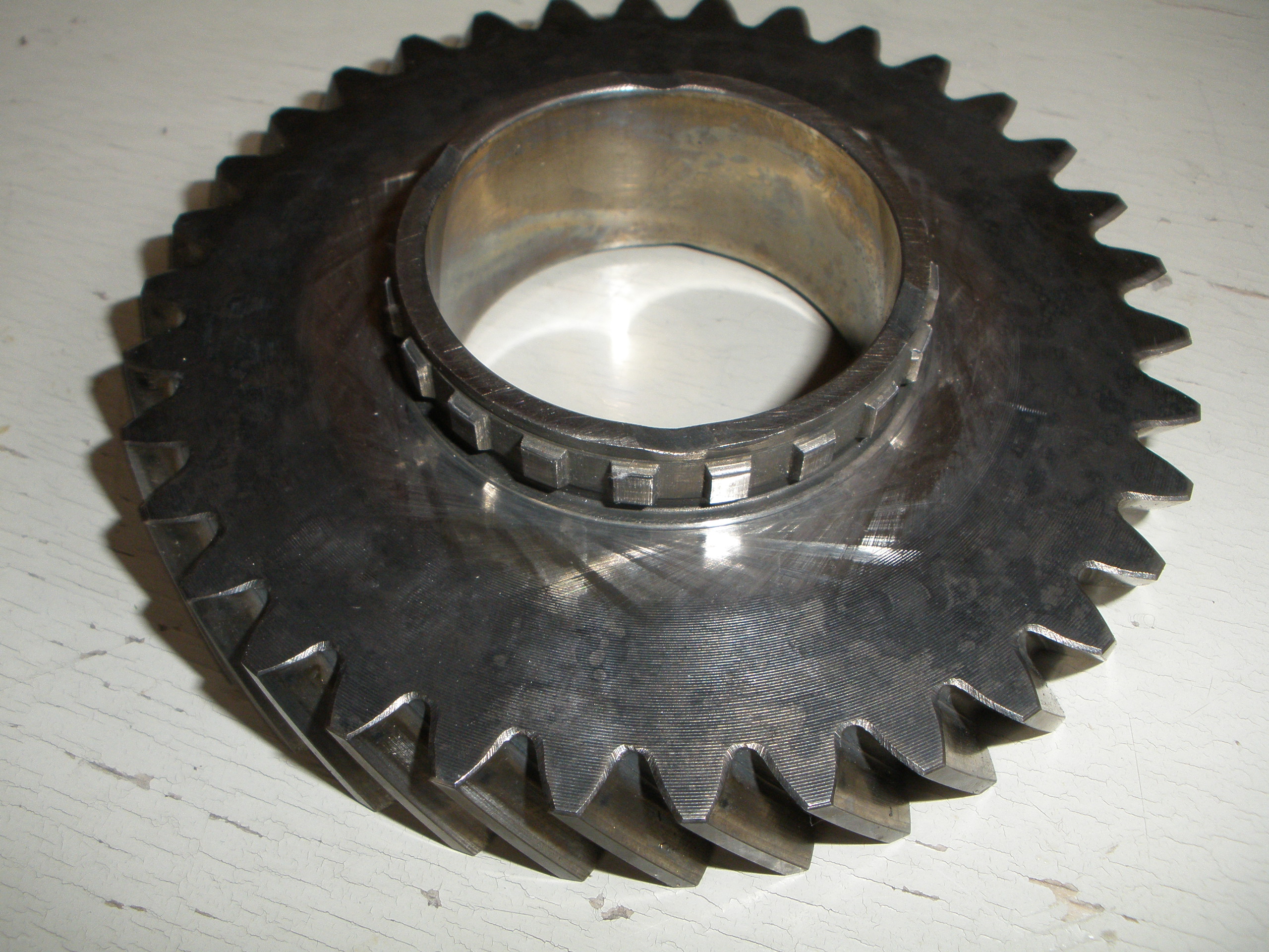

Thanks for answer (IMG:style_emoticons/default/beerchug.gif) , new teeth are expansive can I reuse them from other gears(transmission)? Are the teeth the same in 911 transmissions? Where to get (companies) teeht in US, also used ones? Are the now available ones genuine Porsche ore reproductions?
Do you have a picture of a worn out slider, just to see the differences?
I added additional pictures just to show other 914 friends how it can look like?

no pic of a worn out slider but its the teeth, just like the replaceable dog teeth on other gears that start to round and ground down. the less pointy at top, the worse.

I now know how new teeth should look like, but is there an indication/threshold when they are worn out. Is there any measurement method for indication ore just experience.
Let's talk a lite bit about the function of the teeth. As far as I know the slider shoult only slide ove the syncro ring if the rotating speed of the cogs are the same. Are the teeth edgy the shift will be easy are the worn(rounded,flat) the shift will snag. So the importent part is always the syncro ring also if the teeths are a litte bit flat..ore? So the grinding noise
is forced by worn syncro rings and will lead to flat teeth.

You can reuse teeth from other gears as long as you use all the internal parts with it (all the bands and blocks). I sell good used parts at a deep discount from new with no loss in longevity or function. You can also try Mittlemotor in Germany for new parts since you are over that way.
As for your question about the teeth points on the slider, the teeth need to be pointed so that they allow for the interlocking of the slider and the dog teeth on the gear. The synchroband works as both a friction devise that speeds up the gear to the shaft speed, and as a lock to hold the slider onto the dog teeth. When your teeth get dull, the slider and dog teeth have difficulty interlocking and this causes the grind you hear. A worn synchro band contributes to this. The reason the teeth need to be pointy is because the points offer less surface area to block the transition of the slider into its engaged position with the dog teeth of the free gear.
The way the 901 type of transmission is designed, the parts tend to wear in this fashion:
Synchro band -->dog teeth --> slider
If one addresses the problem early, then they have less to fix. Also, the cost of the parts goes up significantly as the problem progresses and other parts wear:
Synchro band (about $175) --> dog teeth (about $175) --> Slider (from $220 to $500)

As for wear limit, I do not know of an indicator. The manual would just have you change anything worn. I use my experience to dictate when something is used up. My threshold is 70%. If I do not feel confident that the part has 70% or better life left, it is considered garbage.

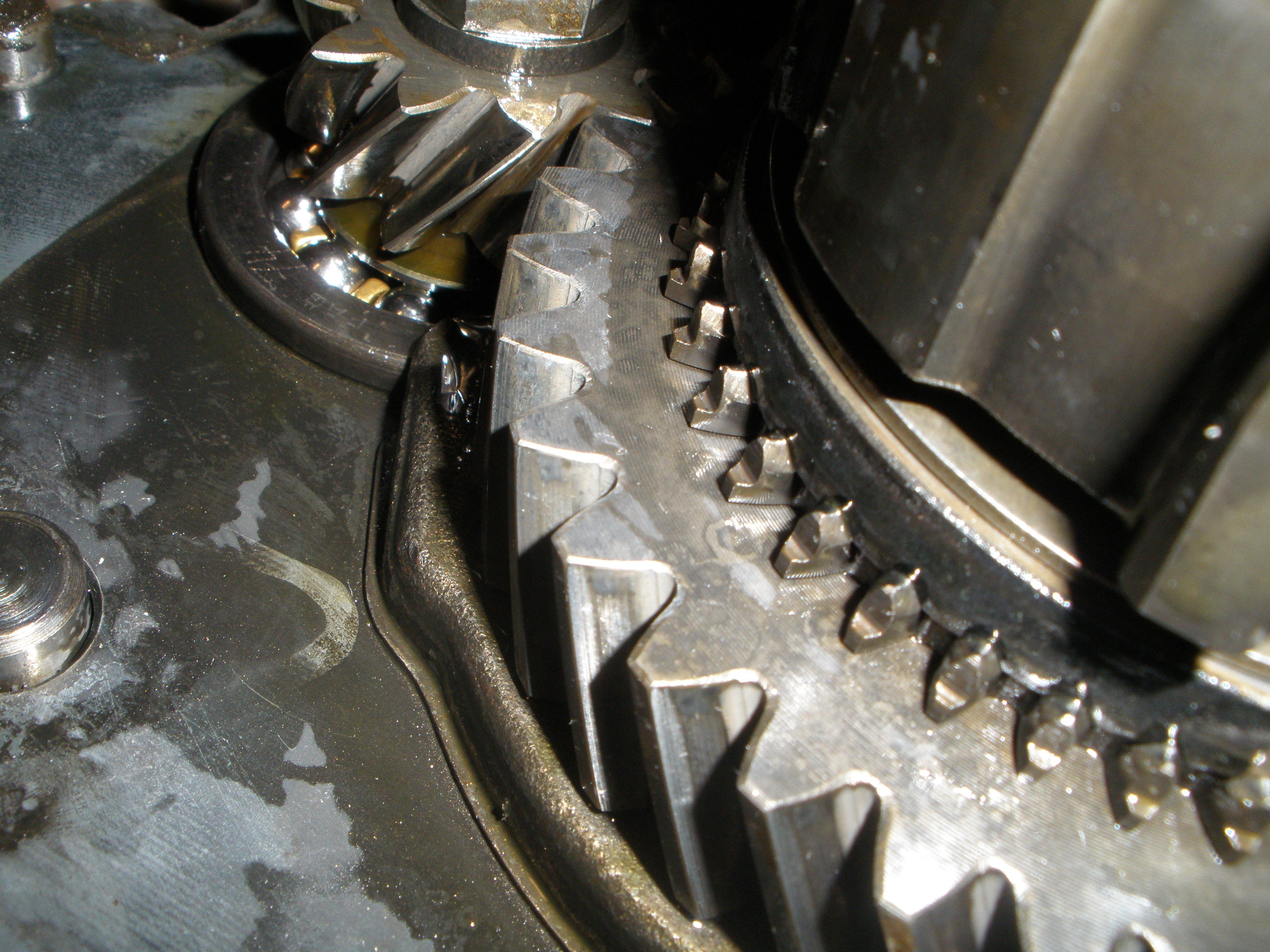

I continued my transmission rebuild and have additional questions. First I like to show bad news. I think the root cause is cavitation caused by ??.
The number for the ring gear and pinion shaft is the same. The roller bearing outer part can be rotated in the case.. ist this normal.. the manual says different.
Is there a need to solve this and If how?
I also have now the problem to get a used ring gear and pinion shaft.
The clearances must be adjusted again, I do not have the tools. Are there different approaches to do this without these tools?

That is toast. The race in the case should not move.
I have good used ring and pinion. If you can not get someone local to you to adjust the ring and pinion, you can use the method that other makers use in that they apply dye to the ring and check where the pinion contacts and adjust from there. I had a guy in New Zealand use this method as he did not have access to the tools or a shop with them. His results were fine, but you may have to do it a few times, I dont know. I always use the tools.

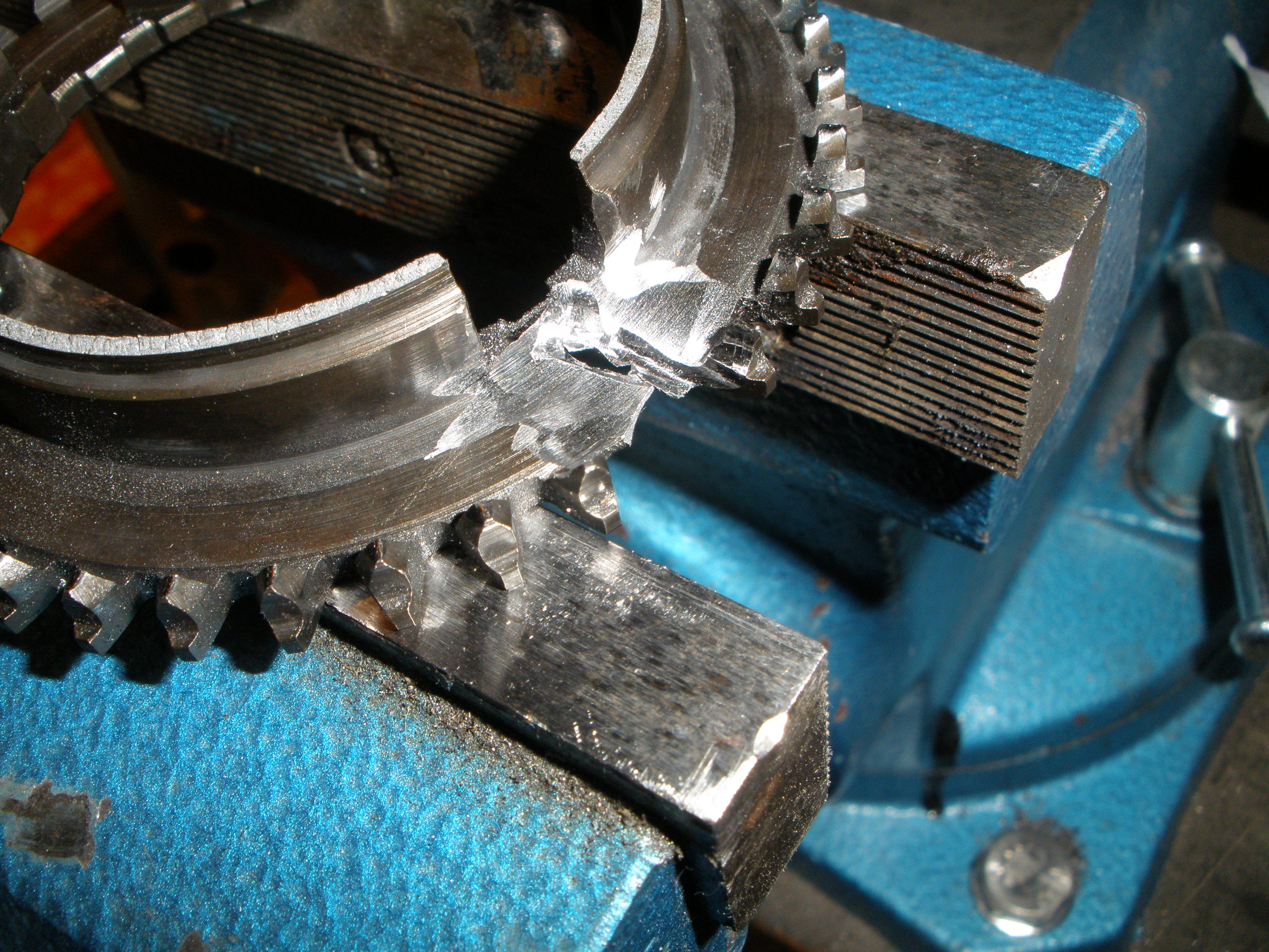

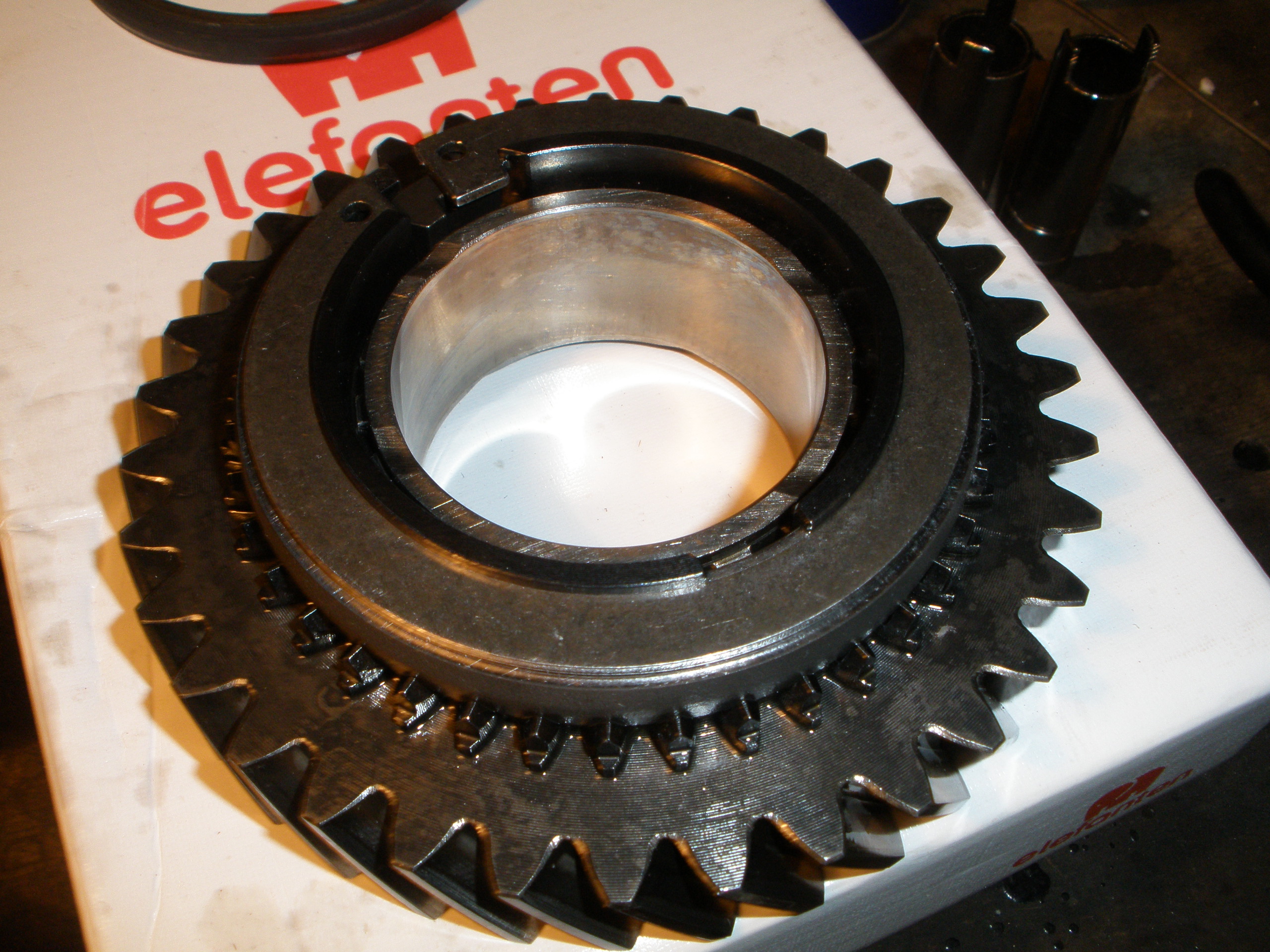

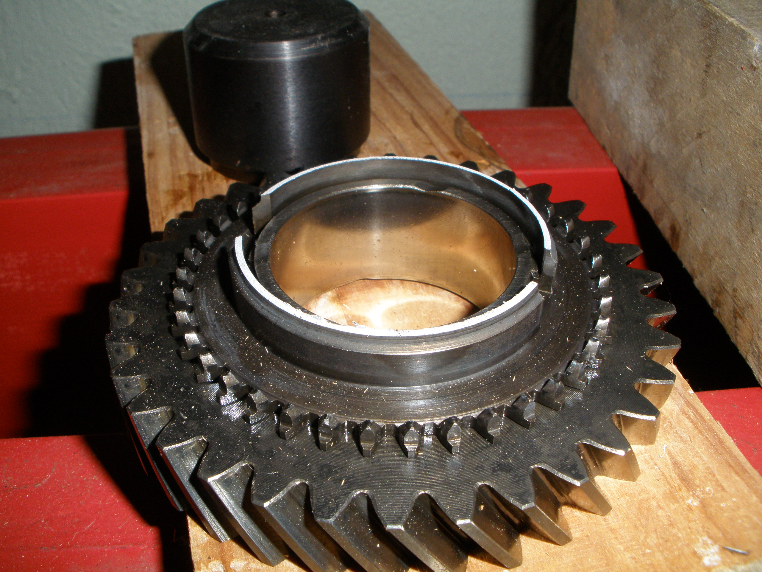

Next step of transmission rebuild, 1st gear dogteeth replacement and new synco ring. I used the special tool to remove the dogteeht ring and a shop press...without success. 4 up to 5 ton a big bang and a brocken ring
I got them off with a dremel whitout any grinding of the gear.

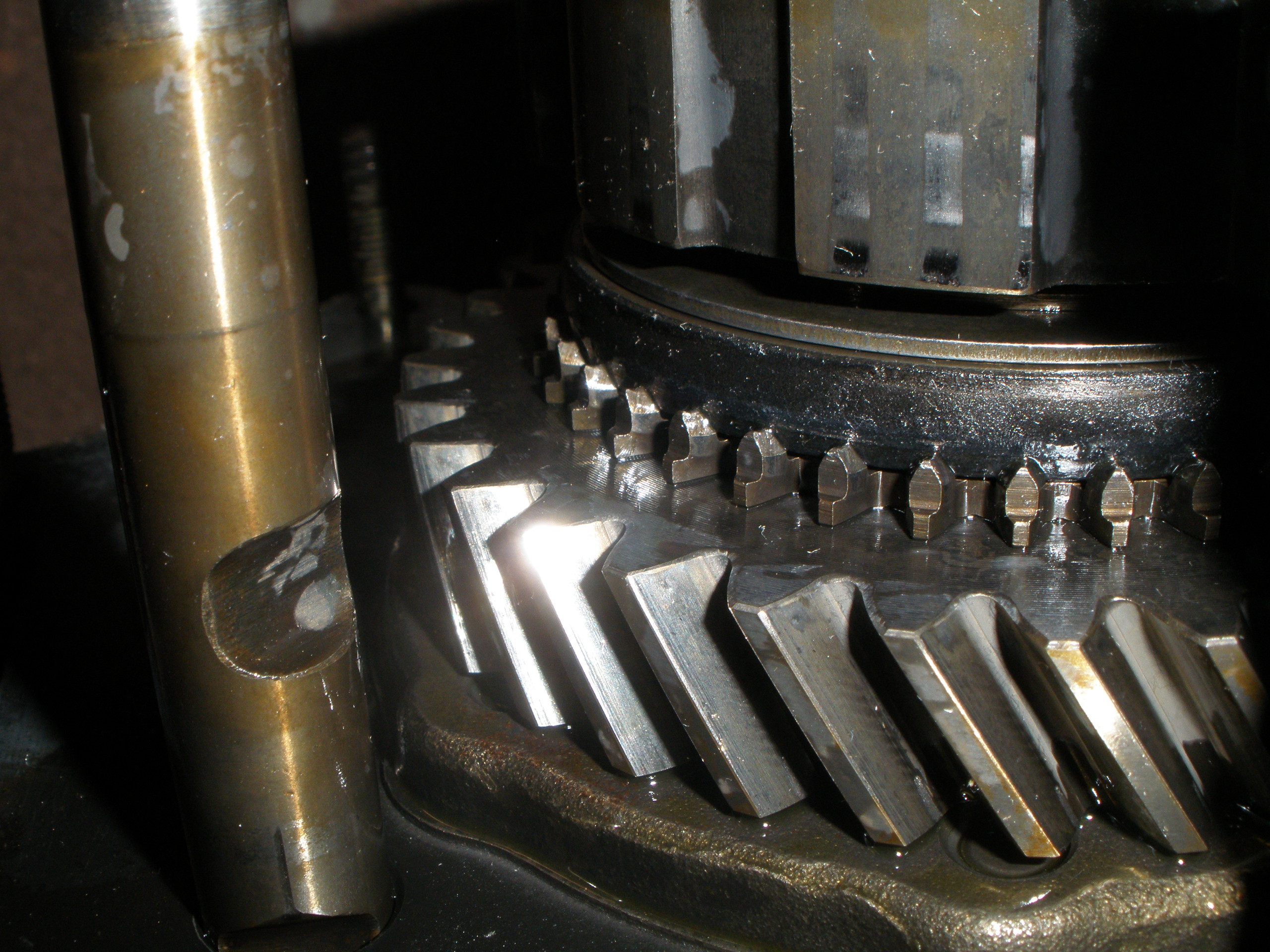

Next step installation of new dogteeht.
