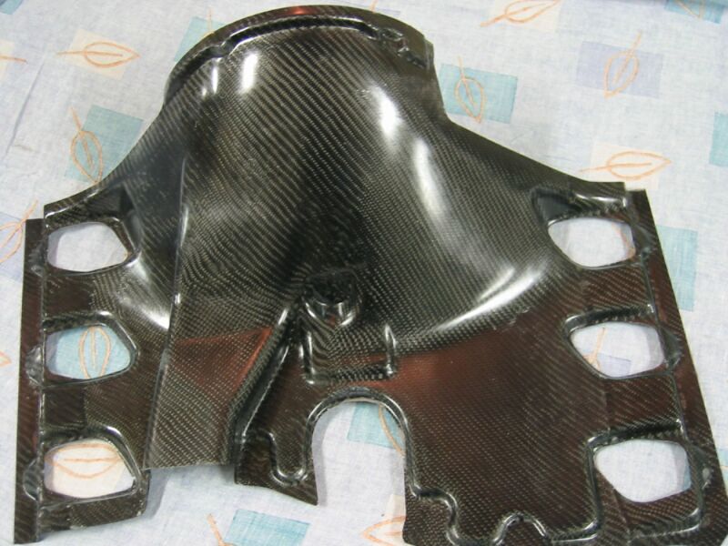

I appreciate all your wisdom. I have a collection of carbon fiber parts that a bug guy has made. Some of the pieces could fit on a type-4 motor. Check it out on my website.
http://www.britainsmith.com/Porsche/index.htm -Britain |

Wasn't this guy on the Pelican BBS about 9 months ago
He had the valve covers and the K&N filterhousings for the /4 He was planning to also do filterhousings and rainguards for the /6 He suddenly disapeared and was never heard from again... You can call it rice, but try and get a "plain" fiberglas piece to look that good (stop trying, you can't (IMG:style_emoticons/default/biggrin.gif)) cheers, Jeroen |
