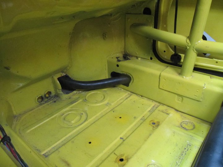

I'm going to steal one of Britain's pic here. This seems like the best way to go, but I'll have the full interior back in, which may look funny. I need to ask him, but it looks like he cut the tube out from the top and just put a patch. How long is the little heater tube on the front? It seems that I've seen a pic with the long cutaway and the tube is a short 90 degree section.
(IMG:http://www.914world.com/bbs2/uploads_offsite/sphotos.ak.fbcdn.net-7611-1332693033.1.jpg)

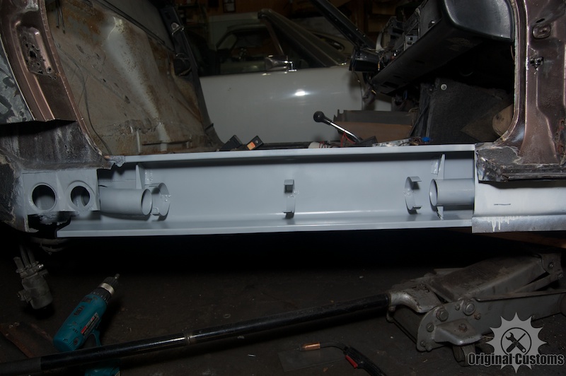

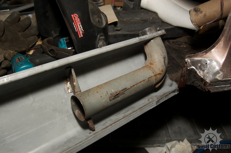

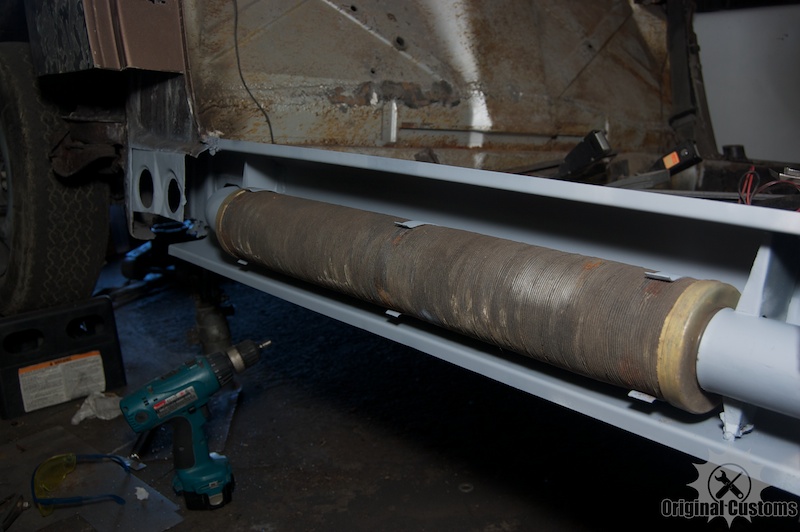

Here is what's inside.
Mike Bellis

QUOTE(McMark @ Mar 25 2012, 01:06 PM) *
Thanks Mark! Exactly the pics I was hoping for, but not what I was hoping to see. It looks like significant surgery to get that stuff out. Maybe a cooling lines phase two project for next winter.

Brit followed the same path as set up for oil cooler line routing.....just singled up the lines....one to each side. No need to be cute. A hole saw thru the inner long AND the inner tube(it's a little brutal). Oblong the hole or dress as necessary with a die grinder. A split gas hose around the cut outs for those sharp edges. The intrusion is minimal.
IIRC the drivers side is tougher but email him for a pic. He does face book & there might be a pic there.
