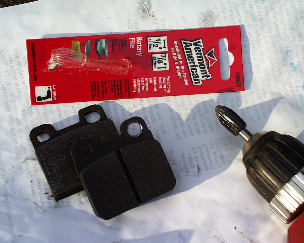

I don't remember seeing any pads with different-sized holes in years. I just used a drill on the one hole to enlarge it to fit the retaining pin. Been long enough that I don't remember the drill size, though.

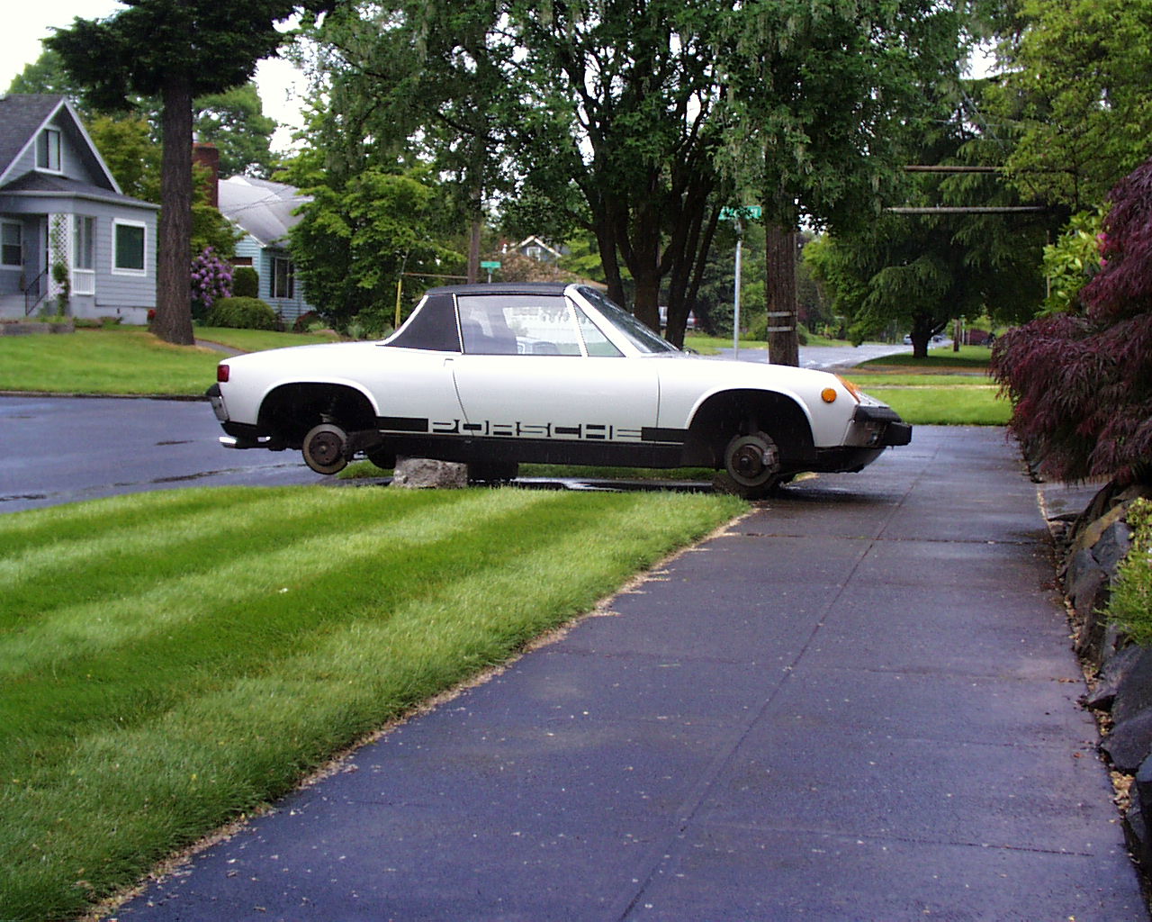

Now that the car is on blocks from last weekends tire slashing, I have easy access to finish the rear brake job. I know it looks super ghetto, but my Alfa is sitting on my jack stands in the garage. Had these concrete chunks left over from busting up a patio in the back. Leaving the new tires off for the long 4 day Memorial weekend in case the jerk offs come back again. Got the rotor screw free with a torch and impact hammer screwdriver. Removed the rotor and caliper without breaking the hydraulic line this time. Decided to hog out one hole bigger on each Porterfield R4-S pad with a rotary file I picked up at Ace Hardware. Found a 5/16 hex wrench that was long enough to adjust the rear pad clearance through the trailing arm hole. While reading through my Pelican Parts instructions I had the a-ha moment that you leave the metal retaining clip off so you can get the feeler gauge straight in where the pads go. After you set the clearance you pull the pins back out and put the cross clip back in there. With the dust shield, there is no way you can set the clearance and the dust shield bolt head are under the rotor which you cannot get to once assembled.

Rotary File I used on Porterfield R4-S pads.

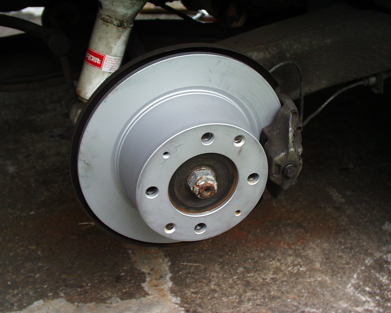

The adjustment on the handbrake was WAY off on the right side. I had to loosen the clip that holds the cable housing to the bottom of the car in order to adjust the cables properly. Someone that worked on this car prior to me didn't understand what was going on. The left side pads and the right outer pad all looked about the same. With the hand brake off, the inner right pad was still being forced against the disc causing it to wear down to the backing plate.
New Zimmerman rotor and Porterfield R4-S pads installed.
