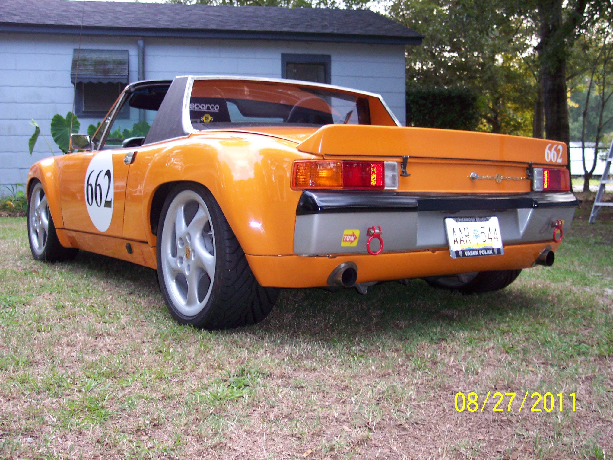

I made my switch from fiberglass to steel flares on my car back in 2007.
What I noticed about the flares after the initial install, was that I don't think the ends really weren't designed to match anything in particular.
I to wanted all the edges to line up cleanly after all was painted and all the rockers & valances were bolted down for the final time.
In the case of the rockers. After I finished welding the flares on, I cut the ends of the flares off and made sheet metal templates hat matched the existing shape of the rocker flare as it was bolted to the chassis.
Then I tacked the patterns to the bottom of the flares. Then proceeded to section the flares out to meet the edges of the patterns. Then weld up the gaps, and grind down the welds. Put the rockers and valances back on to check the line up. Remove and continue to repeat until you get the right look. That is do everything before any priming or painting. Keep repeating the on and off of the valances and rockers until the factory look is achieved. Also, after all was done, I also drilled and bolted the rocker ends to he flare ends, gapping the parts with faucet washers for an even gap.
I found it was easier to form the metal to mimic the rockers because with the metal it was cut, notch, weld, check fit. Immediate results. Unlike with fiber glass, it was notching, mixing resin, pasting the glass. and waiting for everything to harden to be able to check fit.
In the end, I did have a little of both forming the metal and forming the glass part. But it was heavier towards the metal work.
check the pics, and zoom up on the edge work. 5 years on it still looks good.
Ron

Yes, that's a very nice car Ron.
Nice work.
I did see someone section out the bottoms of the flares, maybe it was you.
It's still not too late for me to do the same, I like the look.
Are your rockers Getty Design? My thinking was, if they all fit like (IMG:style_emoticons/default/stromberg.gif) just get the cheap ones and make them work.
I am sure it helps with a good rocker to start with.

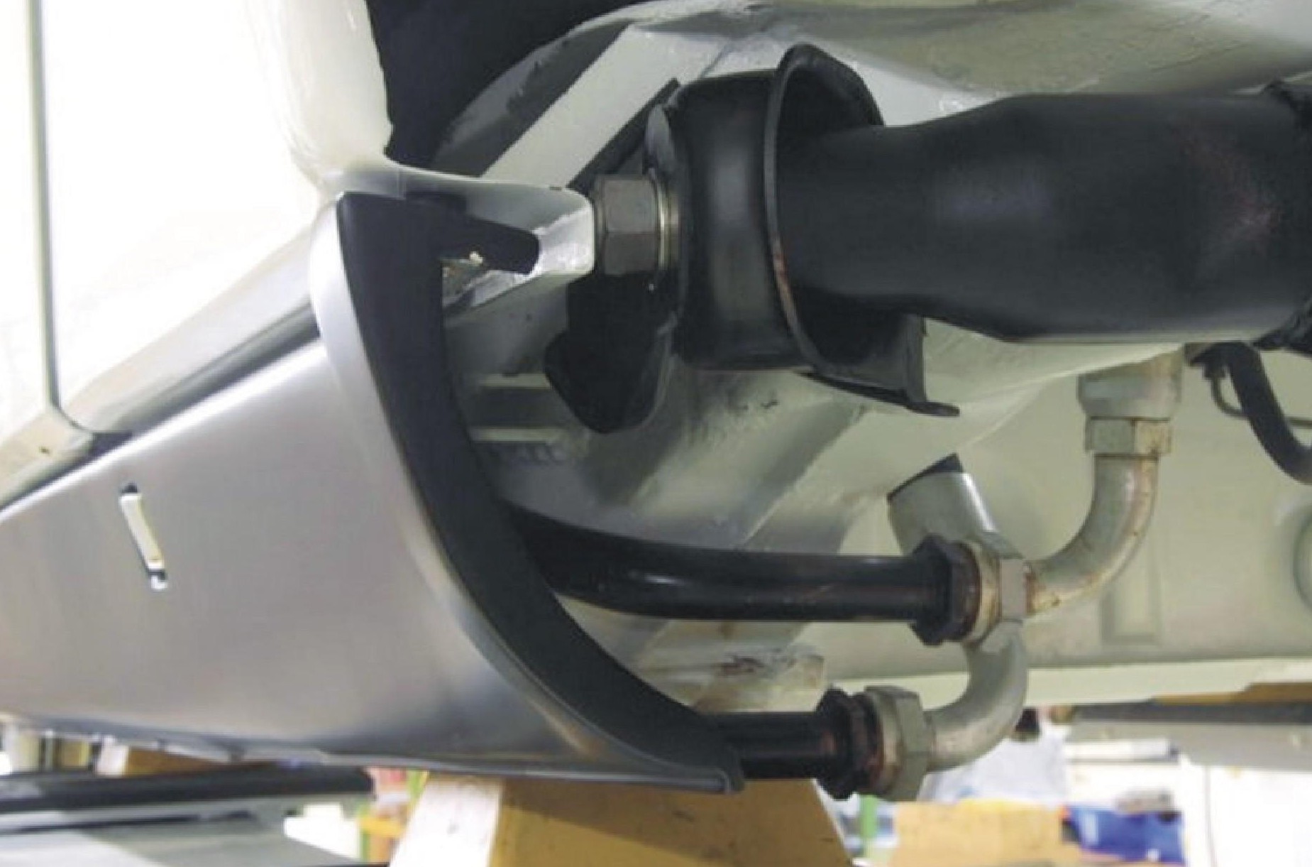

Here is another photo of what I am up against. Ron, It looks like you did a lot of nice work to your lower flares to remove the bevel at the yellow lines.
Seems this is they way the flares should have been stamped.
It also looks like you did some work to give the flares a constant radius at the bottom. Where my AA flares have a ramp (red line in the photo) before the radius into the flare.
Before seeing yours, I was thinking of building up the rocker to fill between the yellow lines, keeping a constant gap and or trimming it at the green line.
Is this much rework a common practice on the flares?
Any other approaches out there?

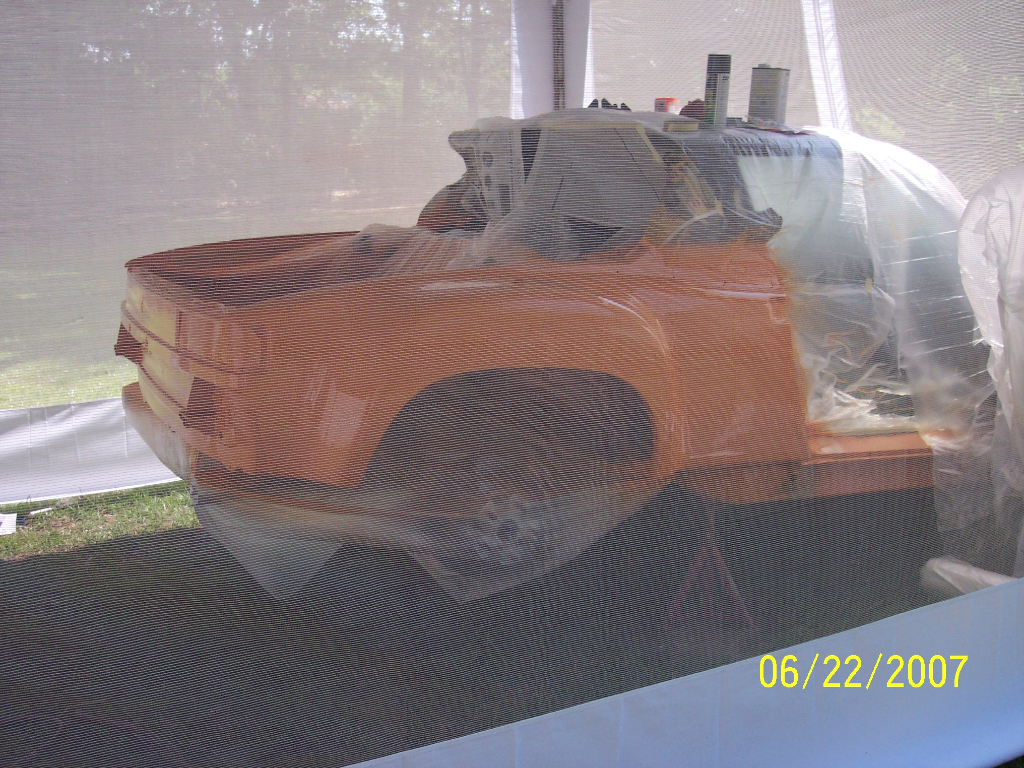

Props to a great backyard paint job! Thats how I do mine! No reason why they can't look great if you do it on the right day. Beautiful car. (IMG:style_emoticons/default/pray.gif)
