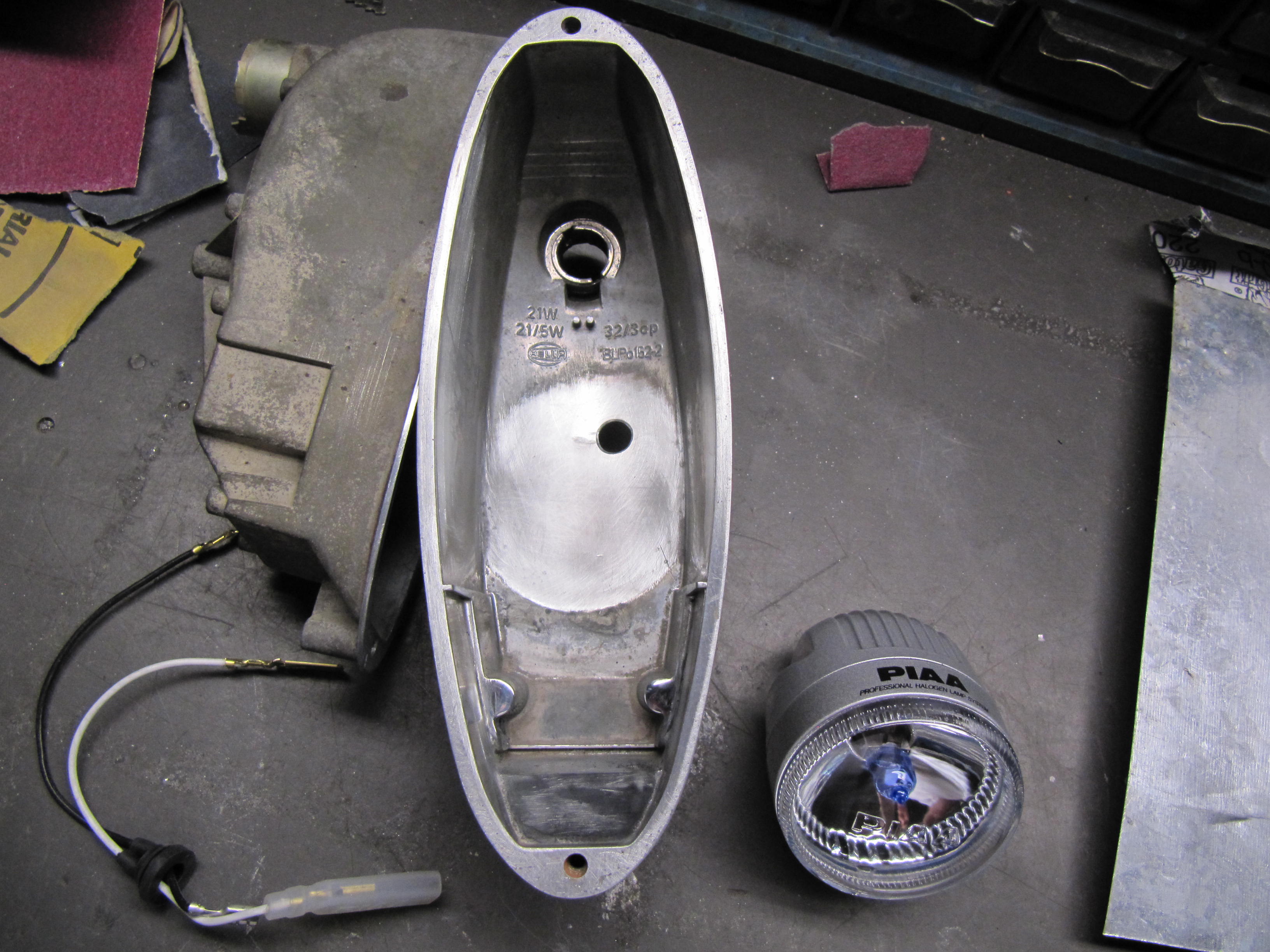

I got my light and trimmed the plastic housing on my belt sander. I also took off the mounting brackets.

Where's the pic of the light IN the turn bucket?

I ground off 6 protrusions (they look like tits on new tires but of course they were metal) on the inside of the turn bucket so their was more room. Otherwise these lights fit snug in the turn buckets with no other grinding! I drilled a hole in the back of the buckets the same od as the hole in the back of the new lights. I am reusing the rubber grommet that I took off the new lights.
