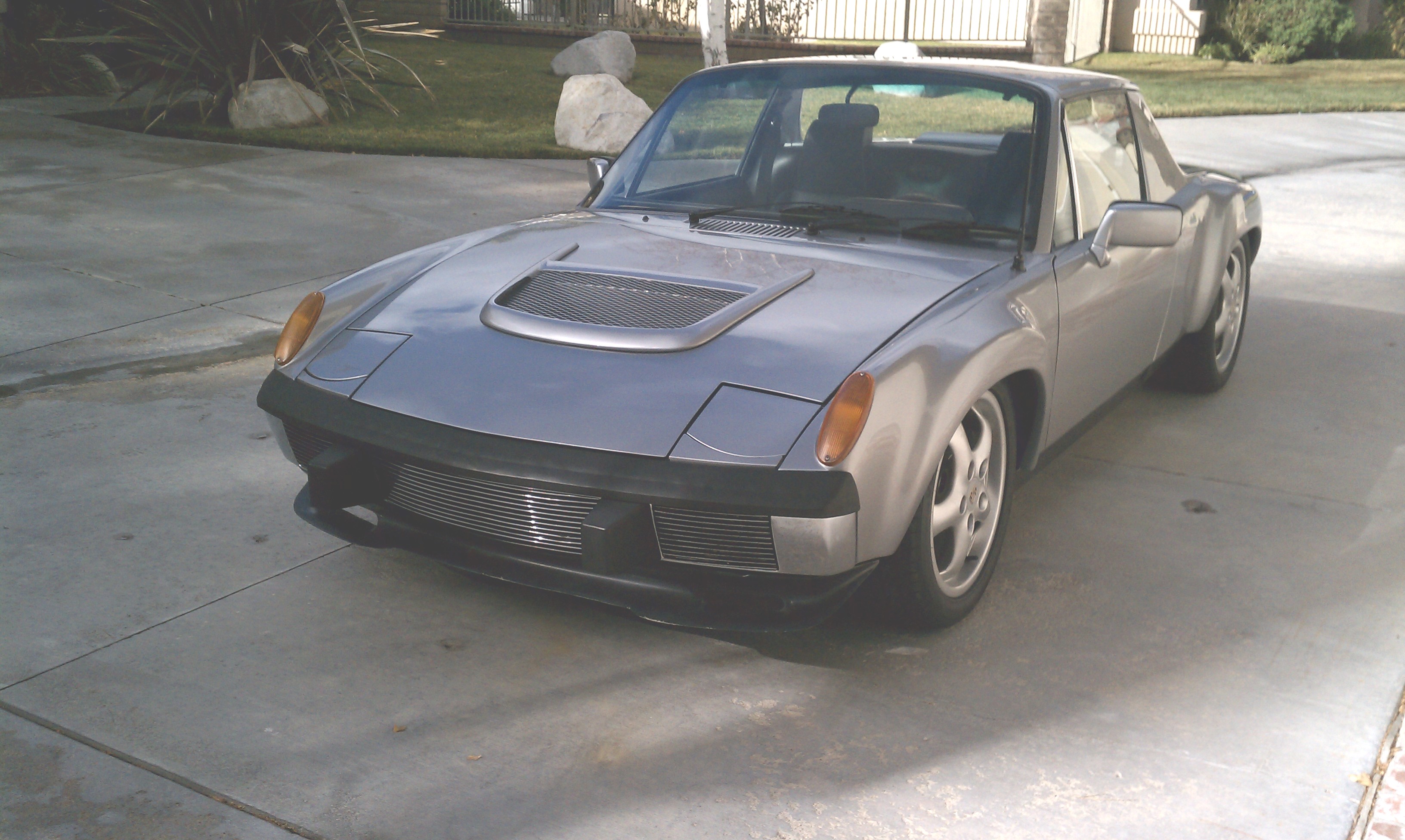

Here's the start of a retrospective build thread of my LS1 conversion. It took a few years to get it done mostly due to not wanting to be a slave to the project, and work on it for the enjoyment; and of course when family obligations allowed......teen daughter and high maintenance wife (IMG:style_emoticons/default/biggrin.gif)
What I started with was a local orignal owner '75 2.0 with 139K miles. The original owner "drove the heck out of it" until something died in the electrical system and he parked it in the garage for 14 years, as evidenced by the renewal tags. Only body damage was when he submarined the rear of a Mustang and creased the hood and flattened the left signal light pod. Otherwise, it was a good condition rust free (SoCal) car.
Brief specs are: '01 LS1 Z28 motor, Audi 01E 6 speed tranaxle, 911 front suspension, custom made rear trailing arms, Koni shocks, 993 wheels, and AC.
Below, are photos of what I started with, and what I ended-up with. I'll do my best to re-trace the build process, so if you have any questions along the way, please ask.

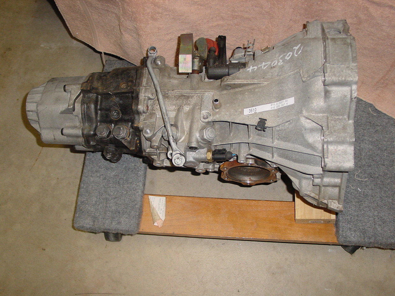

I decided quite quickly, that I wanted to go with a modern V8 motor with all the EFI controls, so I went with an all aluminum LS1. Before acquiring the motor, I went through the somewhat difficult process of selecting the kind of transaxle that would be rugged enough, reasonable in cost, decent gearing, all in a modern package. I really liked what the Audi 01E transaxle offered, but there were two problems. 1.) The FWD version was never available in the US, and 2.) no one made an adapter plate (at the time) to mate to a LS1. Being the engineering type with a background in managing prototype machining, I could make the adapter plate myself. So now I'm relegated to find said 01E. My search took me to Europe, and after a number of inquiries, I found a low mileage (12K kilometer) 01E from an '02 Passat TDI, which has the more desireable gearing of the 01E series. After a few phone calls and arranging a freight forwarder, it arrives at my door in exactly one week! Price? $1100 landed, though this was some years ago when the exchange rate was way more favorable than it is today. Needless to say, I got a killer deal that's likely to never be duplicated again.

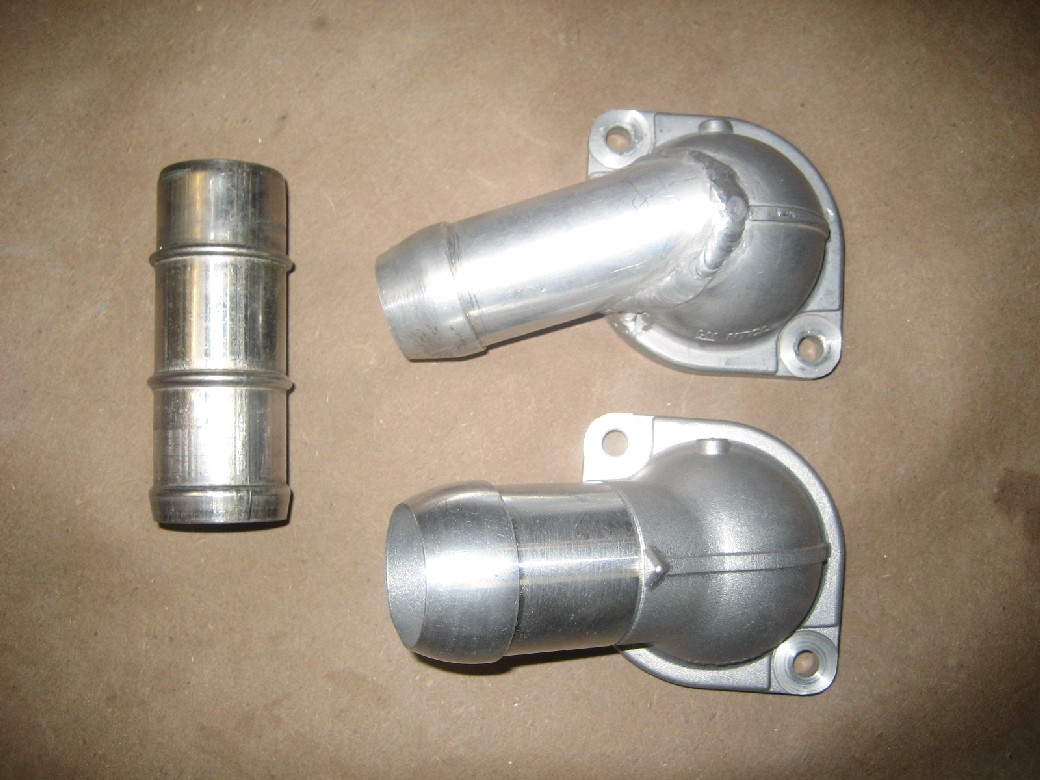

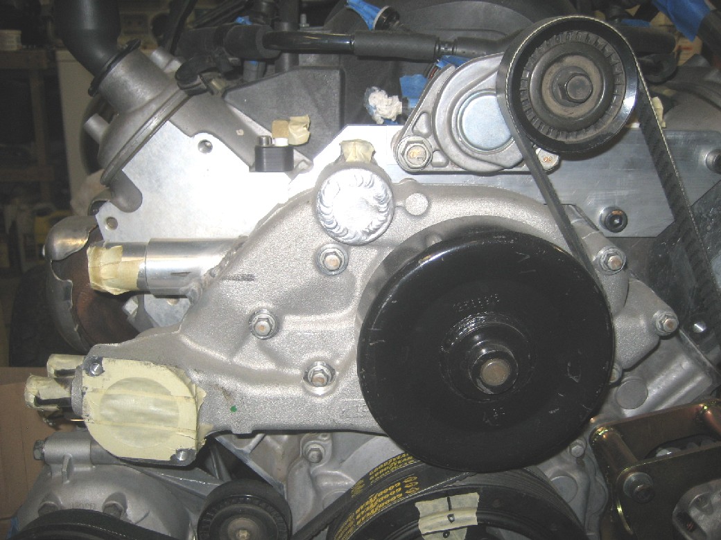

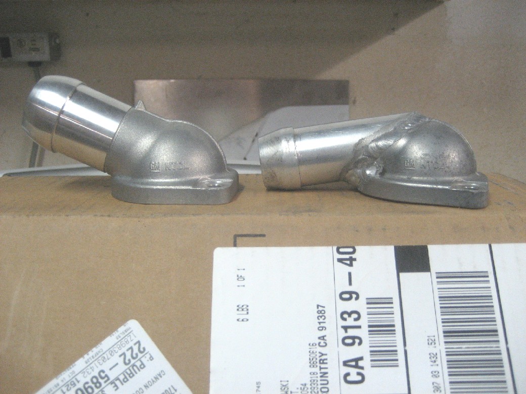

With the motor and transaxle coupled together, I now set about the task of fitting it to the car.
Initial fittng revealed that the motor damned near fits with the water pump in place, which means it still doesn't fit. After some measuring, I determined that if I use the LS2 water pump with the short pulley, I'll reduce the length by about 2" (from memory, which is not that great anymore). Found a brand new LS2 water pump on Ebay along with a LS6 Vette crank pulley (which is also shorted than the LS1 by some 3/4") to line up with the water pump. Fitting again revealed that I would only need to move the firewall hump into the cabin 1 1/8" to get everything to clear......well almost. The water pump outlet points straight forward into the firewall, so I needed to re-think that. Some of you may think why should I goof with the stock water pump, when a remote mechanical or electric water pump (Meziere) might offer an easier solution? Well, frankly I like stock components over aftermarket as they are properly engineered and designed for dependability. Another issue that led to my decision, was the need for a properly configured thermostat, and heater hose and valving. To resolve the water pump outlet, I capped the original outlet, drilled a hole pointing toward the passenger side, machined a new neck with barb for a 1 1/4" hose, and TIG welded it in place. I did a similar thing with the inlet side; I machined a neck with barb, and TIG welded it to the stock thermostat housing in a more favorable position.

While not exactly in the correct sequence of the build, I will probably group things so as to keep some sense to the project. While waiting for one thing, I would switch over to say the flare installation or chassis stiffening in between, but anyone that's done this kind of thing before, knows what I'm talking about.
Let's proceed to the accessoy drive on the front of the motor. The water pump pulley and the crank pulley are in alignment, but the AC part of the crank pulley is now about 1" closer to the block than the LS1 AC compressor pulley, so I had to fab a plate that moves it back,,,,,but not so fast. The compressor now interfers with the header (stock cast iron LS6 header), so I remake the plate to also moving the compressor down by 3/4"....but now the compressor interfers with the cool looking Vette aluminum motor mounts I got from Ebay. After some thought, I decide to fab my own motor mounts. Ok, back to the accessory drive. The alternator (in it's stock position) needs to move closer to the block as well, so I found it easier to fab my own alternator mount; done deal. Now, the serpentine drive needs to be configured. What I came up with was to mount the tensioner high and somewhat centered, which coincidentally turns out to be the same solution that Factory Five uses on their GTM cars (their bracket is steel, mine is aluminum). I measured the necessary belt length with a string, then searched the Goodyear site and found what I needed.
Not as many photos as I'd like to display, but that's all I have. The zinc plated part is the alternator front mount (there's also a rear mount).
