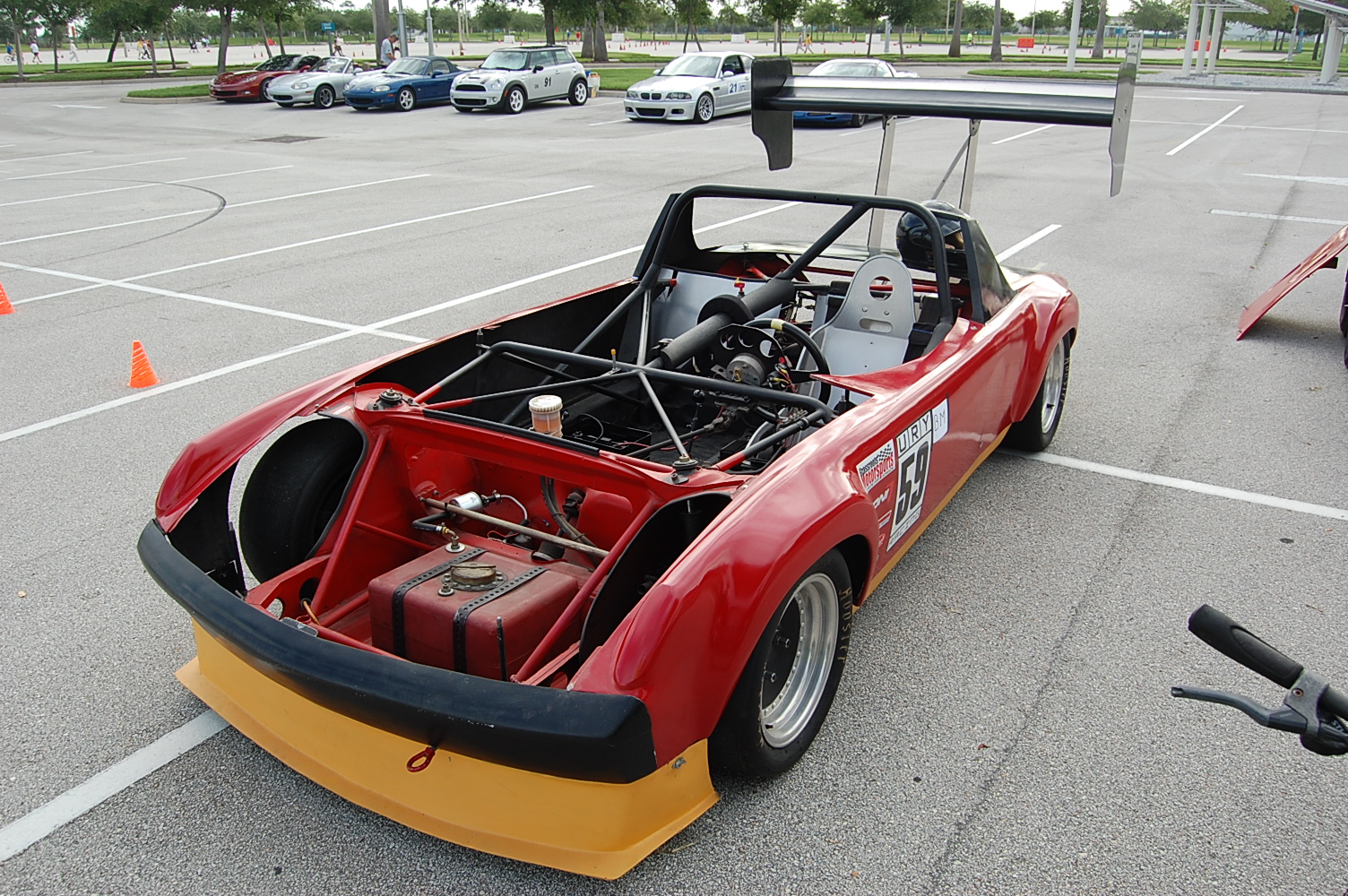

I'm not sure what kind of car you're trying to ultimately end up with but I know what I my goals were. This is or could be pertinent to what you are doing. Its a fine line, when building a modified 914 (or any car), between maintaining the integrity of the original car or basically building a race car/tube frame.
I certainly wanted a floor pan car that was comfortable enough to drive on the street, maintain a virtually stock GT appearance, and finally, have a level of performance to run the tails of a modern Cup car. Difficult to say the least. My wing and splitter come off in a matter of minutes but I like them on...so on they stay.
I like what I see you doing but I just don't know what the end-game is or will be - time will tell.
Here was my finished product - nothing really denoting it is a highly developed 600 hp well mannered car. Allots going on under the skin...
I look forward to seeing your solutions and ideas vetted out...not that I can help you in the least but if I can be helpful, shoot me a PM.
PS: One more thing, at the end of the day, safety is king and takes priority over comfort and aesthetics - it isn't everyone's cup of tea, but suits my palate just fine.
