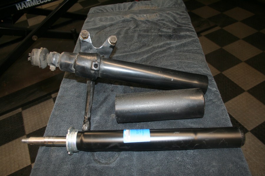

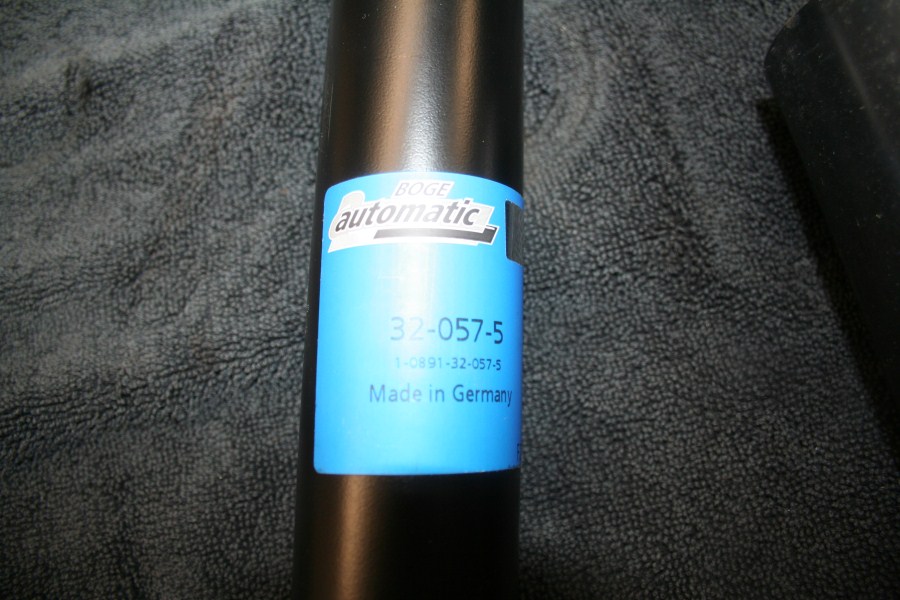

I just removed these shock inserts for my 5 lug conversion. They have 25,000 miles on them and you can have them for whatever UPS wants to ship them. (IMG:style_emoticons/default/biggrin.gif)
