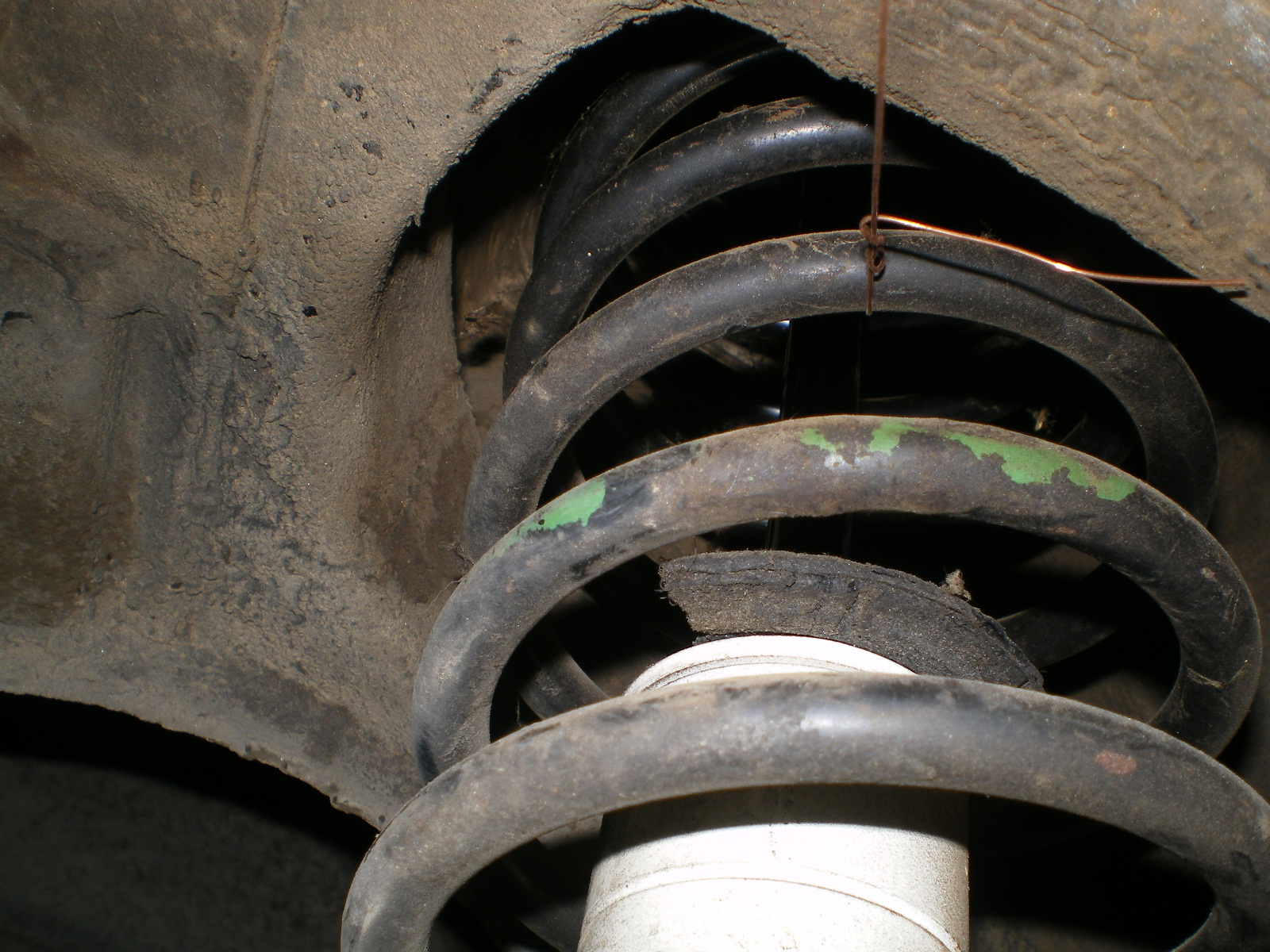

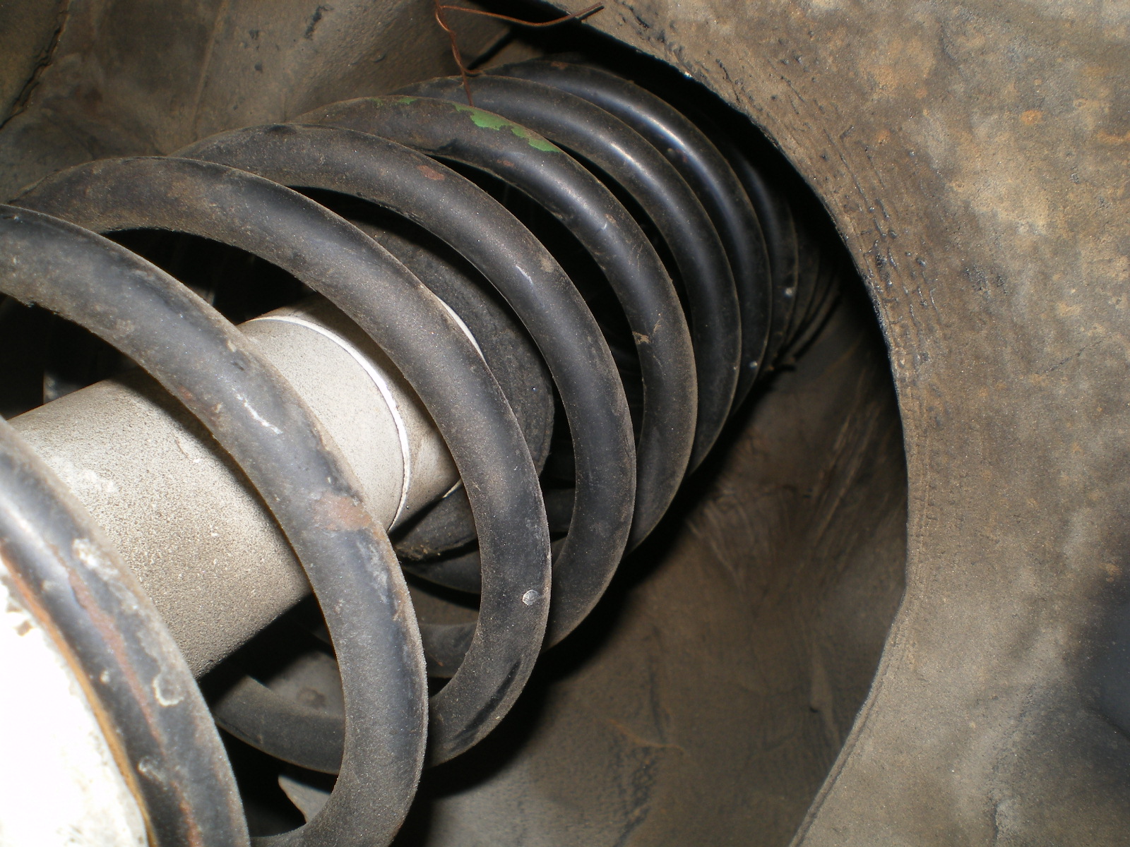

As revealed earlier, I don't know (IMG:style_emoticons/default/stromberg.gif) about suspension. I did know enough to listen to the pros and have taken Eric's set up advice. (guess who has new Bilsteins coming (IMG:style_emoticons/default/biggrin.gif) ) My question is this; how do I identify what I currently have? Is this done by the number of coils? Is it stamped somewhere? Color coded? Here is a shot of mine. And...what does 100,120,140lb represent? What happens at a given value? TIA, kent

If my math is right, I think all the stock springs listed below are around 150 pounds. AFAIK, the three variations are about 14 pounds between the lowest rate mentioned and the highest.

I think your math is wrong, McMark. Specifically, not accounting for the "P at L1 = 239mm". I believe they're talking about a pressure at a given spring length, though it is possible it could be a given amount of reduction in length.
The oldest info we have is that the stock springs are on the order of 60 lbs.
The way we rate springs in the US is in "pounds per inch". That means pounds of force that it takes to compress the spring one inch. Most springs are relatively linear in rate through most of their range, meaning that compressing the spring two inches takes twice as many pounds as compressing it one inch.
Some are "progressive rate" springs, where compressing the spring two inches takes more than twice as much force.
--DD

Hey guys, thx for the quick response but I guess you went over my head because I still don't know what I've got or what was said. I did find this but doesn't mention the 914. http://forums.rennlist.com/rennforums/924-...color-code.html Maybe someone could tell me who sells 140# replacement springs or how to test existing springs to determine which I have.

The rate is "pounds of force per inch of deflection". That suggests how you would test it:
Weights to put on the end of the spring, and a ruler to measure how far it compresses. Take measurements with different amounts of weight.
lbs of weight / inches of compression == lb/in spring rate.
...Or you take them to a shop that has a spring tester, which does the same sort of thing with much more precision.
--DD
Yup. I was wrong. Found a spring rate calculator that takes into account wire size, number of coils, etc. And came up around 80 pounds. Of course, that's just rough numbers and for new springs. I don't have any idea of the rate of decay on spring rates. But between 60-80 pounds for stock springs may be about right.

QUOTE(Dave_Darling @ Mar 25 2013, 01:27 PM) *
Measure spring length at rest. Put a known weight on top of the spring. Measure difference in length.
Plug the known weight (in lbs) and the difference in length (in inch) into the formula above, normalize to 1 inch and voila!

I plan on doing just that after I drop the trailing arms. Then I'd like to follow up with a spring test by a pro to verify what I think I already know.

Dont mean to hijack but could someone comment on the meaning of the various color paint dabs used on the OE springs ?
I know that I've read that yellow was for 914 6 specific springs. True ? if so what does red or green indicate ?
