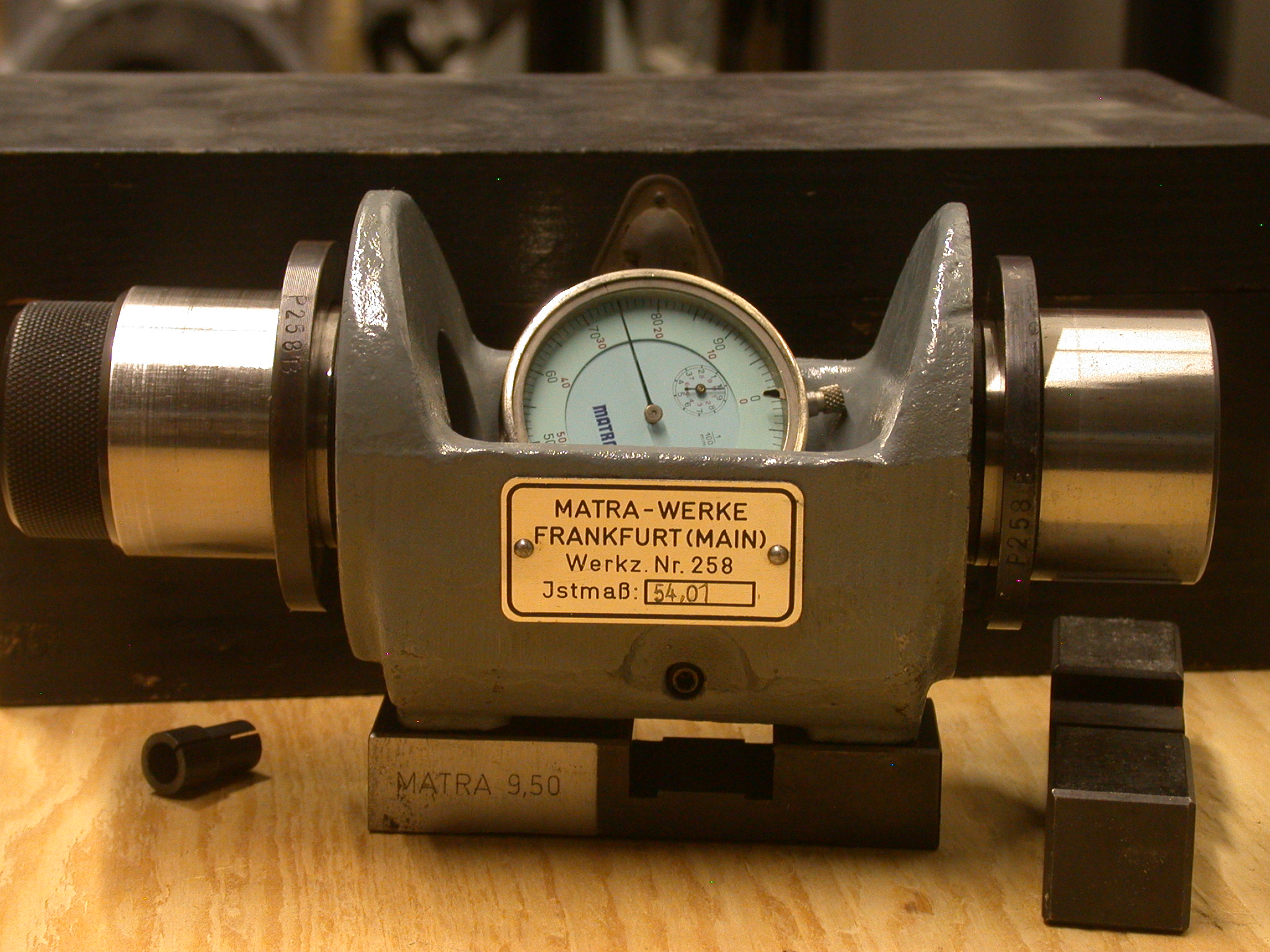

QUOTE(Dr Evil @ Apr 16 2013, 10:58 AM) *
I use the factory tool, or at least a clone of it.
Photo below of factory tool, P258, with all accessories.
This tool will only measure pinion depth; other tools are needed to determine ring gear backlash and differential bearing preloads.
I'm curious to see the clones being made.
Jon B.
Vista, CA

Dr Evil
post Oct 8 2013, 10:34 AM
Send me your transmission!
Posts: 23,044
Joined: 21-November 03
From: Loveland, OH 45140
Member No.: 1,372
QUOTE(Jon B @ Oct 8 2013, 12:49 AM) *
Jon B.
Vista, CA
Mine was made by a machinist and has the same dimensions as the factory tool. I only have to use it when replacing R/P for failure of inspection or traumatic failure. Most of the time, and I have covered this extensively here and in my DVD, I instruct people to measure gaskets and maintain factory set specs. The vib issues is not much of a concern in the small increments we deal with. It is mainly a nuisance. Many other manufacturers do not do the finite test in leu of just matching patters with dykem or other indicator to a visual pattern.
In a race box, though, I would keep as much friction and vibe out of your setup as fatigue will be highly magnified. Bearings wear and tolerances are quickly lost.
