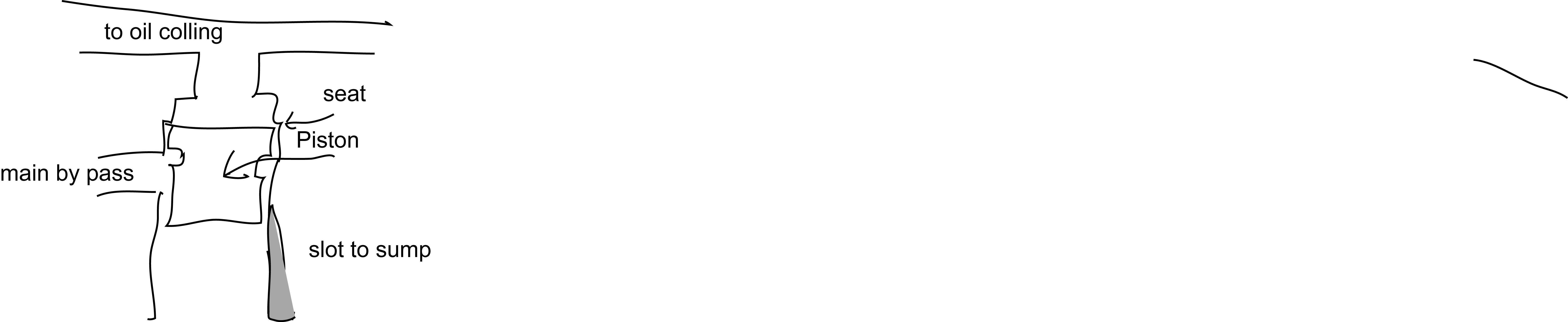

Here is a drawing about what it looks like. Sorry I am playing with a tablet pen.

Keep in mind this is just a guess...
The oil pressure relief system includes a spring and a piston.
The PET lsits 2 springs and 2 pistons by part number.
Could you have the wrong spring or piston for your engine block?
Maybe the spring is just fatigued from 40 years and opens too easily letting your pressure bleed off?
