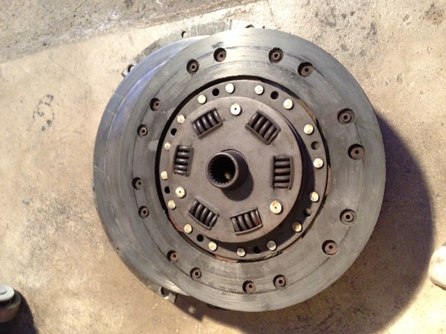

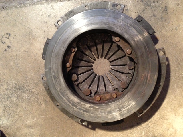

Pressure plate appeared normal when installed however I did notice that the three impressed dots on the pressure plate and flywheel did not match up.
When I removed the pressure plate, I could easily see black streaks all the way around the pressure plate surface and the clutch disk was black (this one was brown when installed a few weeks ago.
The flywheel side of things looked normal. Pilot bearing in place. A bolts on properly.
My clutch was slipping under high load when first installed. I drove it this way for about 20 miles. I then adjusted the clutch which seemed to resolve the issue- however the chattering started then.
Am I correct in assuming the black streaks are probably from a burnt clutch disk/pressure plate? AM I correct in assuming that this would cause the chattering? Am I also correct that I will need to replace these?
Pictures to follow!!!

tornik550
post May 18 2013, 07:32 PM
Posts: 1,248
Joined: 29-January 07
From: Ohio
Member No.: 7,486
No oil leaks from the tranny. No oil in the bell housing. I must have gotten oil on it when I installed the clutch disk.
tornik550
post May 18 2013, 07:33 PM
Posts: 1,248
From: Ohio
Member No.: 7,486
tornik550
post May 18 2013, 07:35 PM
Posts: 1,248
From: Ohio
Member No.: 7,486
So I am obviously buying a new clutch disk.
How can I tell if the pressure plate is salvageable?
r_towle
post May 18 2013, 07:38 PM
Custom Member
Posts: 24,705
Joined: 9-January 03
From: Taxachusetts
Member No.: 124
Personal choice....can you clean it with brake Kleen?
Is it flat?
I would just do both and drive the car with a smile knowing you won't need to go back in there for a while.
Rich
tornik550
post May 18 2013, 07:47 PM
Posts: 1,248
From: Ohio
Member No.: 7,486
I decided to just buy them both. I would feel much better knowing that everything was the way it was supposed to be.
messix
post May 18 2013, 08:26 PM
AKA "CLUTCH KILLER"!
Posts: 6,995
Joined: 14-April 05
From: between shit kickers and pinky lifters/ puget sound wa.north of Seattle south of Canada
Member No.: 3,931
its hard to see from the picture quality but does it look like the pp was only working on the outer edge of the disk?
it doesn't look like there is any wear on the inner 2/3 of the disk.
