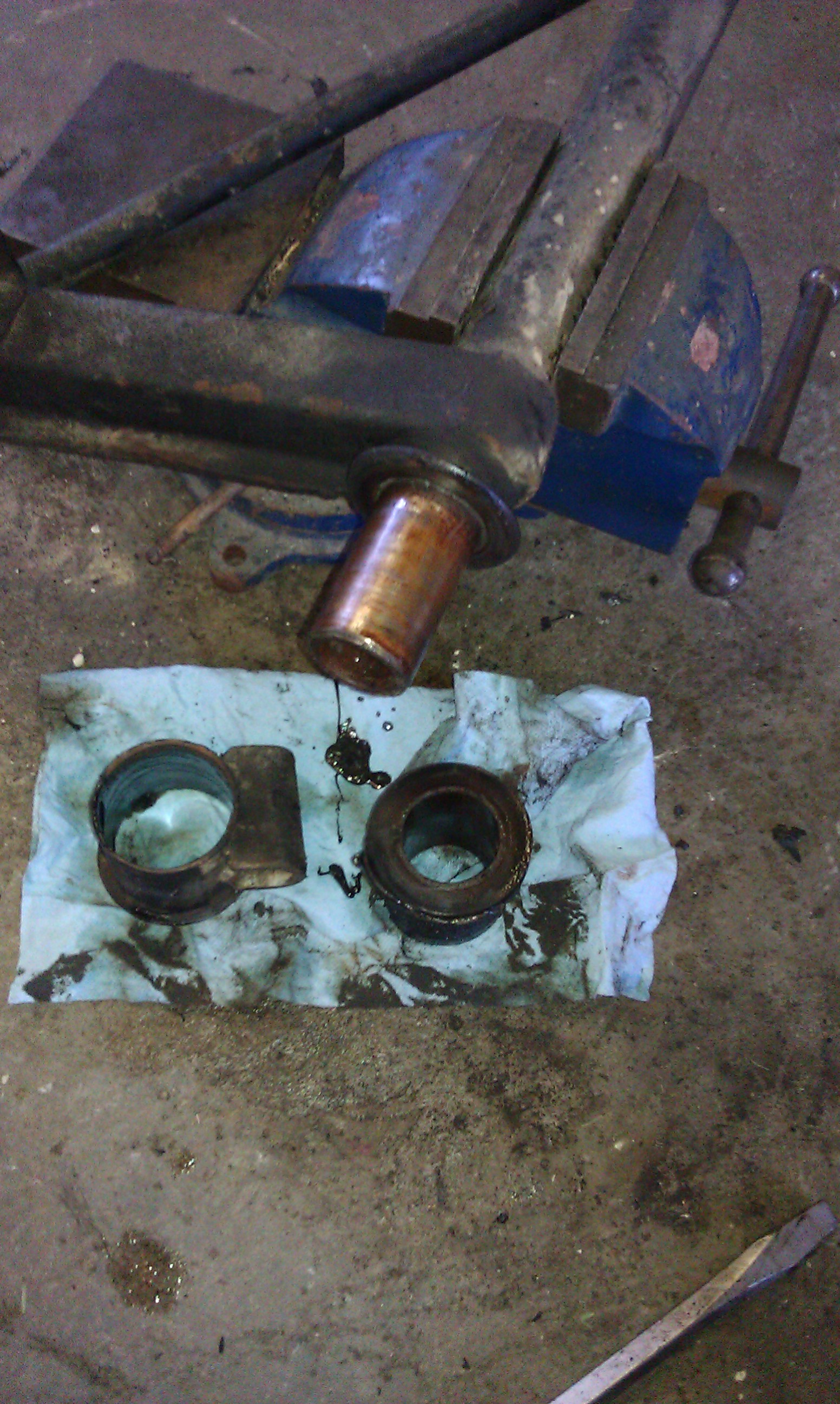

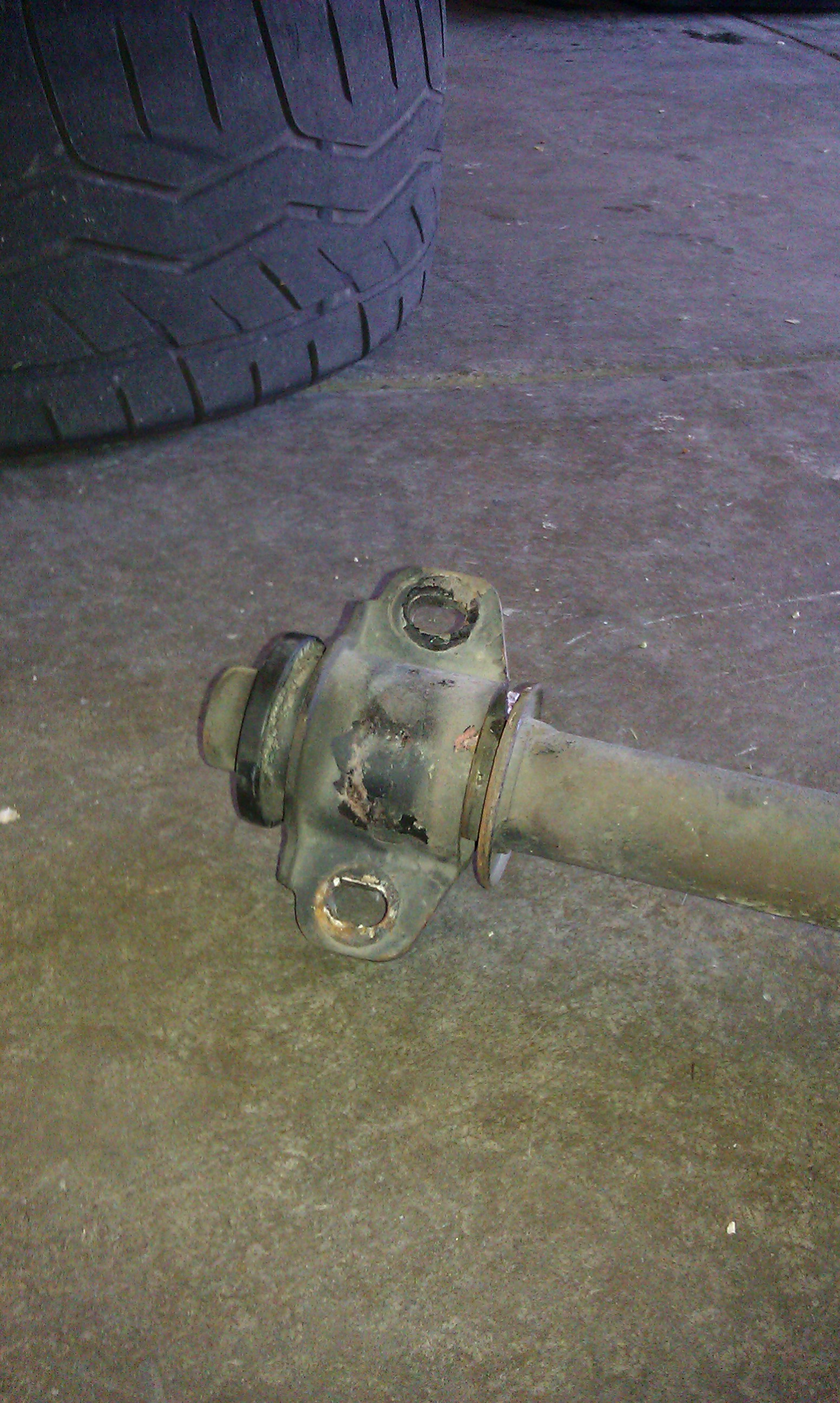

*sigh* really? This is how ONE of the control arms looked when it came off. I could understand maybe if they put them both on backwards, but just one side?!! Half @$$ crap like this is why no one touches my cars but me anymore
Also want to point out that these are poly bushings, they don't flex like rubber, so I would expect to be able to get at least some movement out of the control arm when I apply force. Stood as much weight on it as I could without shifting the car of the jackstands and NOTHING, no movement at all. think that pretty much confirmed I may have not been getting as much as I could out of my front suspension.

The poly bushings dont soften under heat like rubber, they liquify, so at least they came off easy after taking a map torch to the housing. The spare arm I used had rubber which also came off pretty easy but did require a bit of twisting around the arm.

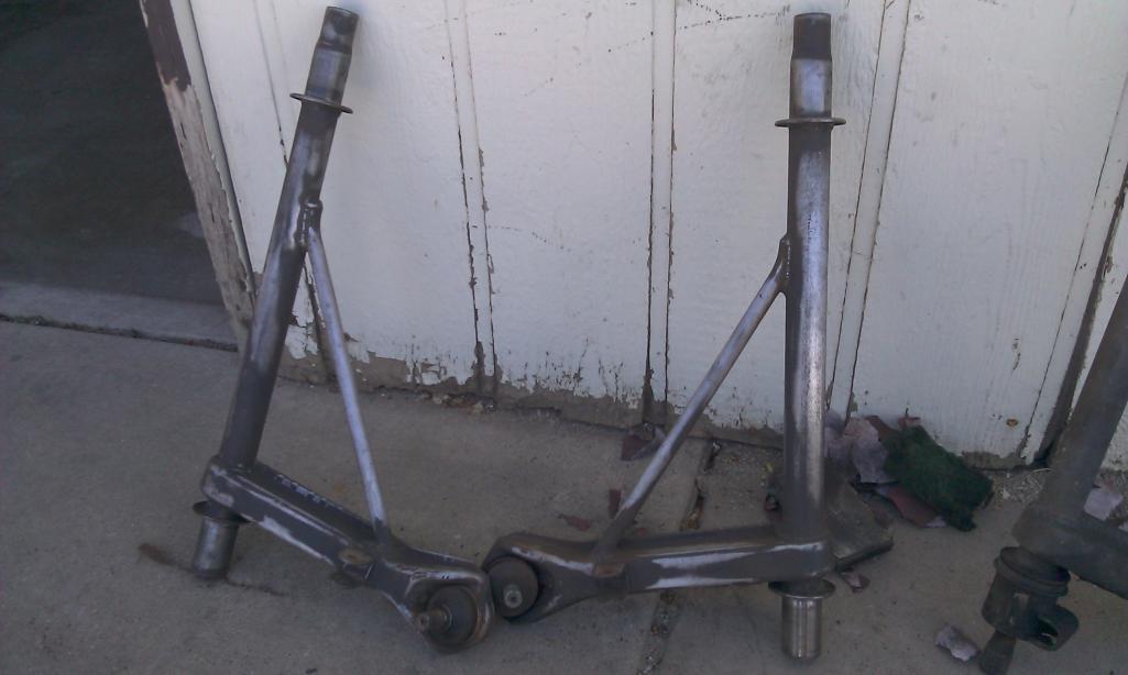

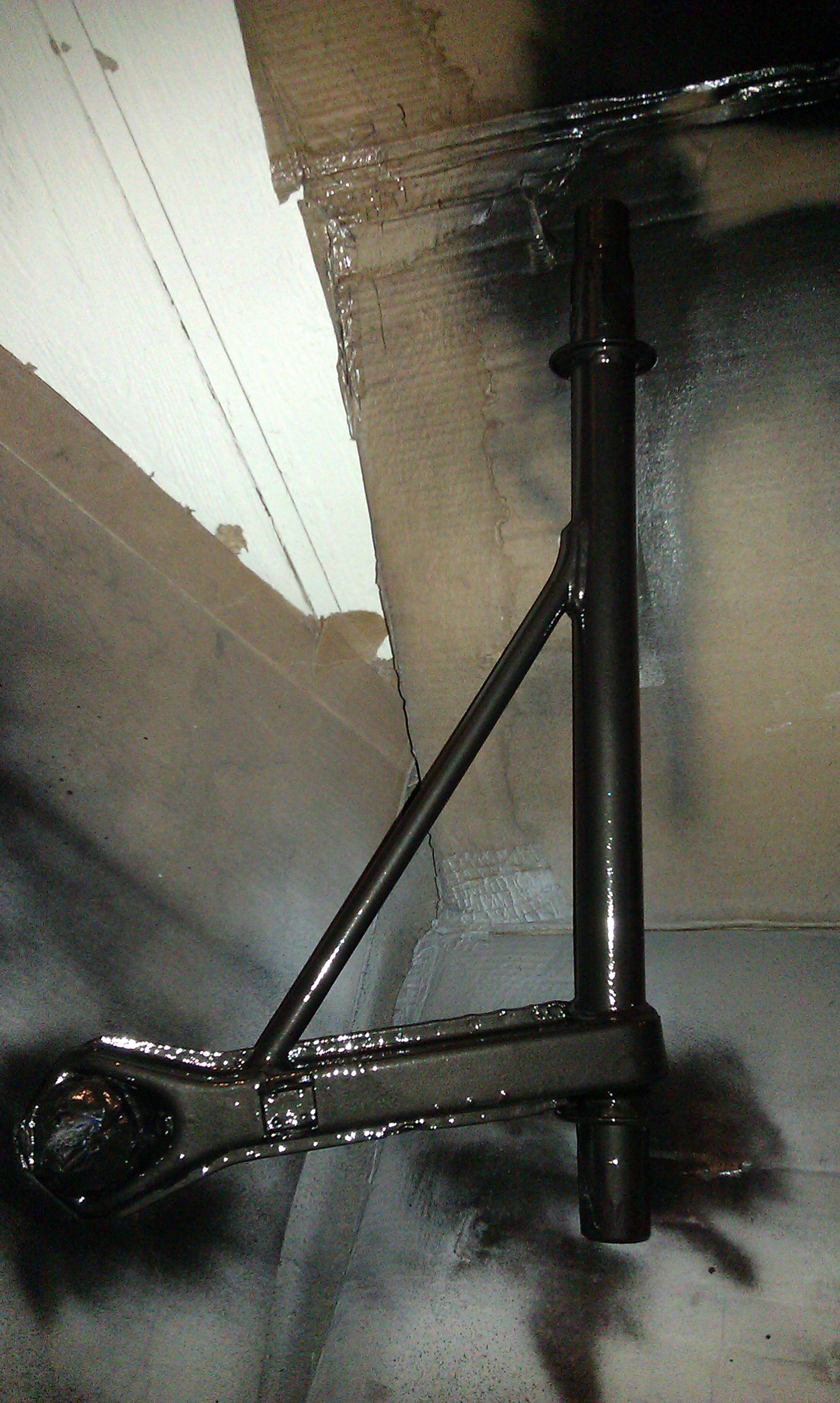

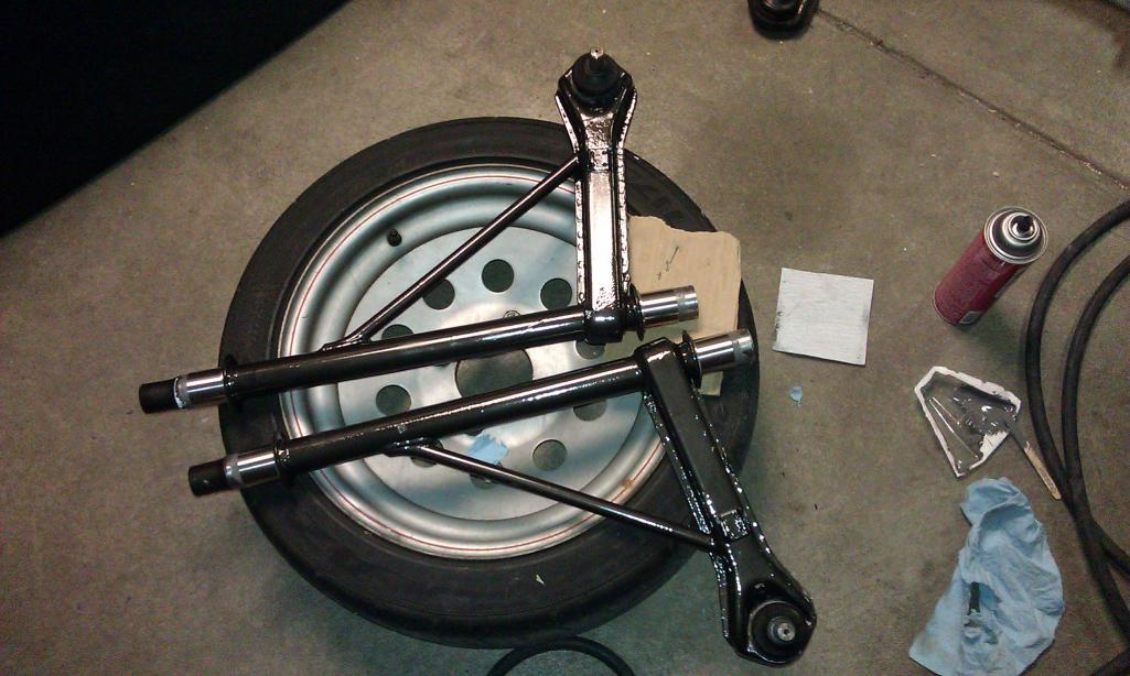

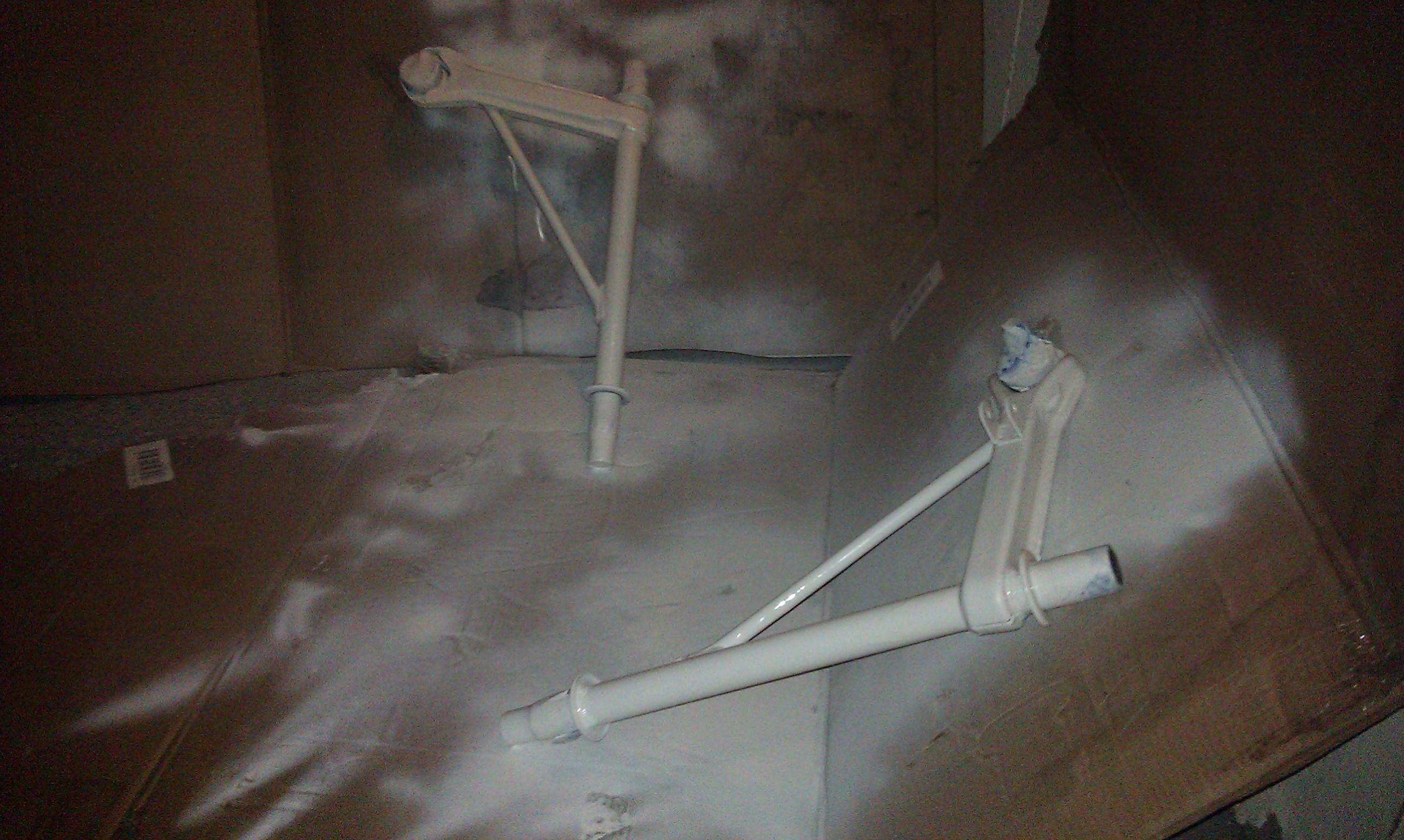

So, this was just going to be a quick job of swapping the bushings, and plan on powdercoating the arms this winter, but as I had to replace one of the arms, the patina didnt match between the 2, and I can be a bit obssessive....
Figured I could a least protect them a bit for now and make them match
Clean & sand:
Primer:
Paint:
was going to get some flat black but I had some left over Rustoleum "Hammered" that I just love the look of.

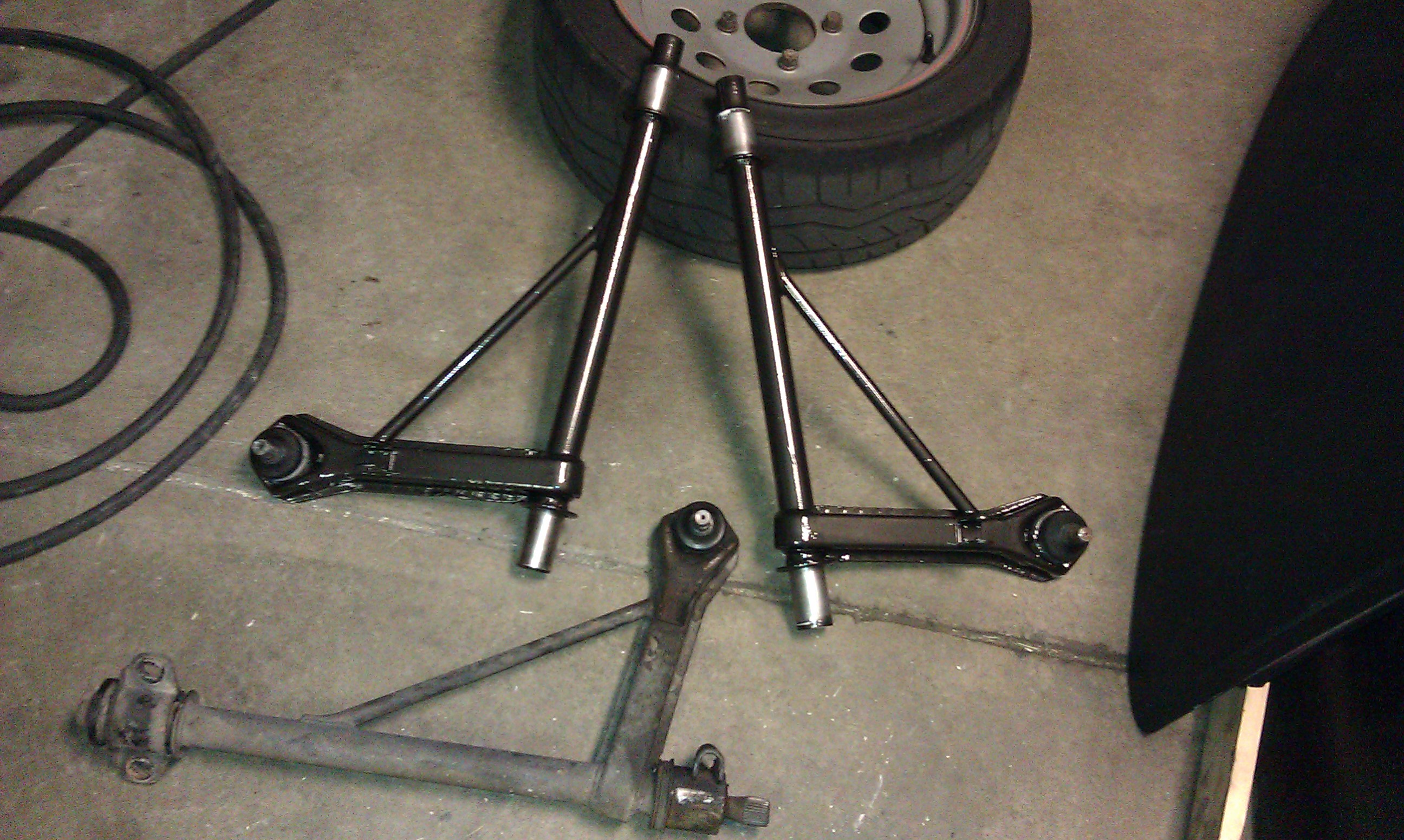

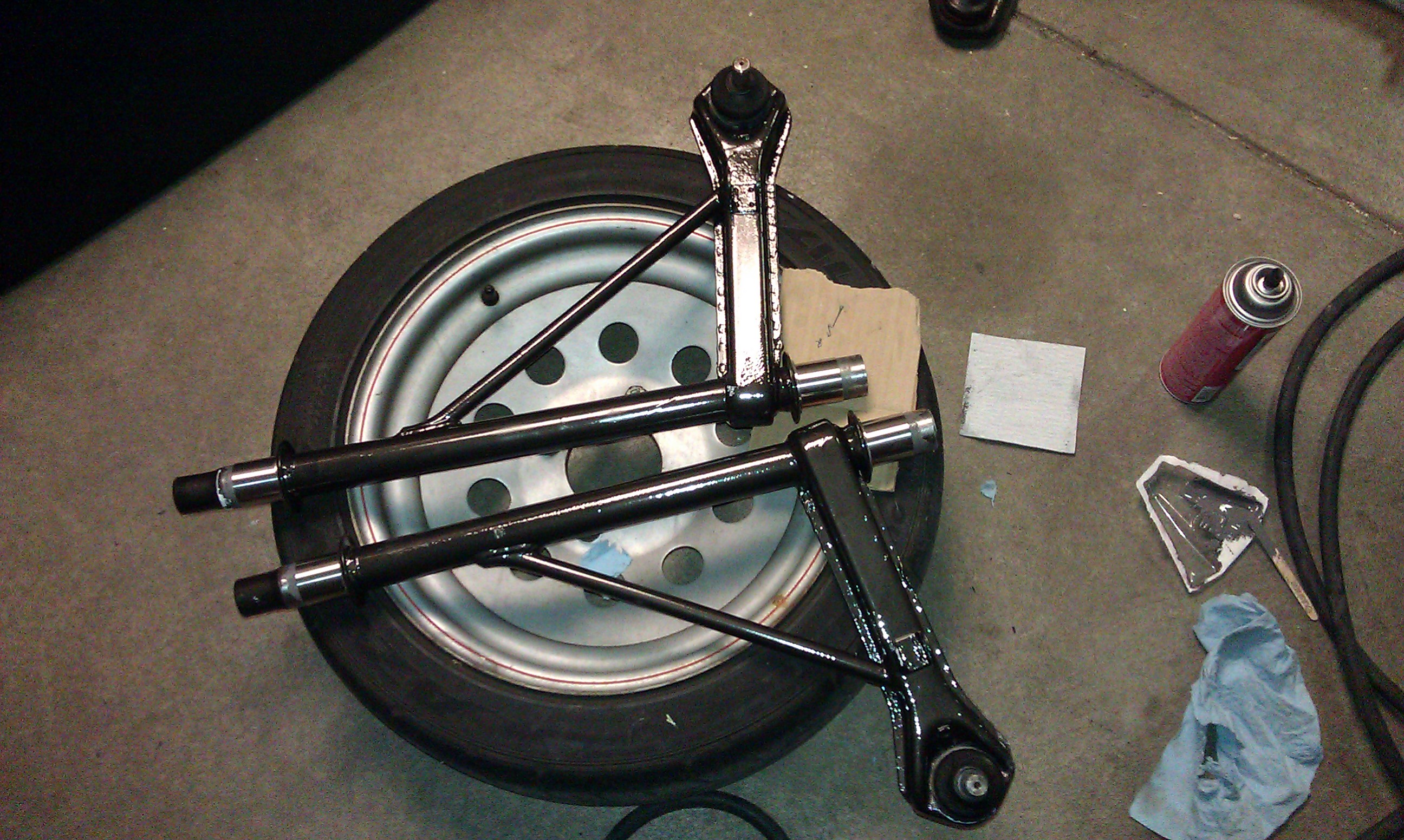

Before and After
Races installed
JamesM
post May 28 2013, 05:56 PM
Posts: 2,348
Joined: 6-April 06
From: Kearns, UT
Member No.: 5,834
Purdy!
Install was quite a bit easier then disassembly. JB weld the races to the arms and the races just slide in the housings. Where I had ZERO movement with the polys, these things are like sex lube on ice! Completely dry as well, zero grease needed ever so I don't expect their performance is going to change much over time as I don't have to worry about grease drying up.

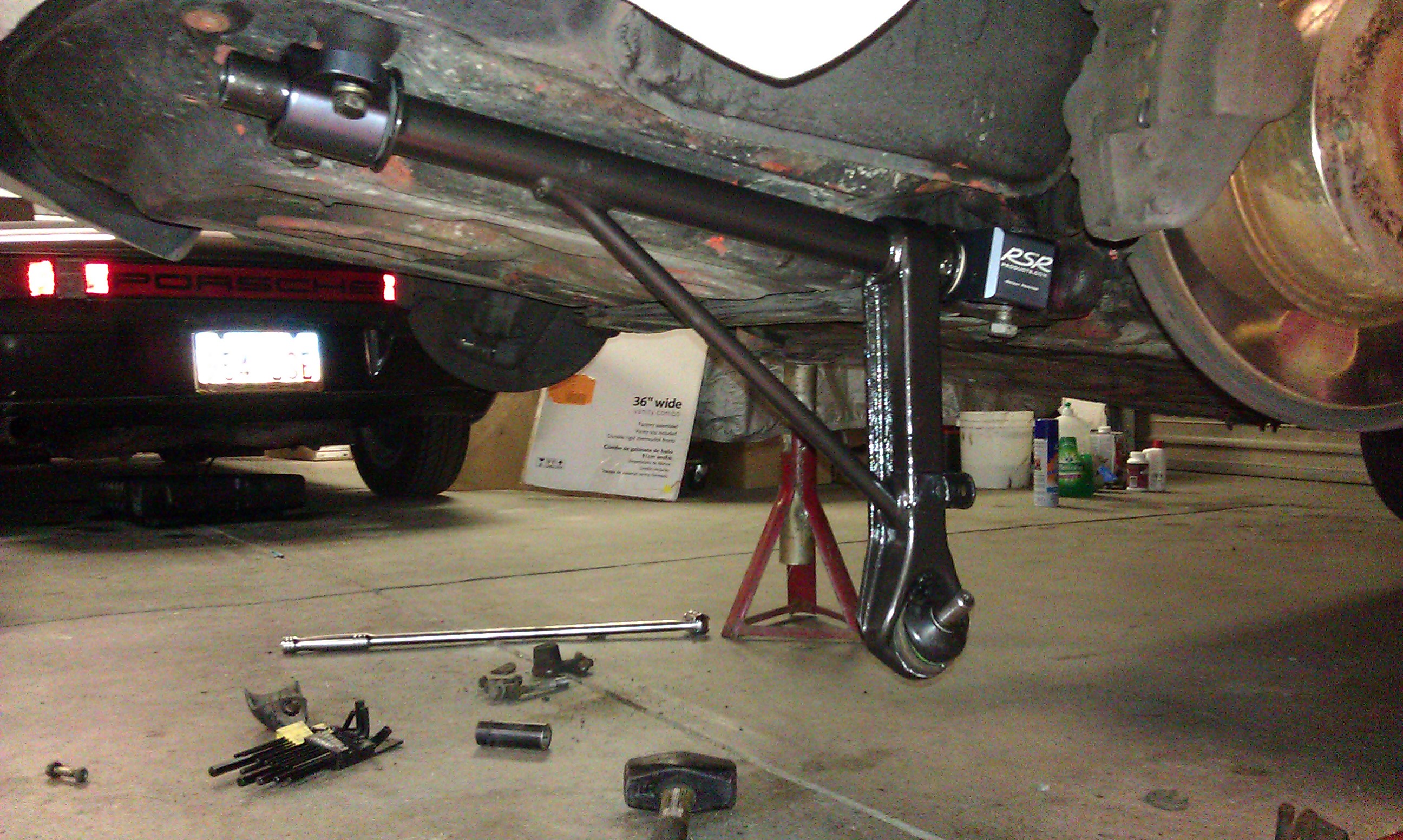

Should be able to finish getting everything back together tonight. Hopefully the forecast was wrong and it doesent rain for the next 3 days as I really want to try these out. I am somewhat concerned that I will need to wind up going with bigger torsion bars now as i think the polys were massively increaseing the stiffness in the front end. Either way I am super excited to see how they feel as I know they will be an improvement.
Something I want to point out on the poly bushings, these were the older, soft compund polys, installed with a hammer by a bunch of idiots. I actually installed Erics polys as a replacement in my rear control arms, and when properly fitted for both the diamater of the control arm axle, as well as its length, then lubed with 508 copper antiseize, they move freely and are so far quiet, so I think it depends a lot on how they are installed.

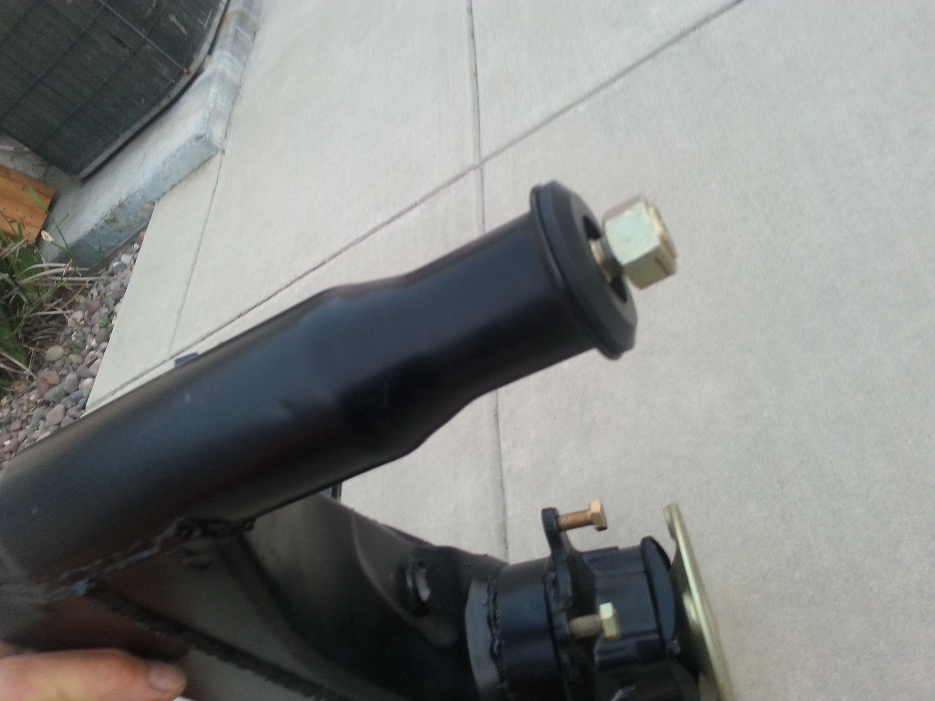

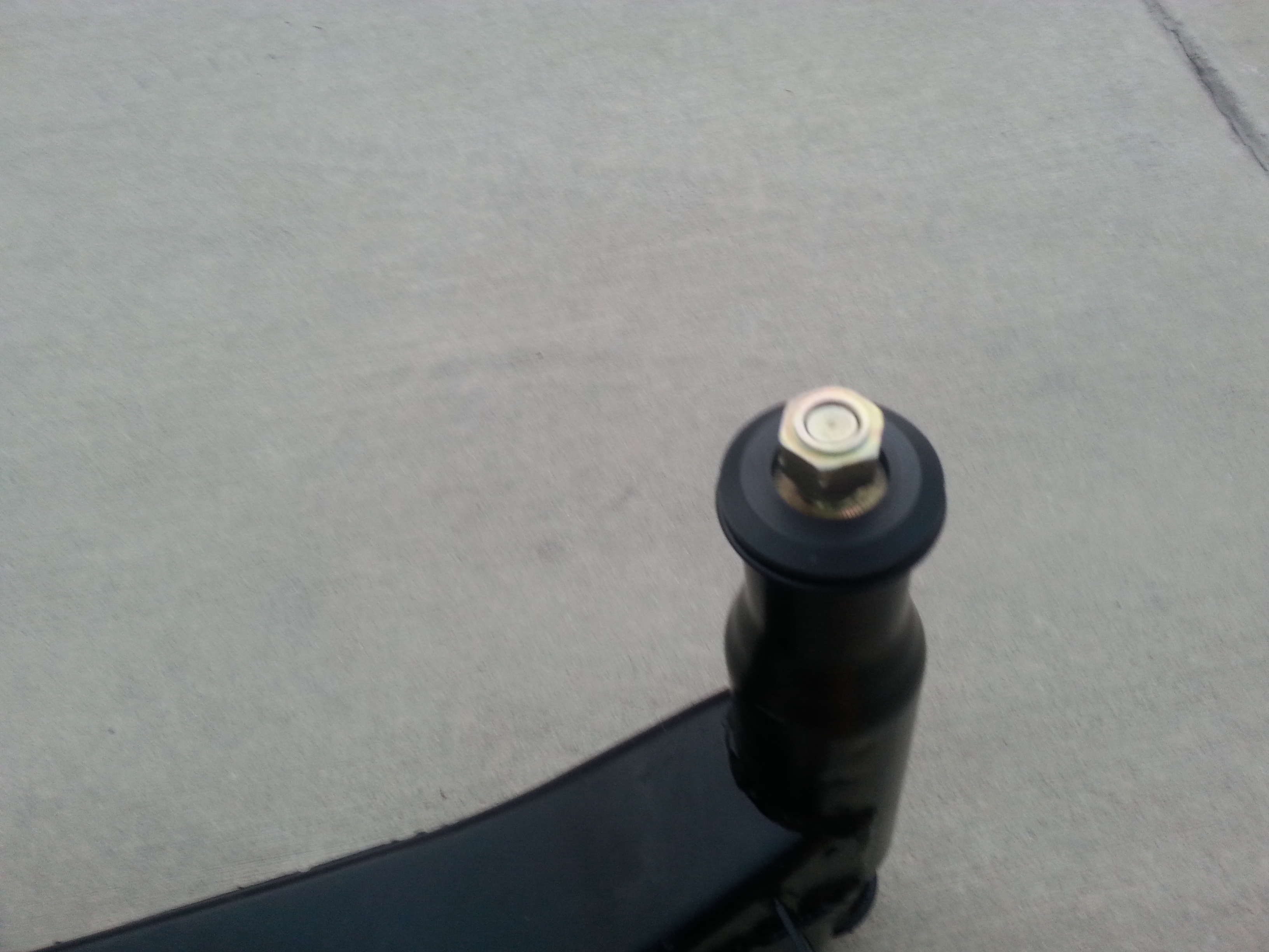

Ok James and thanks nice work. No hijack meant but here are a few pics. I did get these from Eric and did speak with him briefly on the subject......Utah is a beautiful place but I wished he lived out here!
Here are a couple of pics. So what you mean is that the outside bushing....the side of the arm that mounts nearest the long...should be ground down so that the Shorr facing of the inner shaft is flush with the outside of the bushing. The inner shaft or mounting pivot is a tight fit cold...but I can move it by hand through the bushings with very firm pressure. Any comments by your good self are welcome.
Rob
Some pics:
The inner swing arm side. The inner pivot is flush to slightly offset from the bushing. I am assuming this is right.
The next is the outer side of the swing arm. This is what looks wrong to me. From the conversations I have had with folks....this also needs to be flush with the pivot shaft. Meaning...I need to shave the bushing down so that the pivot shaft will cinch against the mount.
Big thanks to Bruce Stone for the swing arm parts....shameless plug.

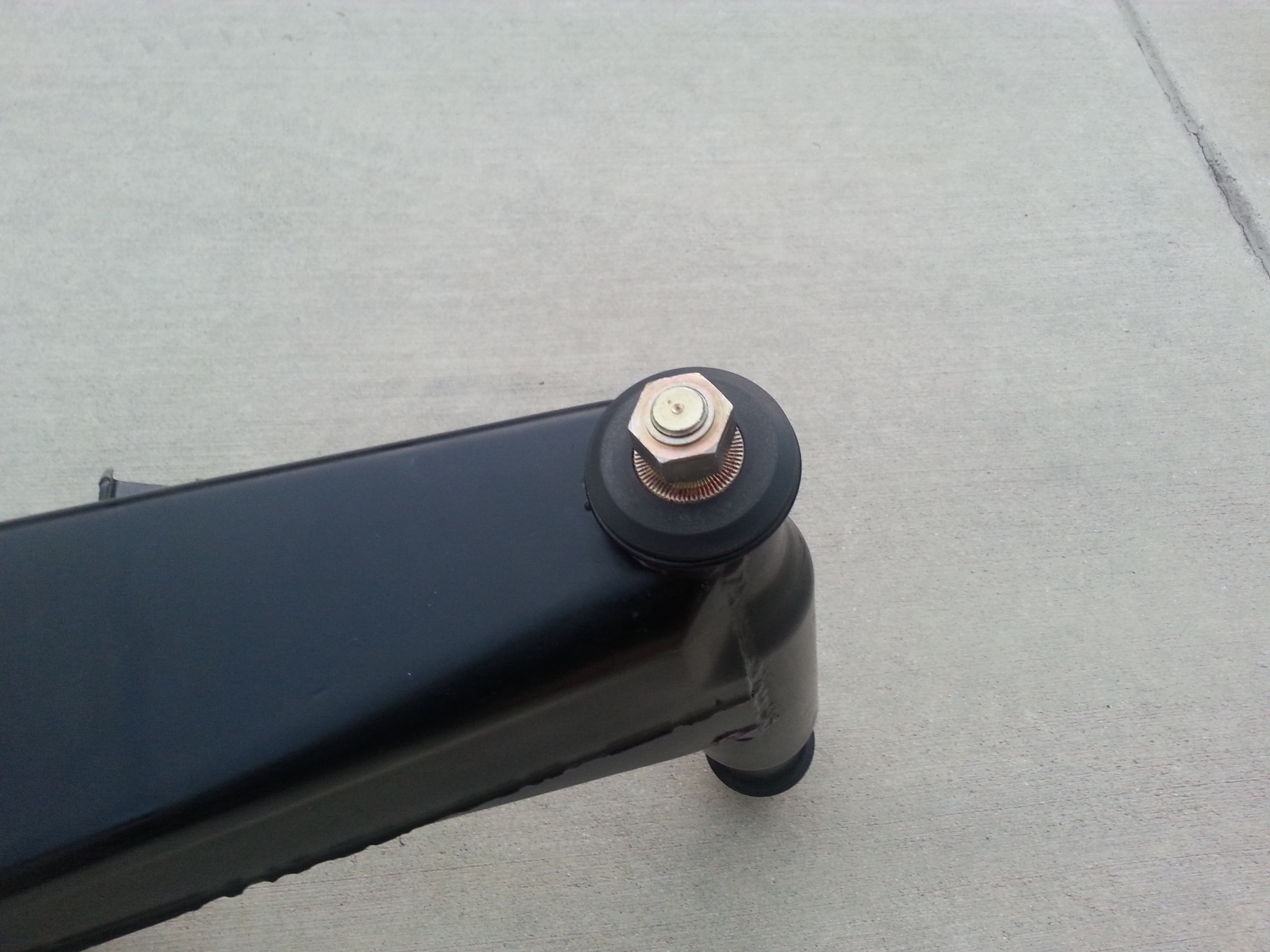

Another view of the swing arm bushing:
any positive comments are appreciated.

Put a large flat washer on both sides with a large enough hole to clear the pivot shaft diameter on both sides. Torque both sides down and let it sit over night. See if the bushing will compress a bit. Hell bolt it in the car. Remember its a new bushing not a bearing so some interference is expected. It will compress.
The factory always recommended installing the trailing arm horizontal to the car not drooped (hanging down) and then tightening the pivot shaft bolts.

Yup, just take a little (even amount) off both sides until you are pretty much flush. Go slow though and test fit often, there is a very thin line between not binding and to much off. I went just a hair too far on one side and that less then a mm gap is pretty noticeable with everything installed. I then cheated and used a ring of gasket maker on the back side of that face to make up the difference, maybe not the best solution but I am not sure at this point how long they are going to stay in the car.
Eric also recomends jb welding them into the contorl arm and installing zerks, I have not yet, again because I am not sure how long they will be in there.
