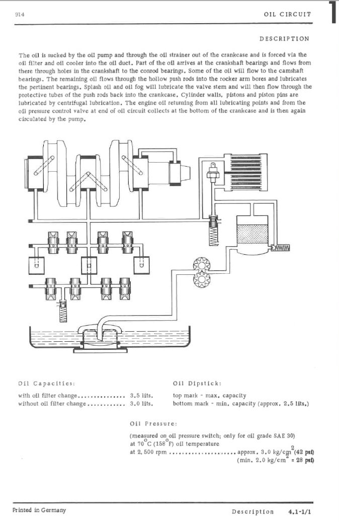

Is this what you need?

Jeff Bowlsby, that is exactly the diagram I used to make mine.
since the original artwork is just that - artwork (bitmap) i decided to make a new diagram using a more modern medium so I can manipulate the pieces.
You might notice one difference: Mine shows that under extreme pressure situations, the first pressure regulator will dump back to the sump.
Notice the stock artwork "hints" at it with the open end on the lower right of the pressure regulator in the stock diagram.
This was based on a recent thread where 'worn' was troubleshooting a stuck regulator piston. (Brant has seen this as well)
I wanted to document what worn found during his rebuild:
http://www.914world.com/bbs2/index.php?sho...210207&st=0
That the system will dump back to the sump if the piston is "stuck" too far back in the relief bore.

Finally updated my drawing to match my current configuration:
(IMG:http://www.914world.com/bbs2/uploads_offsite/i366.photobucket.com-10819-1474723587.1.jpg)
The thermostat in the pics above never actually worked right so I took it out and plumbed straight across the bracket.
If the pressure at the "low oil pressure switch" drops below ~5 PSI it opens the solenoid on the accusump.
There is a one way check valve to keep the accusump from dumping back towards an oil cooler failure.
I also have a manual valve on the accusump to avoid accidental discharge.

(IMG:http://www.914world.com/bbs2/uploads_offsite/i366.photobucket.com-10819-1376808030.1.jpg)
The black "X"s indicate blockoffs, but now it is apparent that some of these applications require non-trivial solutions.
Stu
Using this diagram, if the filter plugs (or when the oil is cold) you will get very little pressure to the engine galley.
