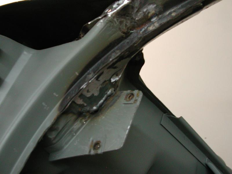

I've "heard" they're much stiffer.
Troy put the A-Pillar mod on Gint's car. Came out awesome. These things crack a-pillars, especially when autocrossed or raced.
When I restored my 911 the a-pillars were cracked. The factory did the reinforcement to prevent cracking. A-pillars are weak, weak, weak.
Here's a couple of pictures that Andy came over and took... (IMG:style_emoticons/default/laugh.gif) (actually, the camera was pointed directly at the light so it didn't like to focus properly.)
