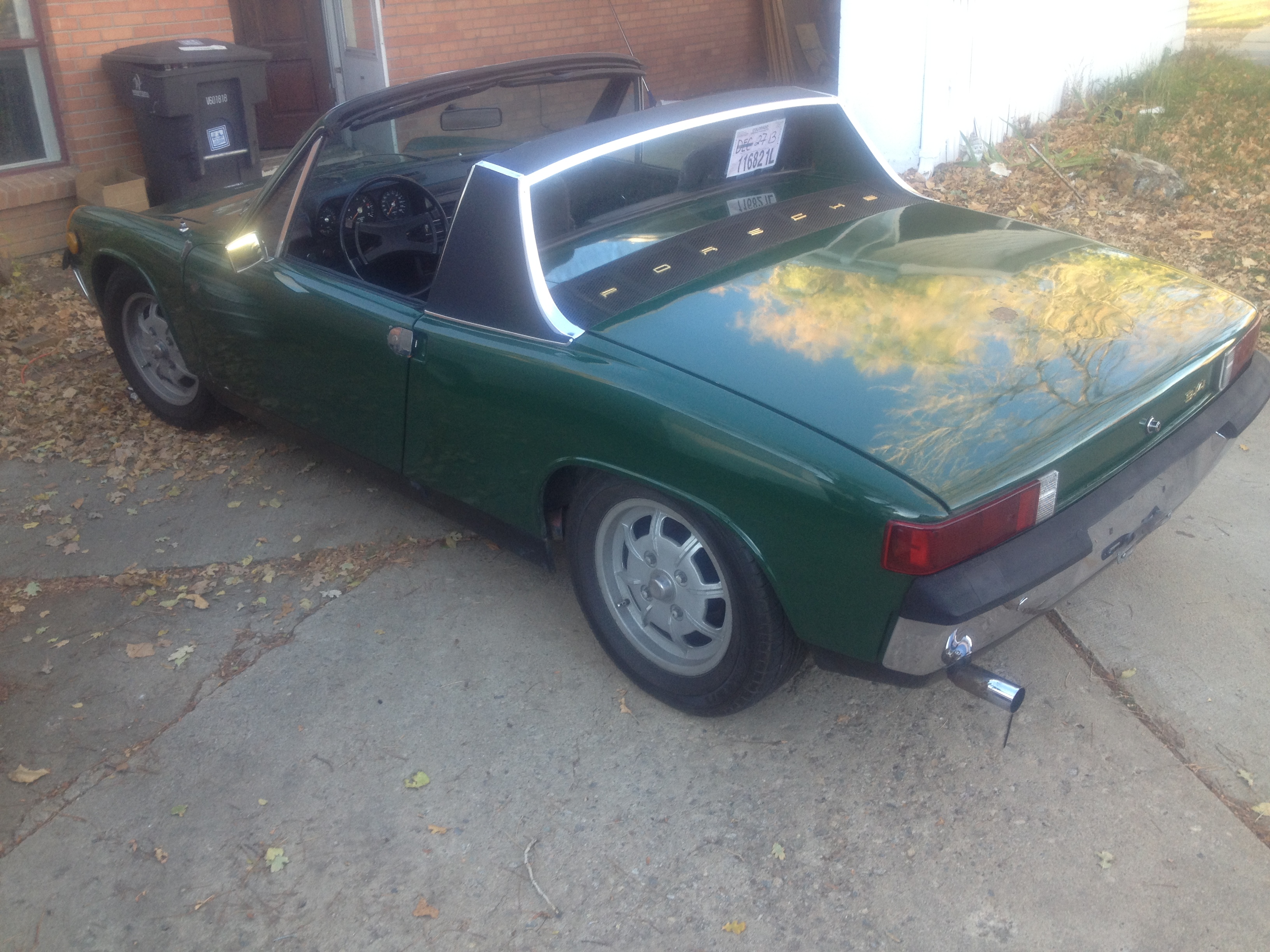

Thanks alot guys. I will upload some pics as soon as I get it jacked up this week. The previous owner stated the engine was completely rebuilt (a 2.0 with IDF 44 Carbs) however, it seems to be leaking quite a bit and I am beginning to question how good a job he did (IMG:style_emoticons/default/WTF.gif) Will have MANY more posts as I uncover the issues this car is bound to have.....super super fun to drive in the meantime! Here's a pic!Attached Image
