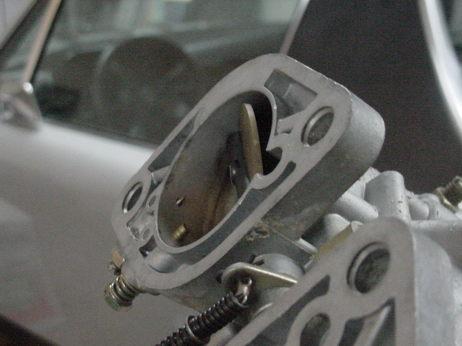

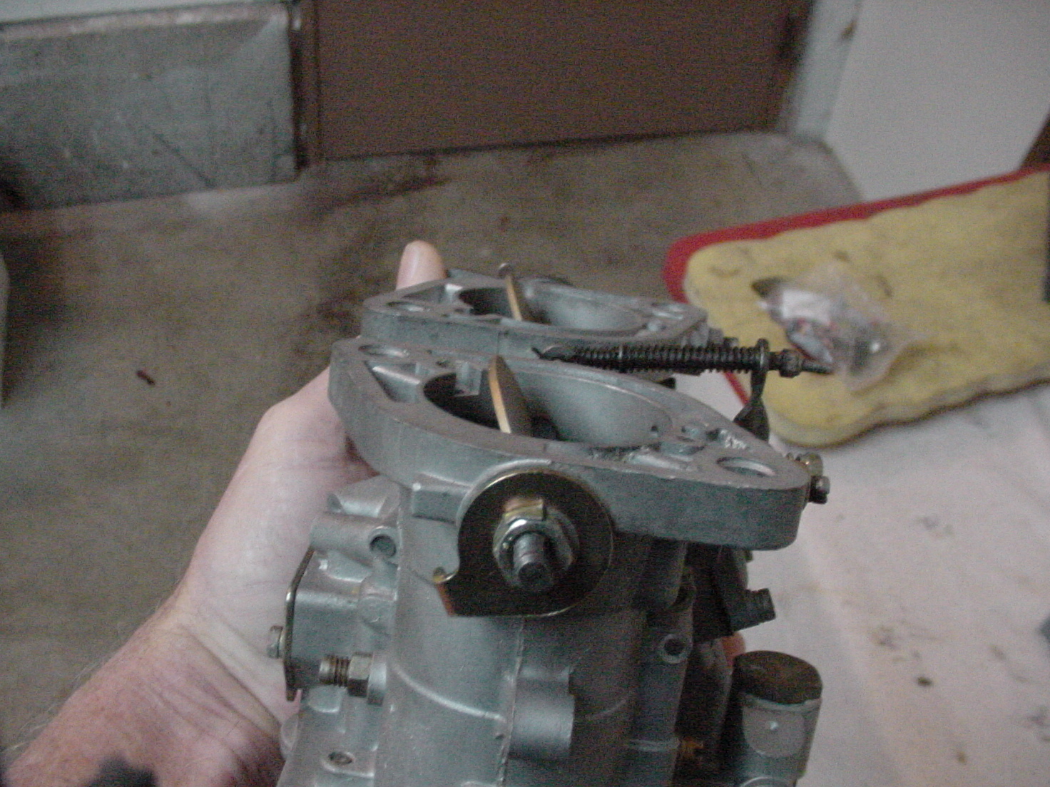

4K indicates something more towards the top-end of the carb. Is it possible you put your auxiliary venturies in backwards? This is very easy to do.
Yes, the floats absolutely need to be adjusted correctly. But not likely that is what's causing your issue, IMHO. Your settings should be somewhere around 11 mm with the gasket already in place and 32 mm dropped (without any tension).
(IMG:http://www.914world.com/bbs2/uploads_offsite/www.poustusa.com-13527-1384174375.1.gif)
You mentioned that you removed the butterflies, correct? Did you remove the throttle shafts? Also, do you notice any binding, and are the butterflies closing completely on both barrels? You can check this by shining a light down them and looking from the other side to see light (when the carbs are off the car and drained of course).
If we could get a picture of the carbs, that might help with any immediate visual confirmation. We'll get you sorted out.

confirm the throttle plates are installed with the degree number, like 5*, visible from the top and the beveled edges are in the correct orientation.
after re-jetting you got started with going to the pre-install setup procedure, yes?
Just for clarification. the numerical stamp on the butterfly valves should be facing into the engine? or upward into the top of the carb? The LAST thing I want to do is score the inside wall of the carbs....BTW, after putting almost 15 hours of work into this project, patience is something that wears thin.... but I will always have patients for this car..... she's my baby.

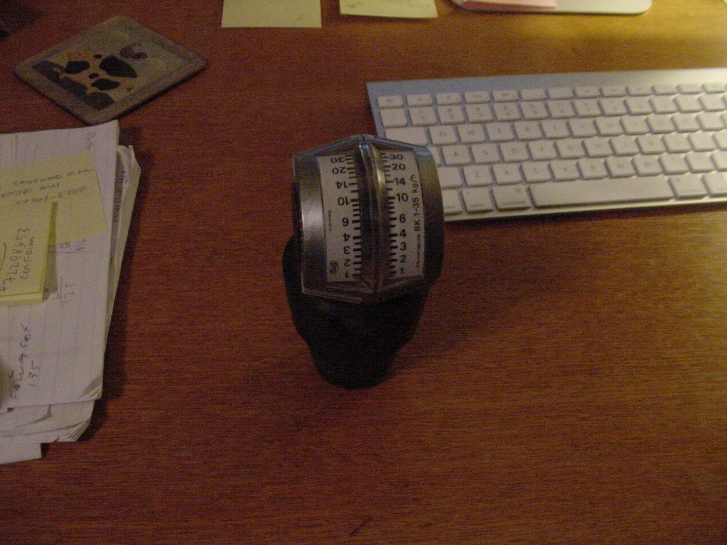

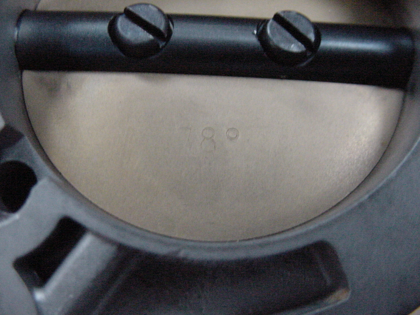

i misspoke with the degree number i guess. at least with this set. to clarify a bit...both edges of the plate have a bevel, with the shallow edges of the bevels being the closest to the venturi when the plates close. wider carb pict shows the opening aspect and carb orientation for the other pictures. the bevel picture is shown with the bottom of the carb pointing upwards. the degree (78*) mark is on the side of the plate with the longer edge of the bevel. all 4 plates must be installed commonly in the correct orientation. time consuming, edit edit edit, and hard to explain in text and be clear. takes about 2 minutes in person.
buy the cb book and get a synchronizer like the one pictured.

QUOTE(rhodyguy @ Nov 12 2013, 08:33 AM) *
i misspoke with the degree number i guess...
I believe it says 78 Kevin.

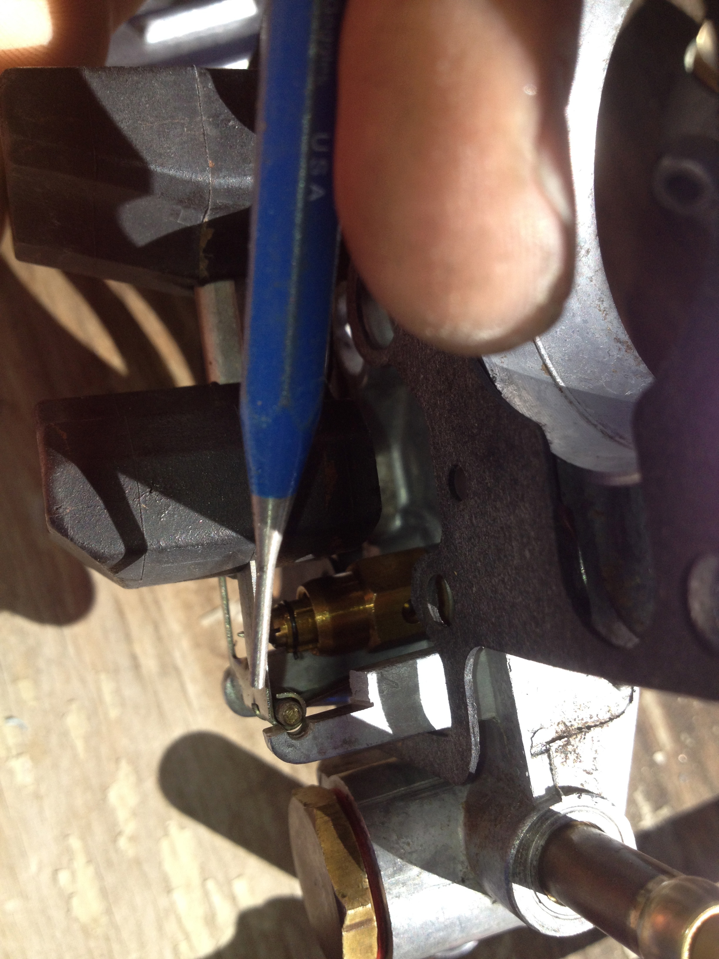

Ok guys....bad news. I woke up this morning psyched to adjust the float needles on the carbs and synch them, and I discovered that a piece of the plate that holds the pivot needle for the float is broken and is no longer holding the float pivot in place!
I am so frustrated! I am now wondering if these carbs are just clapped out... Does anybody have any suggestions, or any spare IDF 44 scraps? Could I JB Weld or something to just hold the pin in place for now to get the car running? Should I just buy new carbeurators?.....I really cannot afford this right now!
Heres some pics of the one that is broken piece:
Whats the damage here......

I hope you found the piece in the bowl...

I actually have seen and used in weld in different gas application. There are some products that are better for fuel. There is also a helicopter certified alloy welder in longmont that I have used to weld motorcycle carbs before.
Don't give up!

You might even be able to safety wire that

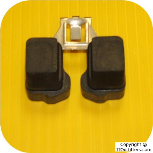

Is that not an integral part of the float? Get a new float, should be available, and do it right (IMG:style_emoticons/default/wink.gif) Way to stick to it and find the/an issue, though.

It's a broken split tab, Mike - but repairable.

I am used to mikuni, bing, etc, where that piece is easily replaced. Looked integral in the pic. So, the float bolts to the tab?

Ya, a new float will have that tab. This is what I am talking about.
