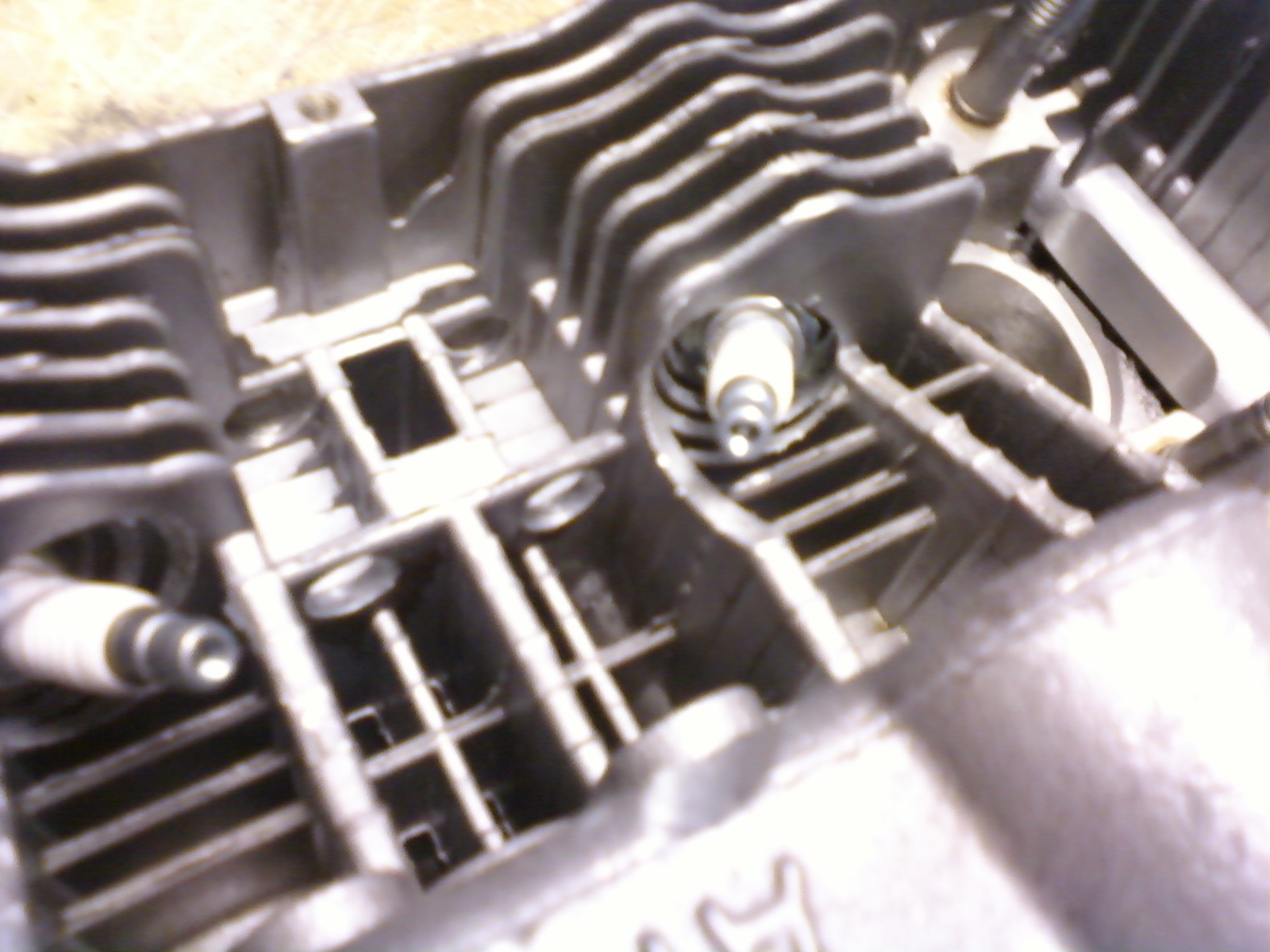

Here's a few pic's of my planned conversion to twin plug with a Pauter cam (IMG:style_emoticons/default/smile.gif) , &
either MSII or MegaJolt with edis4 x 2 for ignition, Bill D.

Any flow bench work done on the heads?
How did the numbers look?

This is what I'm talking about. (IMG:style_emoticons/default/aktion035.gif) what compression are you shooting for? (IMG:style_emoticons/default/popcorn[1].gif)

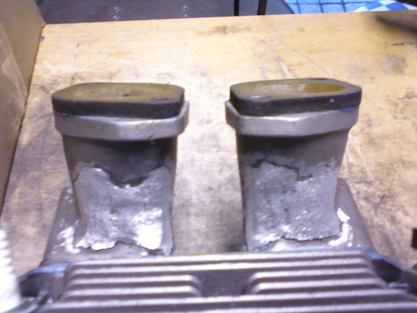

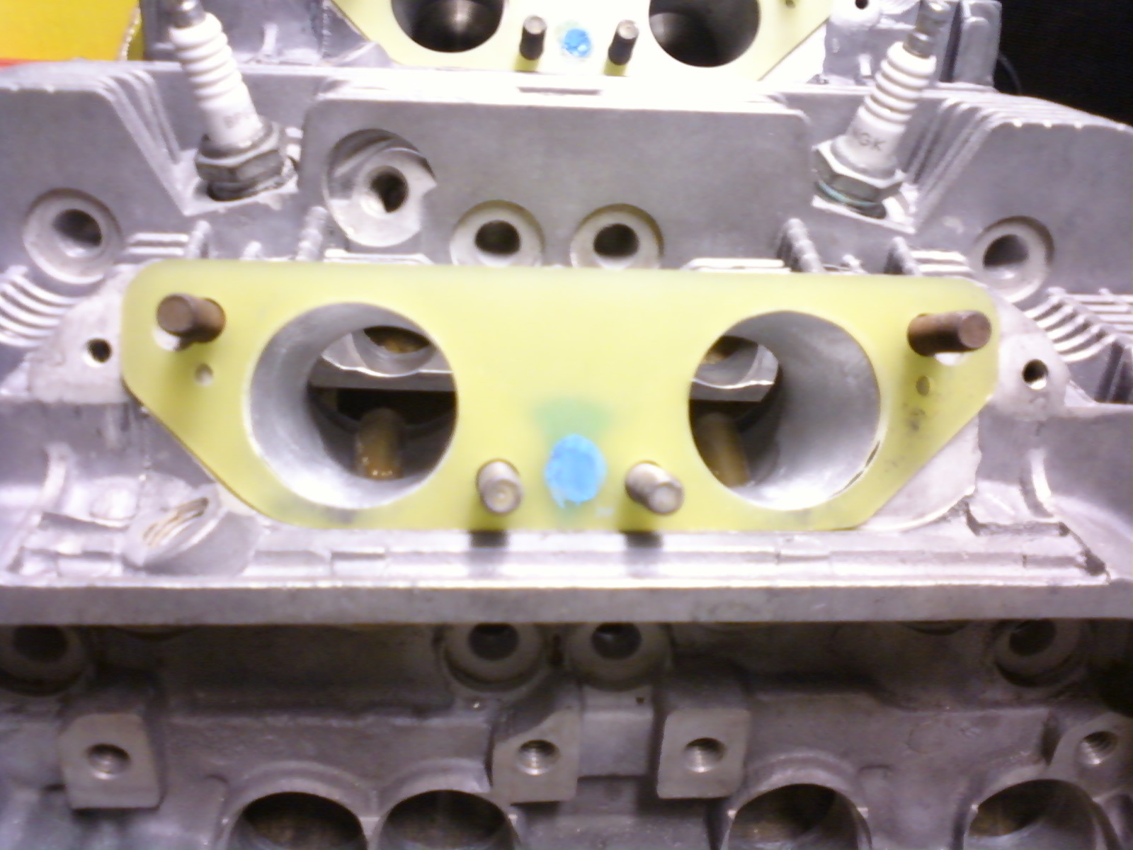

QUOTE(WLD419 @ Nov 24 2013, 09:46 AM) *
If I read your calipers correctly you have a very large step increase in port size from outlet of intake manifolds to head port inlets, not a good aero flow path.
Whats the thinking here ???

Rich , I don't have any flow numbers , I ported these heads myself (budget build)

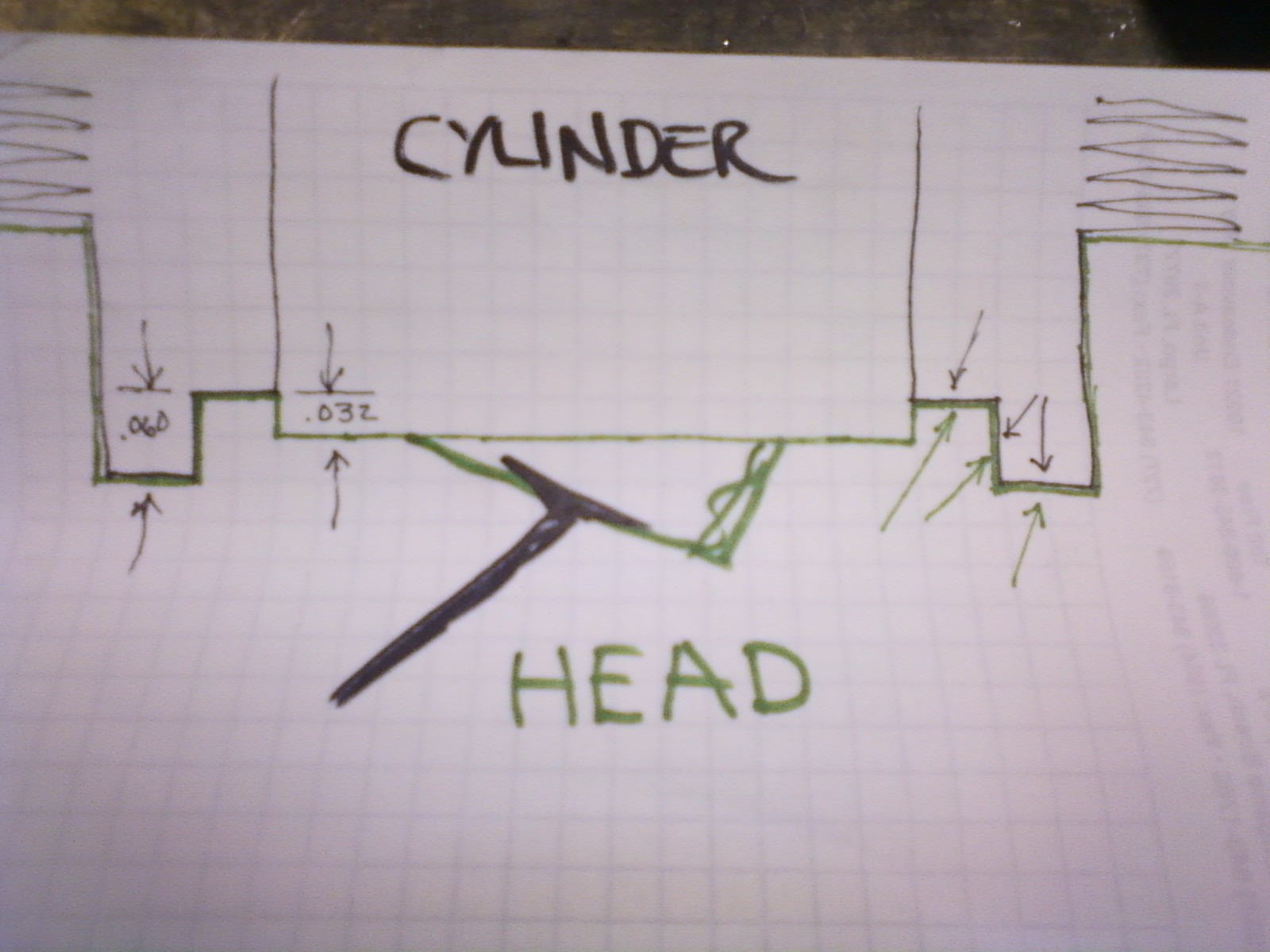

I had Jorge at EMW do the twin plugs for me , I did the chamber work & cut the .060
step in the cylinder seating area ( trying to get a better seal , 103mm bore ) I had
Len ( HAM ) cut the valve seats on his Serdi machine ,
Woody , the compression will about 11 to 1 with a .032 deck machined into the head chamber area ,
Barefoot , that's a picture of the intake manifold before porting & after porting , 33mm before & 40mm after , & 50mm where the 48mm throttle bodies bolt on ,

Twin plug engines LOVE cylinder pressure! I always back up a few degrees on duration and start at 11:1 CR with the tightest deck possible. So far thats been good for 274HP from 2.8 liters on 91 octane. That engine had .025" deck.
You'll find that timing the engine is very, very far removed from your previous attempts and that it will optimize much leaner than it used to.

Thanks Jake for chiming in , these are those vintage heads I picked up last year on your e-bay site (IMG:style_emoticons/default/smile.gif) , wow .025 deck is a little to close for me (IMG:style_emoticons/default/biggrin.gif) , the timing I've read & been told will be less ,they say as much as 6-8 degrees less , this twin plug stuff is all new to me
but its time for a change on this motor ( 3yrs + running on this version) , I'd be happy with 200hp at wheels , 15 more than I have now (IMG:style_emoticons/default/biggrin.gif) , thanks Bill D.
