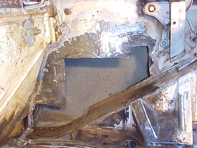

I'm repairing the battery tray and related hot spot. (IMG:http://www.914world.com/bbs2/html/emoticons/unsure.gif)
I need your tech advice on the procedure.
I want to first make paper templates and then fit the sheet metal. Maybe hang it with rivets or screws before the big weld off.
Stock look is not important to me. Just needs to drain and support the new battery tray and pedestal.
I will sand off the remaining surface rust before applying rust converting primer. I'm scratching the naval jelly approach.

Man, that's a big hole.
You have your work cut out for you (pardon the pun).
I would make up some templates as you suggest and then start filling in the holes. I would not use rivits, but clamps/magnets/etc. to hold the parts in place while you weld them in.
I would probably start with the longitudinal repair and work "up" from there. I would suggest to leave a large drain area and not necessarily duplicate what the factory did in that area (BTDT).
As for the battery tray and support, I would buy the parts and weld in the support and then screw the tray to the support so you can clean under it annually.

In the picture below I've marked off the pieces I'd cut and numbered them in the order I'd weld them in. The first piece would be the firewall patch. I'd clean out all the seam sealer goop and weld this in from inside the passenger compartment. Then touch it up if needed from the engine side. Next would be the vertical portion of the longitudinal because if you save it for later you won't be able to get to it. Also, it provides something to weld too when you get to the horizontal top patch. Since the tongitudinal top is curved you'll need to do some 'beat to fit' as they say. Rough out your patches with plenty of overlap. I put a question mark on the longitudinal top patch because I'm undecided whether I'd make it short, or longer (into the area with the question mark). It depends on how weakened that area looks to you. Since I've shown a top patch with so much overlap I'd probably drill holes above the overlap areas for some rosette welds to tie it together really strongly. This is just my suggestion and I do not have an advanced degree in rustoration science.

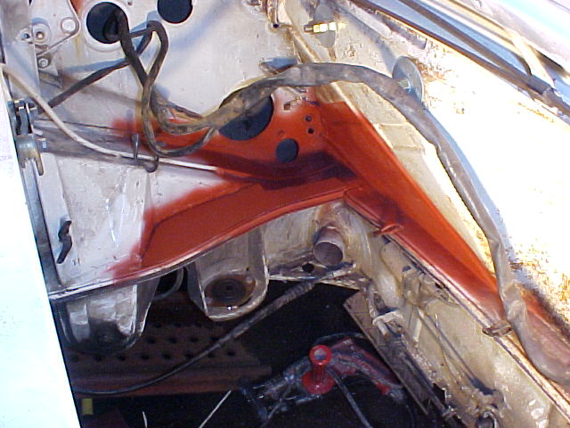

Good things are happening (IMG:http://www.914world.com/bbs2/html/emoticons/biggrin.gif)
Used the grinder and wire wheel to remove most of the surface rust.

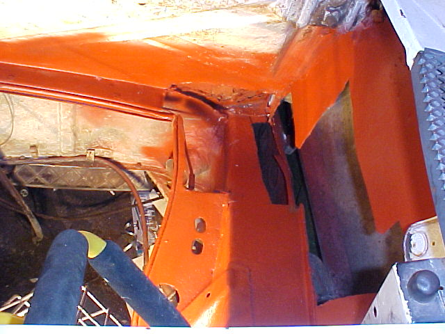

Painted with rust converting primer. (IMG:http://www.914world.com/bbs2/html/emoticons/rolleyes.gif)

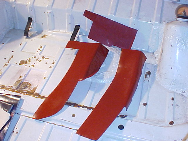

Here's the pieces ready to weld in.
Firewall patch, engine shelf in 22g and the long patch is in 16g.
After this post I'll go weld 'em in. (IMG:http://www.914world.com/bbs2/html/emoticons/welder.gif)

One more (IMG:http://www.914world.com/bbs2/html/emoticons/dry.gif)
I made a matching engine shelf for the other side.
Covers the hole and blower pedestal butchery.
