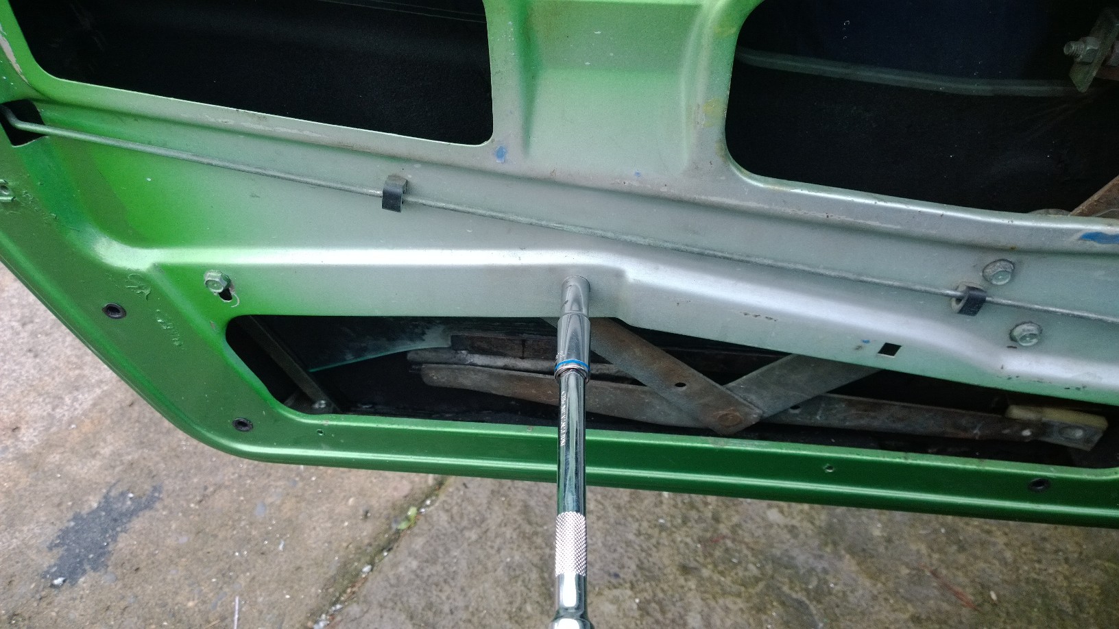

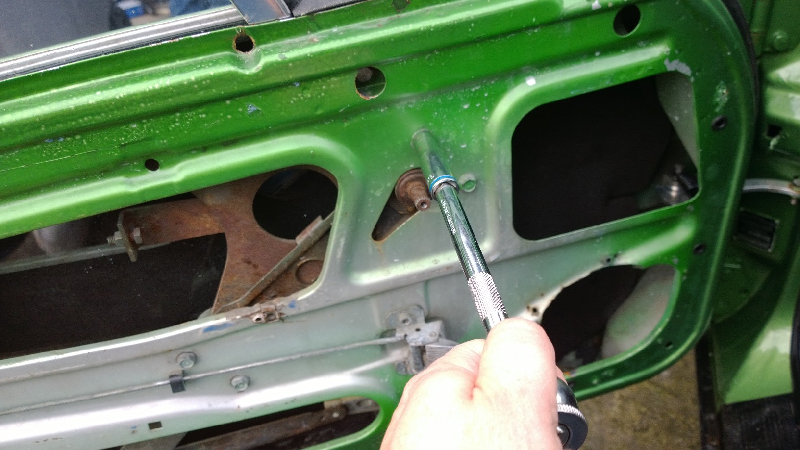

It's time to remove the window.
The 13mm socket with an extender will be what you need here.

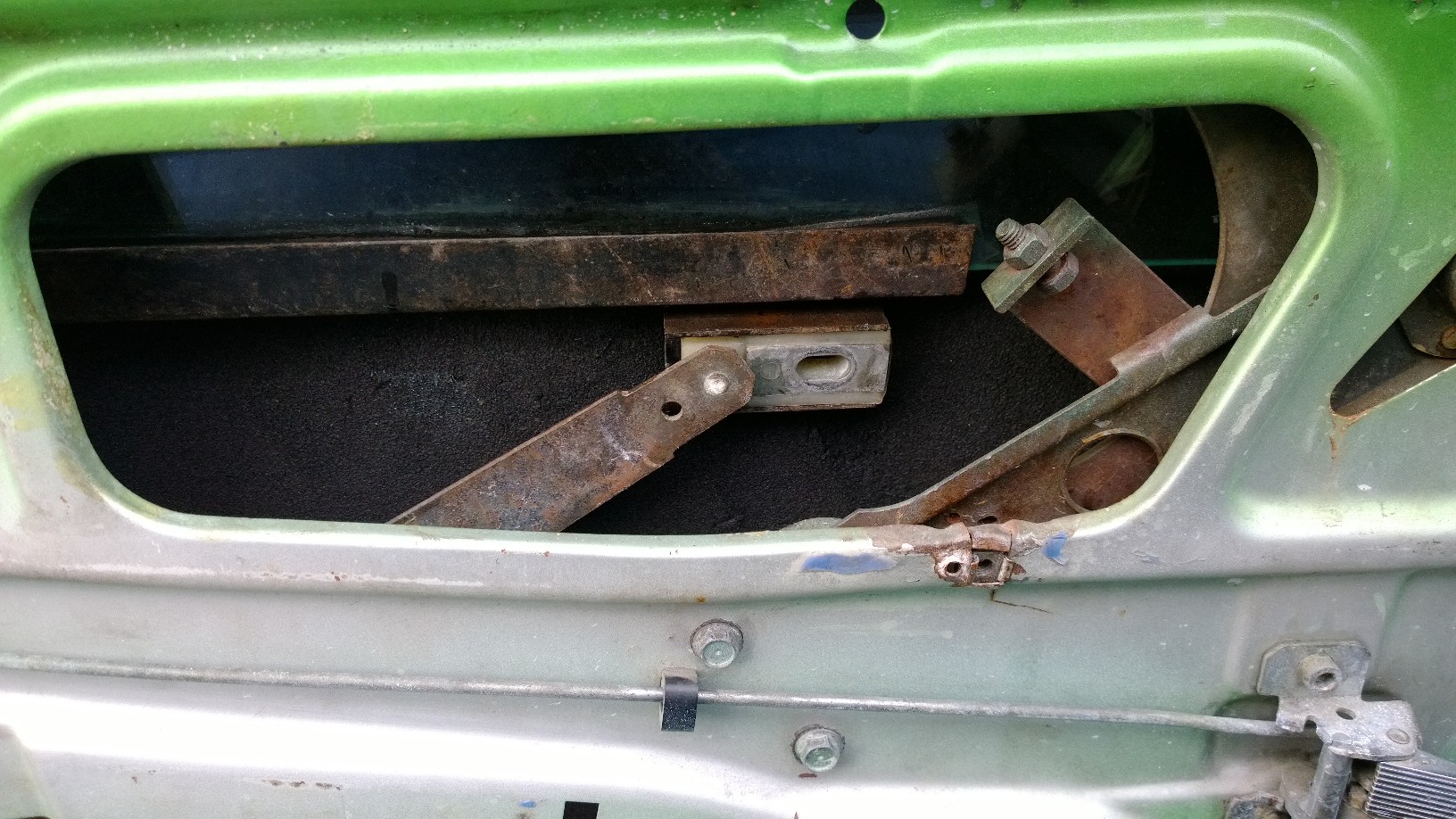

Remove the rear armature for the window scissor mechanism. Note that this is also used for adjustment.
Mikey914
post Feb 17 2014, 12:49 AM
The rubber man
Posts: 12,786
Joined: 27-December 04
From: Hillsboro, OR
Member No.: 3,348
I found it easier to take the window mechanism loose. I did not remove it, but it allowed me to shift it around.

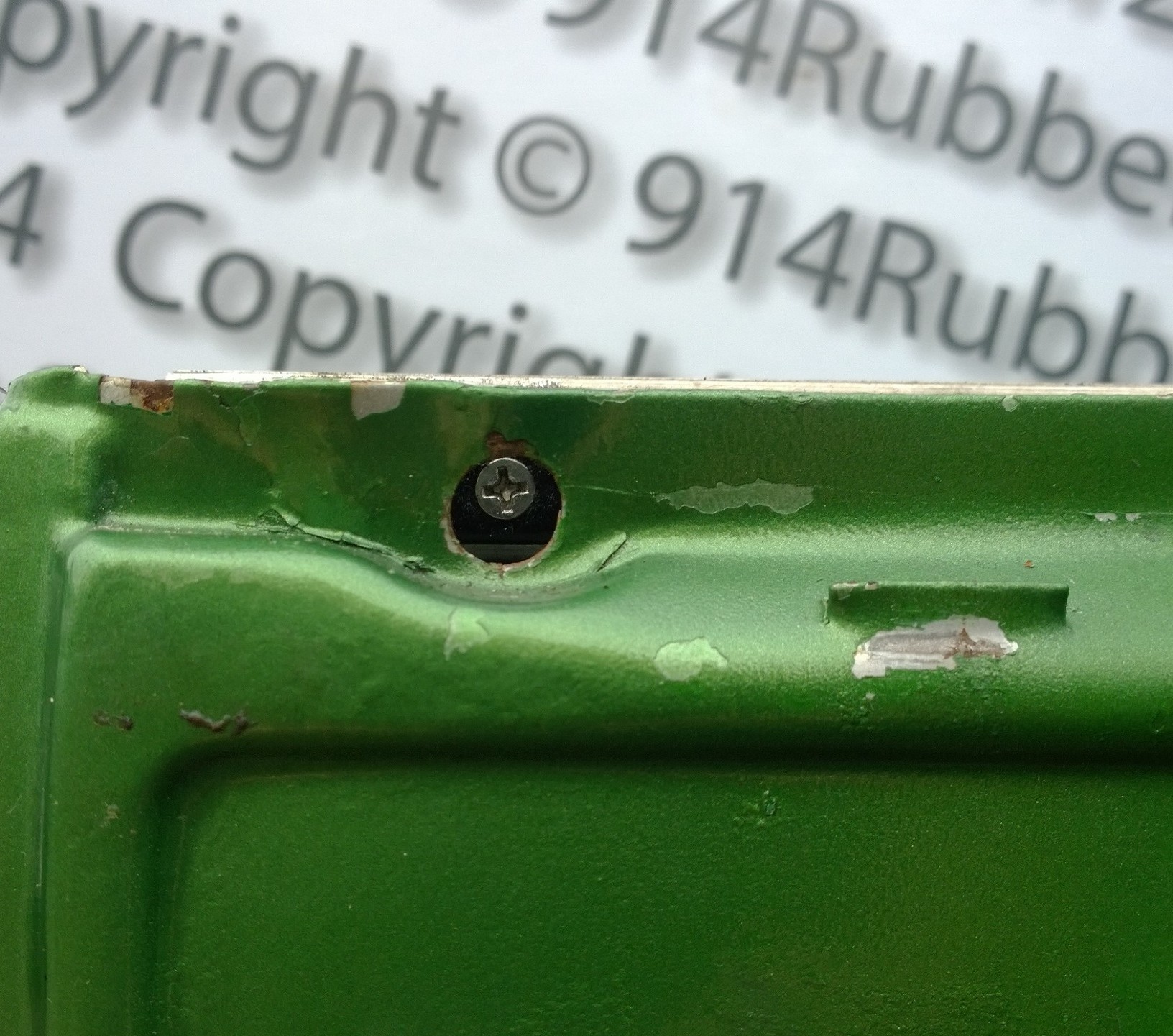

I then removed the rear track by taking the 2 screws out at the back rear part of the door.

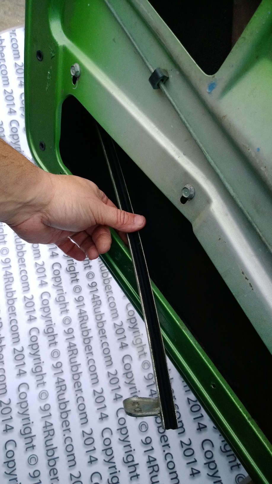

Shown below is the rear window track with the fuzzy installed.

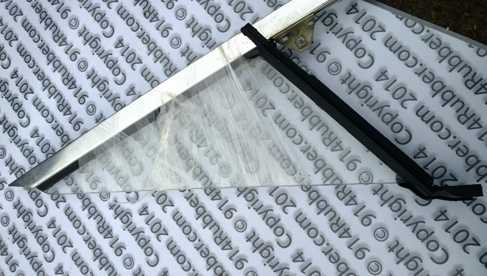

The window will remove by rotating the front down and pulling it out rear 1st.
You will find it helpful to remove the cap from the top of the window, the #2 Phillips will help.

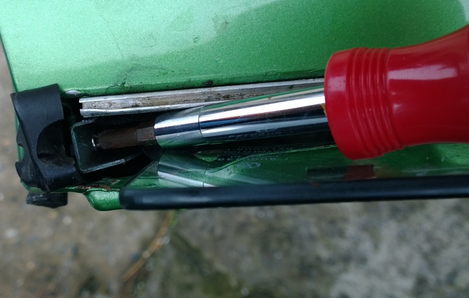

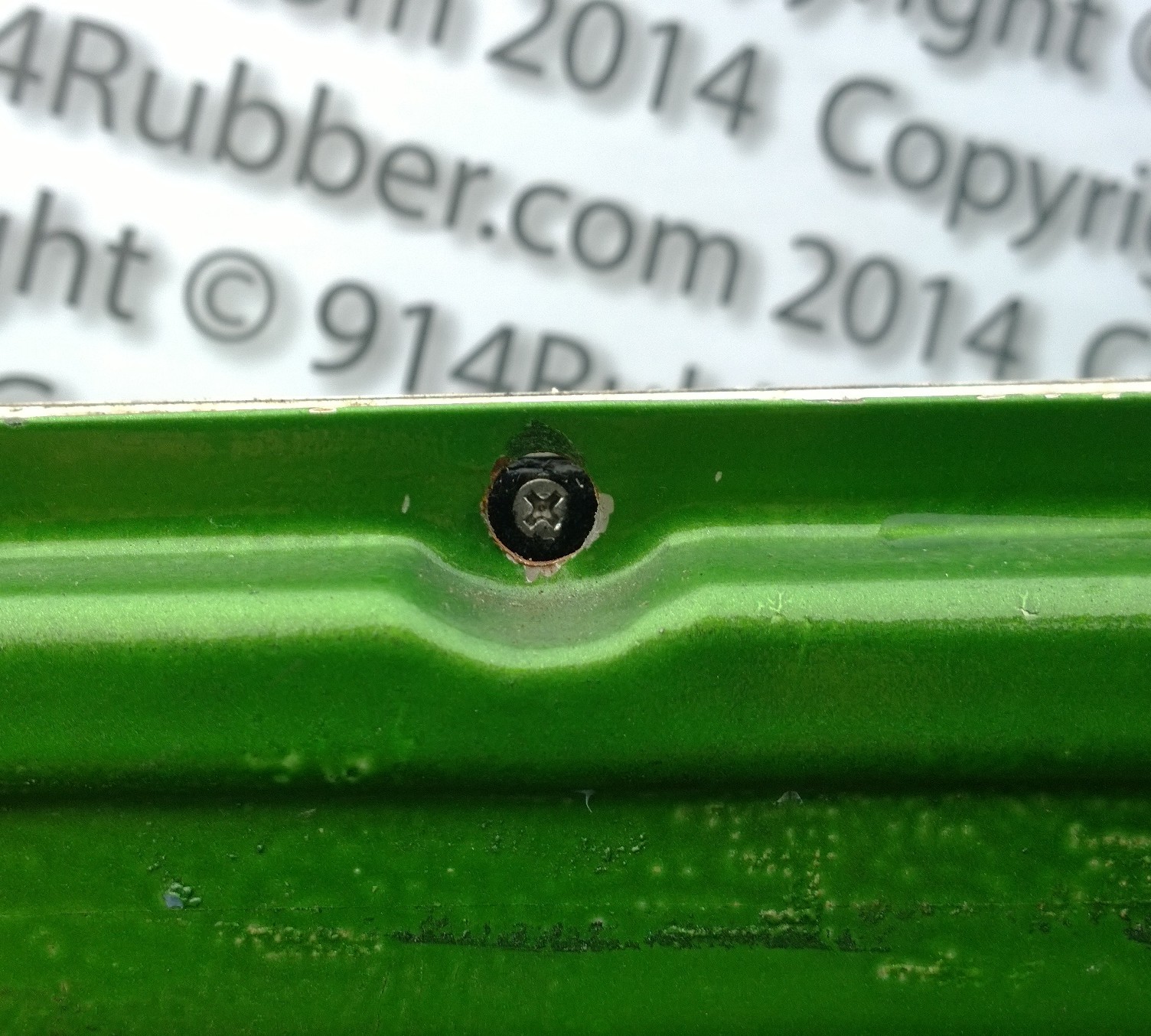

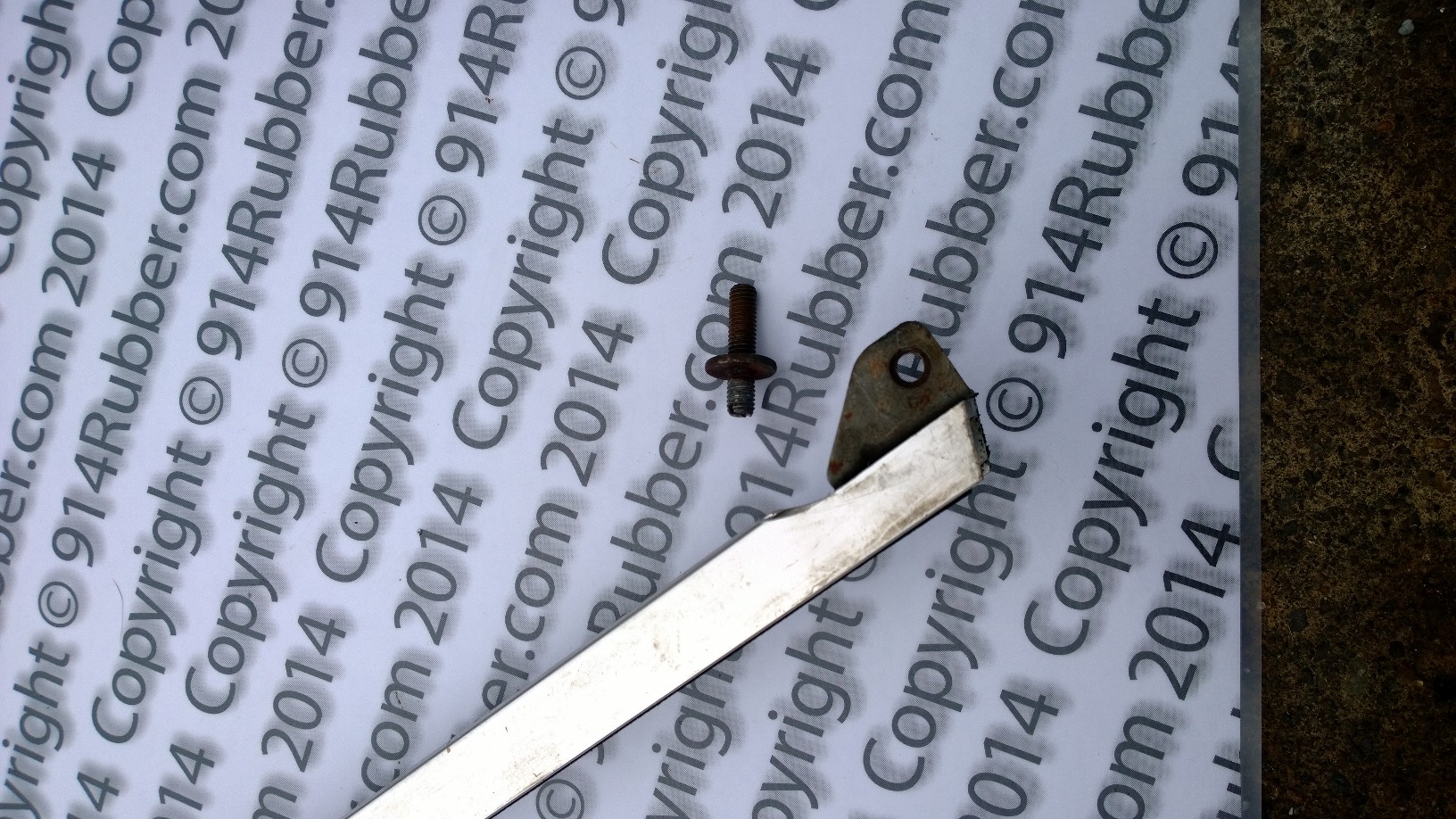

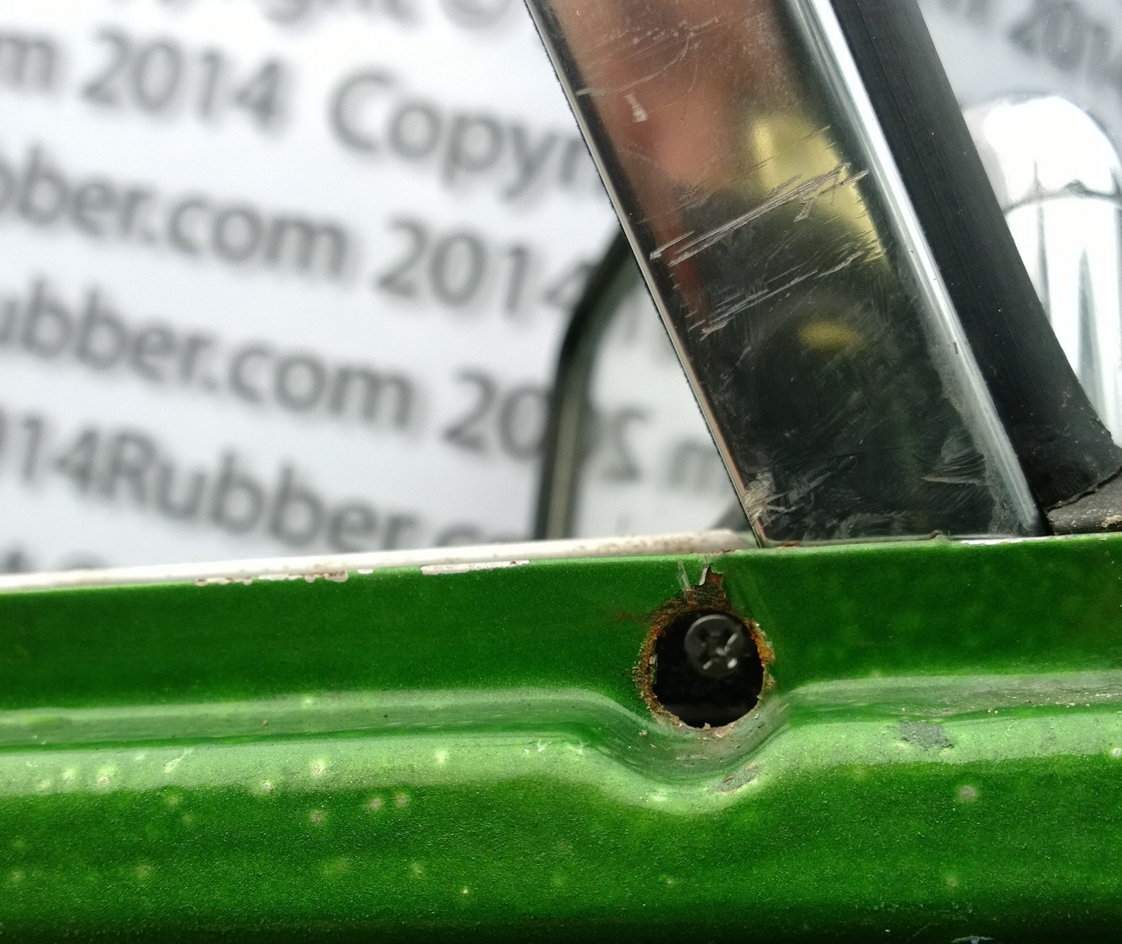

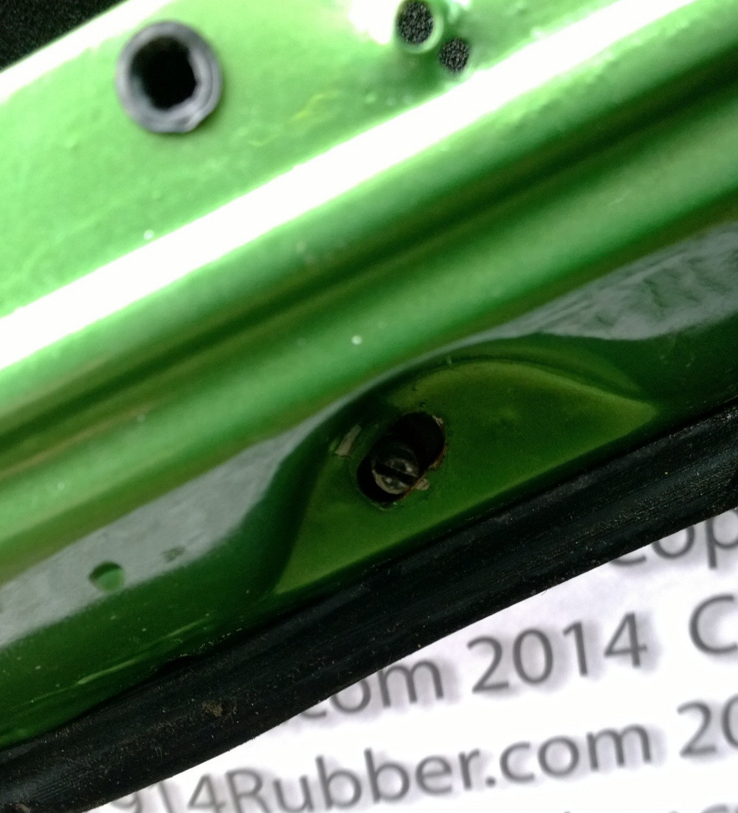

To remove the vertical bar you will need to remove the aluminum track that houses the outer door fuzzy. There are 3 screws with access holes to reach them. I provide stainless screws to replace these with my outer fuzzy set. They are a #6. You may need to drill out the old ones if they are rusted in. Go slowly you may be able to get all out without incident.
Aluminum track removed below

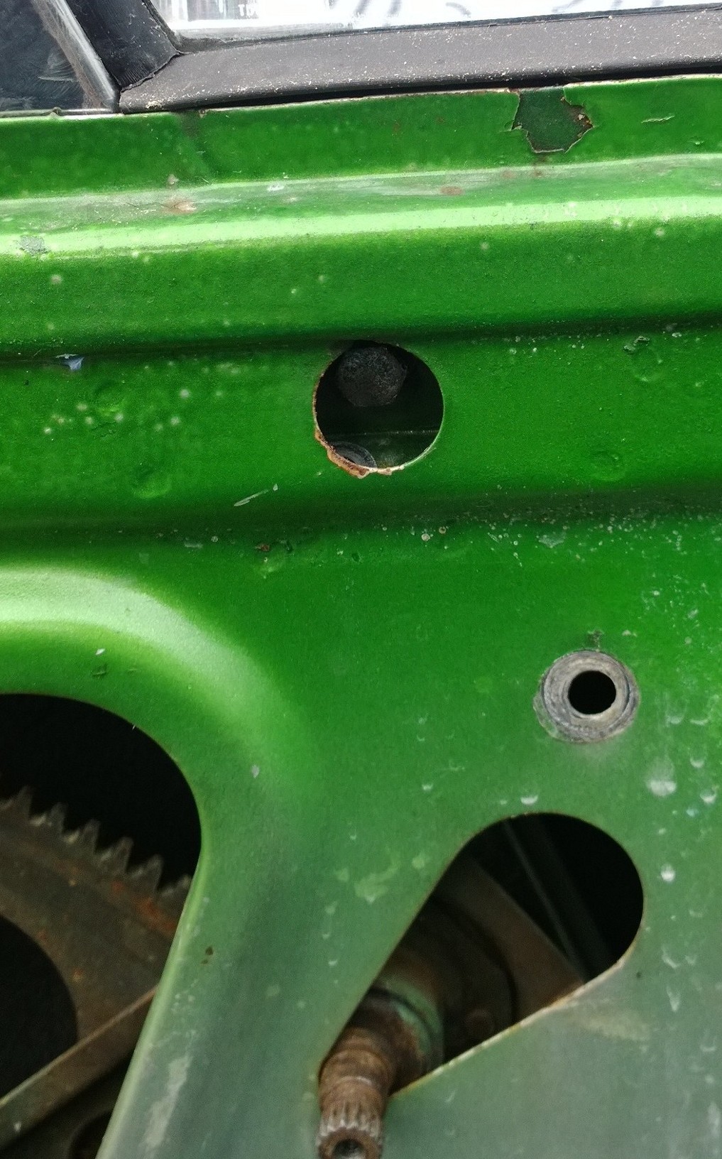

To remove the vertical bar you need to use a 10mm socket to take the bolt out from the center of the assembly. It is recessed in.
You will also need to use the 13mm box wrench to remove the nut on the bottom of the door. After the nut is removed screw the slotted bolt into the assembly. You will need to do this to get it out of the hole it's in. As soon as you get it out remove the screw completely to allow the entire assembly to come out.

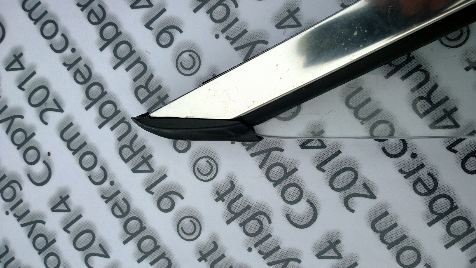

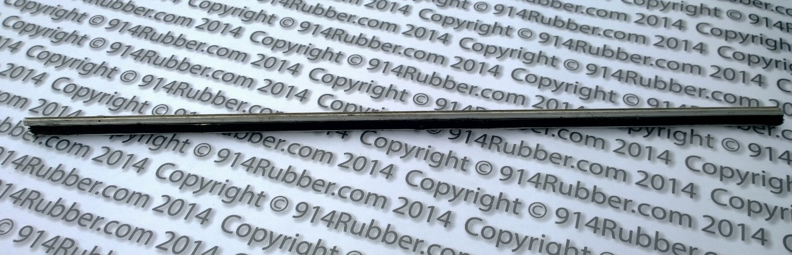

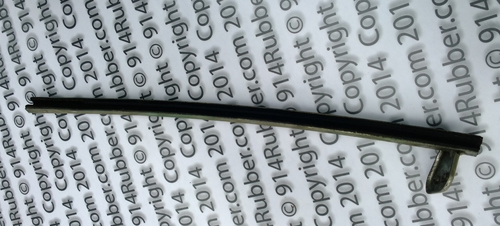

Get the new seal ready I use soapy water to slide the new seal into the track.

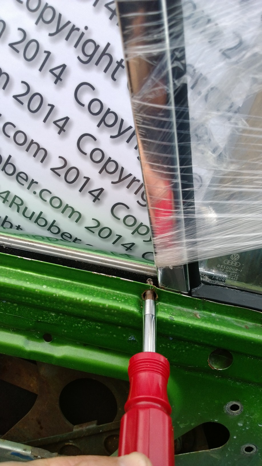

Shrink wrap it to hold in place. Be careful to only use where you will not have issues installing.

Install the base 1st. As soon as the bar is in, put the screw back in the base, just screw it all the way in to get adequate clearance.

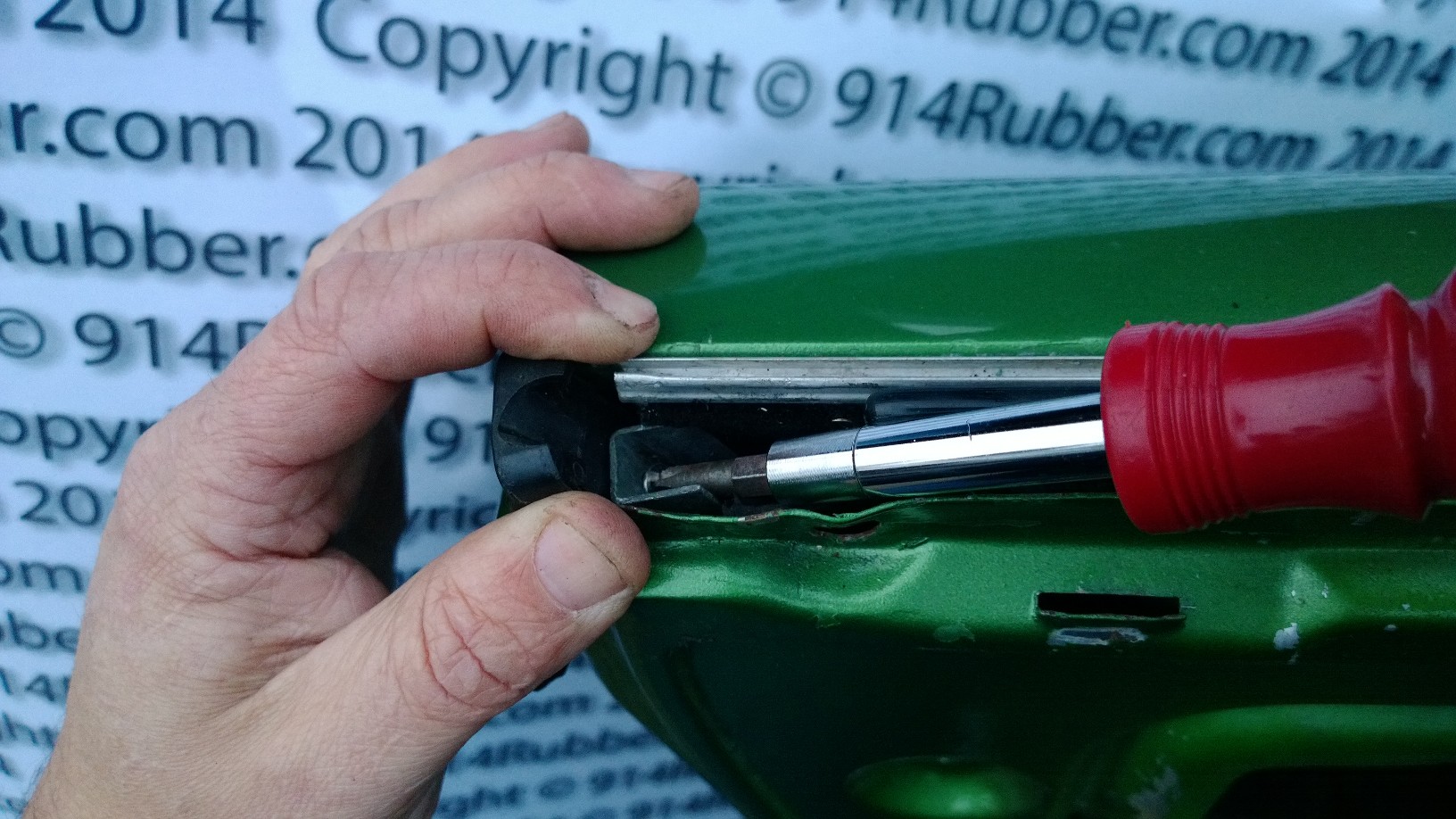

You will need to put the center bolt back in. Push it forward, and push the seal into place. I used a wood block to tap the seal into place.
The factory manual says you can glue the seal to the outer door seal, but mine popped into place after I played with it.

Re install the aluminum track with the outer fuzzy. It you are replacing the fuzzey you can drill through the holes in the track with 3/32" drill to allow the screws to go through and hold the track and fuzzy.

You can then install the glass the rear track is still out and the window mechanism is down so the window will be down when installed.

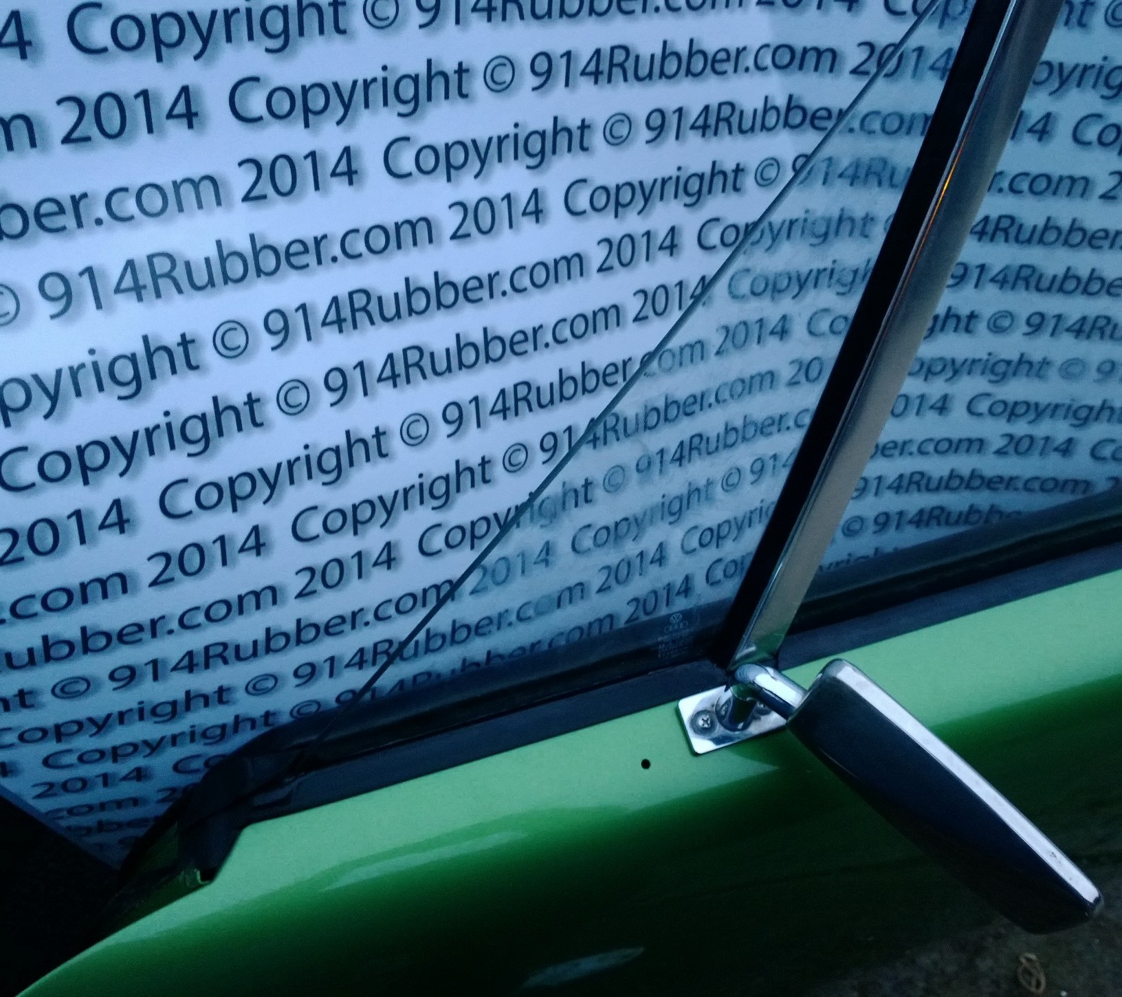

You can install the outer scraper, cut to fit. You will also need to adjust the top of the window using the base screw, and the slots for variation in the door screw areas.
