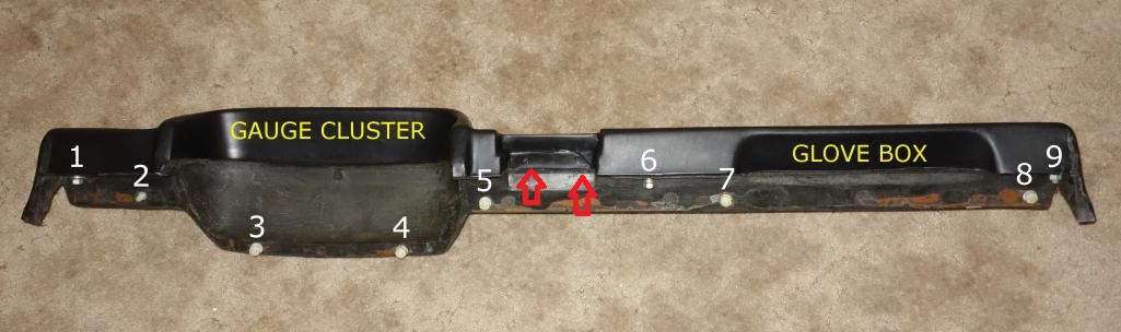

GaroldShaffer
post May 2 2014, 07:00 AM
You bought another 914?
Posts: 7,643
Joined: 27-June 03
From: Portage, IN
Member No.: 865
QUOTE(pdlightning @ May 2 2014, 12:35 AM) *
QUOTE(dlkawashima @ Apr 26 2014, 10:41 PM) *
Thanks for the great pics. All of your hard work makes it a lot easier for the rest of us.
Don't for get there are 2 screws in the ashtray frame that do go into the dash a little bit. You really don't need to remove them, but I always do, sometimes the dash pad sticks to them.
Red Arrows point to there location.
