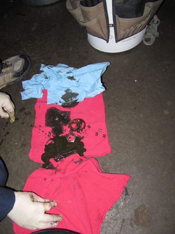

Jeffs9146
post Jun 10 2014, 03:59 PM
Ski Bum
Posts: 4,062
Joined: 10-January 03
From: Discovery Bay, Ca
Member No.: 128
Sounds like a bad bearing!
I had a similar sound on my 6 and when I rebuilt it I found this!!
jhadler
post Jun 10 2014, 04:03 PM
Long term tinkerer...
Posts: 1,879
Joined: 7-April 03
From: Lyons, CO
Member No.: 529
Yep, that's a bearing. I'm sure the Evil Doctor will chime in here on precisely which one it will be...
