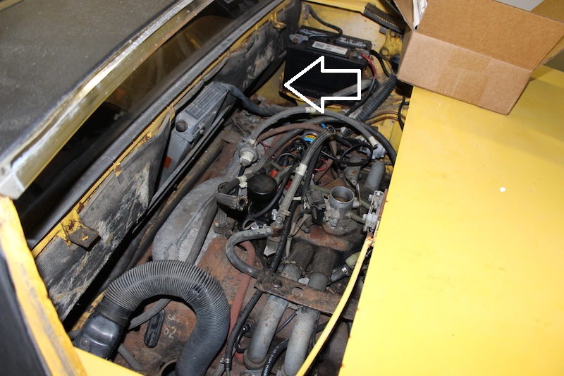

Get the ECU hanger piece so the the ECU hangs off the battery tray instead of tucked in the sound mat. The Decel valve mounts above the MPS under the battery too.
Car needs some welding love but lots of metal parts are out there to fix this car if you have the time.

QUOTE(Bleyseng @ Jul 9 2014, 07:55 AM) *
I have noticed that on other cars as well but I don't remember where my 72 ECU was located.
I believe the current location is due to the AC compressor, does that sound right? Maybe not enough room.
Is there a problem with the current spot other than something flying off the fan and taking it out!!!
A lot of welding to come!!!!
Where to start!

And I agree you should move the ECU back...just not a great place for it. The stress on the wires is also not good. It goes here....looks like there's room. As Rick said get the bracket or make one.

QUOTE(Chris H. @ Jul 9 2014, 08:04 AM) *
I had an AC equipped car a while back. If I remember correctly I tried to mount the ECU with the correct bracket and it interfered with the AC compressor. Maybe I did it wrong, but I'm 90% certain it's not going to work. Mine was attached further up on the firewall with two little L brackets.
Chris H.
post Jul 9 2014, 11:58 AM
Posts: 4,079
Joined: 2-January 03
From: Chicago 'burbs
Member No.: 73
Maybe the battery tray can be moved back?
