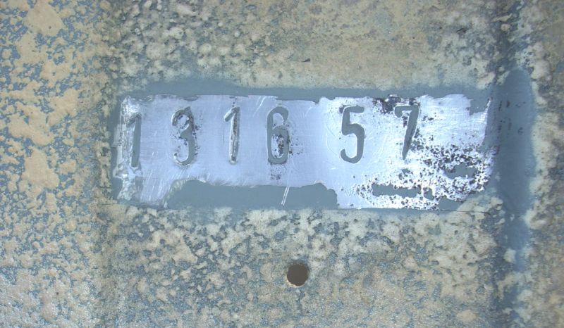

the 13xxx is the Karman body number and has no direct correlation to the other numbers but since the cars were apparently assembled in some sense of numerical order, we can deduce the correct range of engine, trans and '043' numbers. .
My Vin is 9140431617. .
My Karman number is 131657, being 40 above the Porsche Vin number. . and interestingly my trans number corresponds exactly to the Karman number, mine being 7501657
Also, when I pulled my dash out, there was no number written on the bulkhead as I expected. I did have a blue painted dash panel on a silver car, much like others have found in mismatched paint for their dash panel.

The chassis # in the 914/6 is a variation on the chassis # or production # used on the 911 & 912 since the beginning of the 1969 model year. The dash also got the same number, however in the early cars they apparently did not match for much of the year. Another difference is the 914/6 chassis # was missing the year digit while the dash did not. For 1970, or most of it, the chassis # was centered in the trunk, then for 1971 it moved to the right side, and gained the year digit. At least one 1970 (a sporto) got a 1971 chassis.
The first digit (1) means it is a production chassis; if "0" then a replacement chassis
The second digit (3) denotes a Karmann 914/6 body type.
The third digit is supposed to be the year.
Finally 4 digits for the sequence #.
