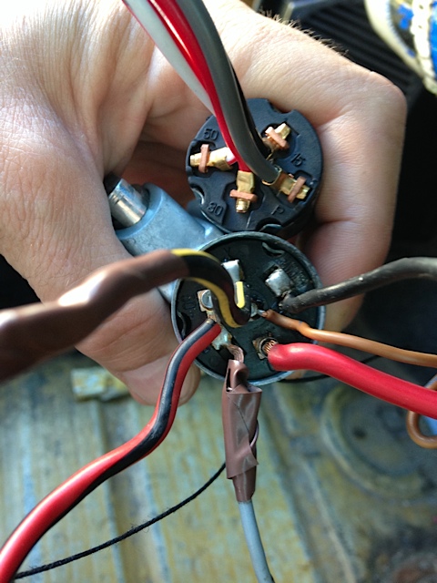

Looking find or restore the electrical end of the starter cylinder, where the black disc with the six contacts meets the copper bit has become separated. There was a tiny bit of corrosion and the switch malfunctioned. The lock and Key seem to be fine.
I left the roof off and rain got in there. (doh!) So I took everything apart to investigate the switch and contacts may be okay but its hard to tell a tiny spring popped out of somewhere, the other tiny spring is still in the center. The wires have been cut and soldered twice before reaching the 20 pin connector so someone has been in there before it looked kind of scrappy so I will make clean connections.
The car is a 1971, later build.
Secondly I want to drive my car since it is otherwise running like a top ( Thanks to Chris and Co. at Tangerine : )
Any clues on how to hot-wire it or add a temporary switch?
Here is a list of wires:
1. Red (Has a tiny burn mark on contact side)
2. Red and Black
3. gray
4. Black
5.Black and Yellow
Brown ( becomes Brown w/blue stripe)
thanks guys!

Here is the 1st issue I have with the replacement part: It has 2 LESS wires.
Old one has 6 new one has 4.

Member No.: 8,085
2nd issue: With the new part (on right) rotating part does not line-up in the same way as the old part. ( left )
The pin and the rotating part do not align in the lock cylinder, the new part does not "seat-in"
When I attempted to install it got a bit smushed ( see photo )
Then I discovered it is wrongly aligned to the spec's old part.
My car is a 1971 so it has some differences to the later years.. Might this new part might be for the 72/73-76 model years?
