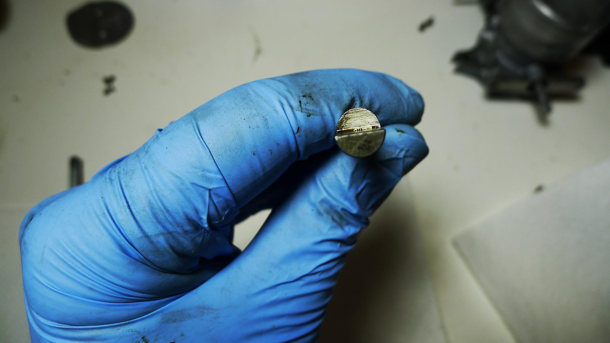

I tried it but ran into an issue with the orientation of the flat on the shaft that engages the throttle body switch component used with L-Jet.
Pictures are worth a thousand words, so here goes..
Here's the TPS and a picture of each TB with the plate in the throttle closed position. Original 1.8 L-jet on the right, Vanagon donor TB on the left. Notice the different orientation of the flat on the shafts. The flat engages a corresponding flat on the TPS. The flat on the Vanagon shaft is in the wrong position for the TPS.

I didn't want to simply make a new flat on the bottom of the shaft where it engages the TPS because there is already a flat on the other side. That wouldn't leave much metal. Also, I think it would be difficult to exactly duplicate orientation of the factory flat. I put a multimeter to the TPS when it was installed on the TB and found that the switch engages pretty precisely at closed and WOT. I don't think I could duplicate that exact angle by eyeballing it on the bench grinder.

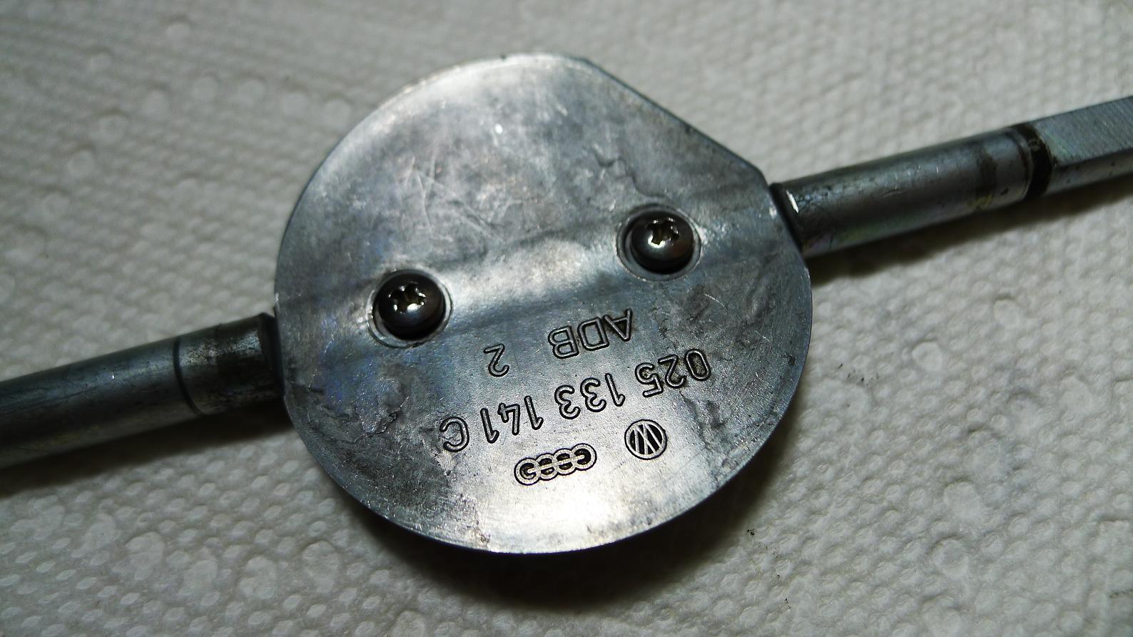

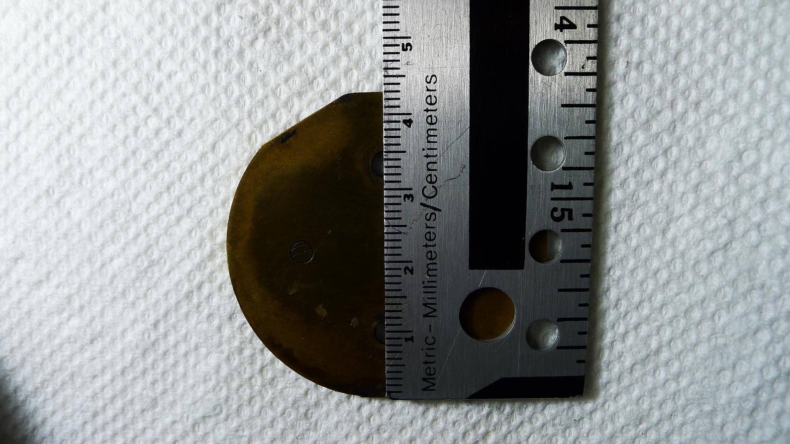

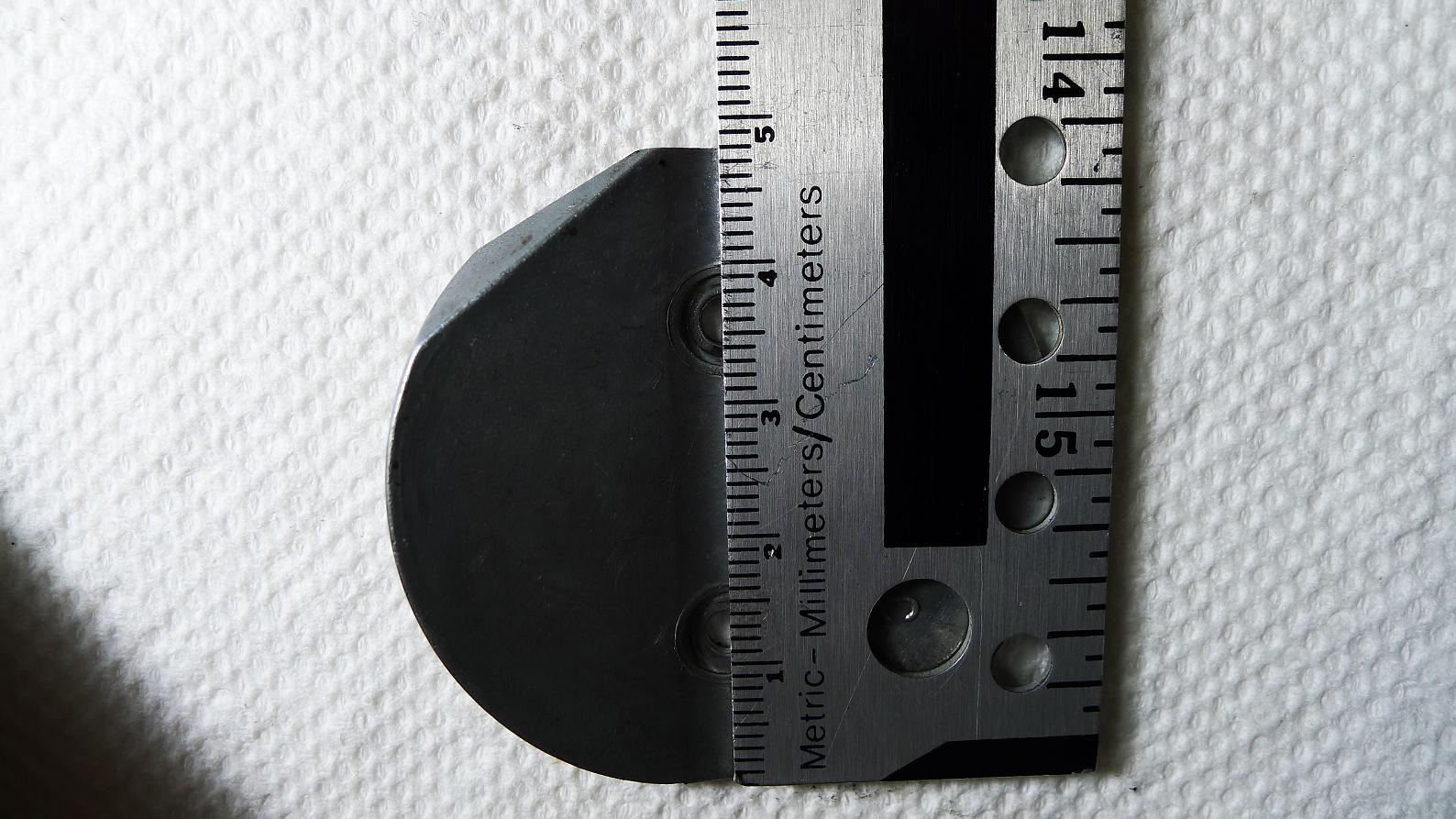

So I decided to use the shaft from the 1.8 TB. Only problem is that the recess in the shaft is sized for the smaller TB plate.
The 1.8 plate is 43mm in diameter, the vanagon plate is 48mm.

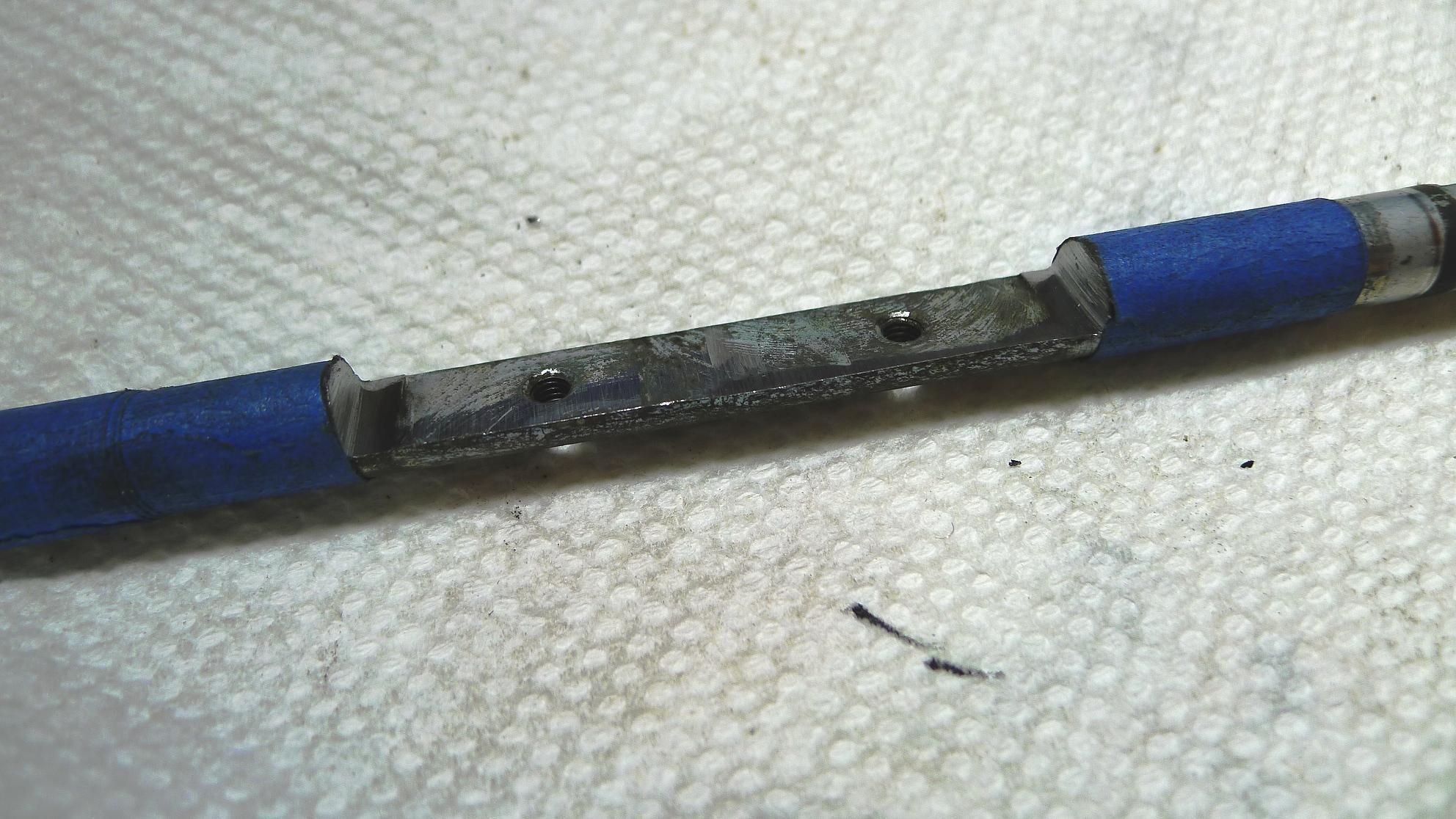

So I decided the way to go was to lengthen the recess on the 1.8 TB shaft to fit the vanagon TB plate. 2.5mm on each side would do it. So I measured and taped it off to guide me with the bench grinder.

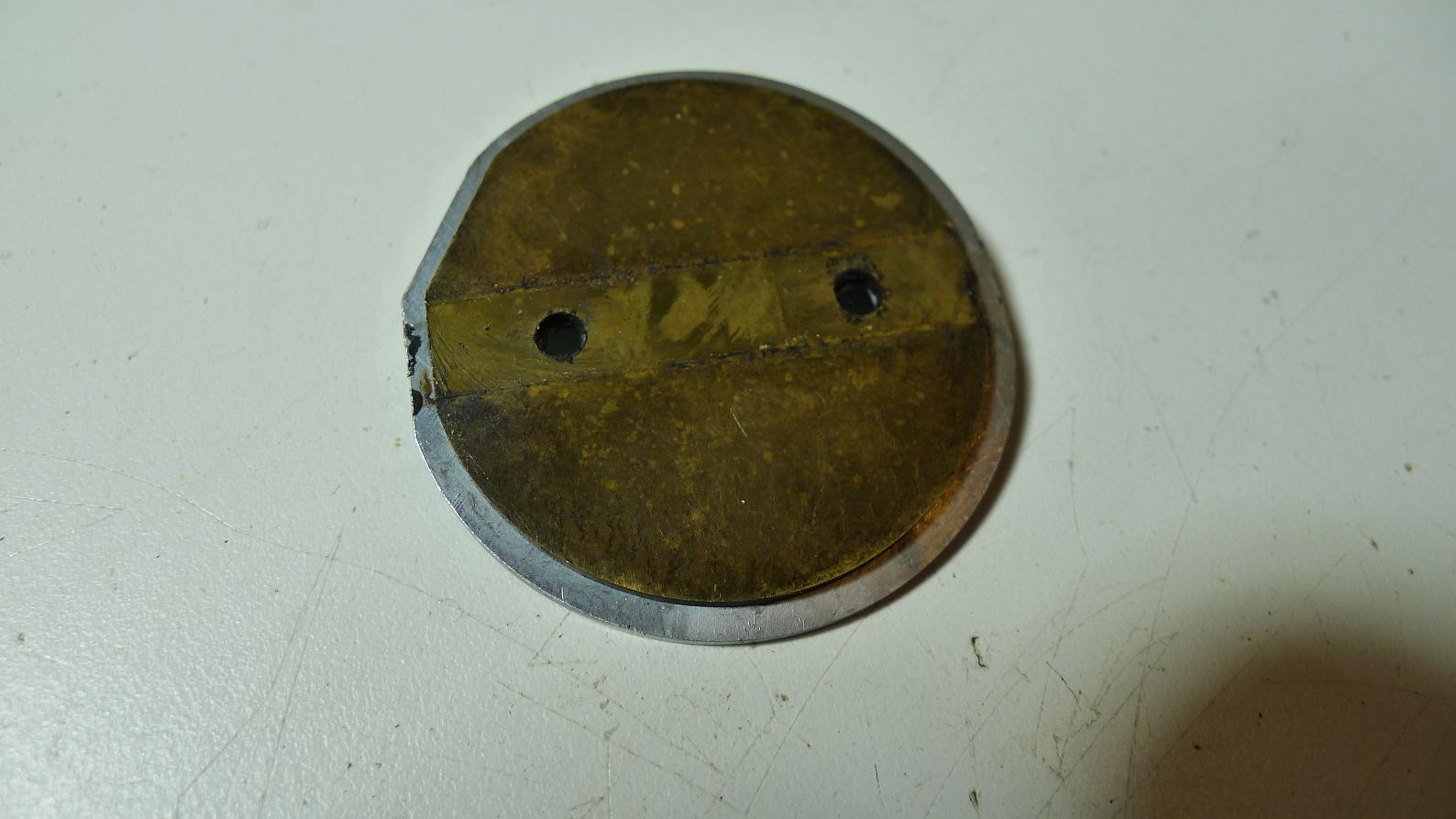

Five minutes of careful grinding on each side was all it needed. What a great thing that VW/Porsche used the same spacing between holes for both TB plates.

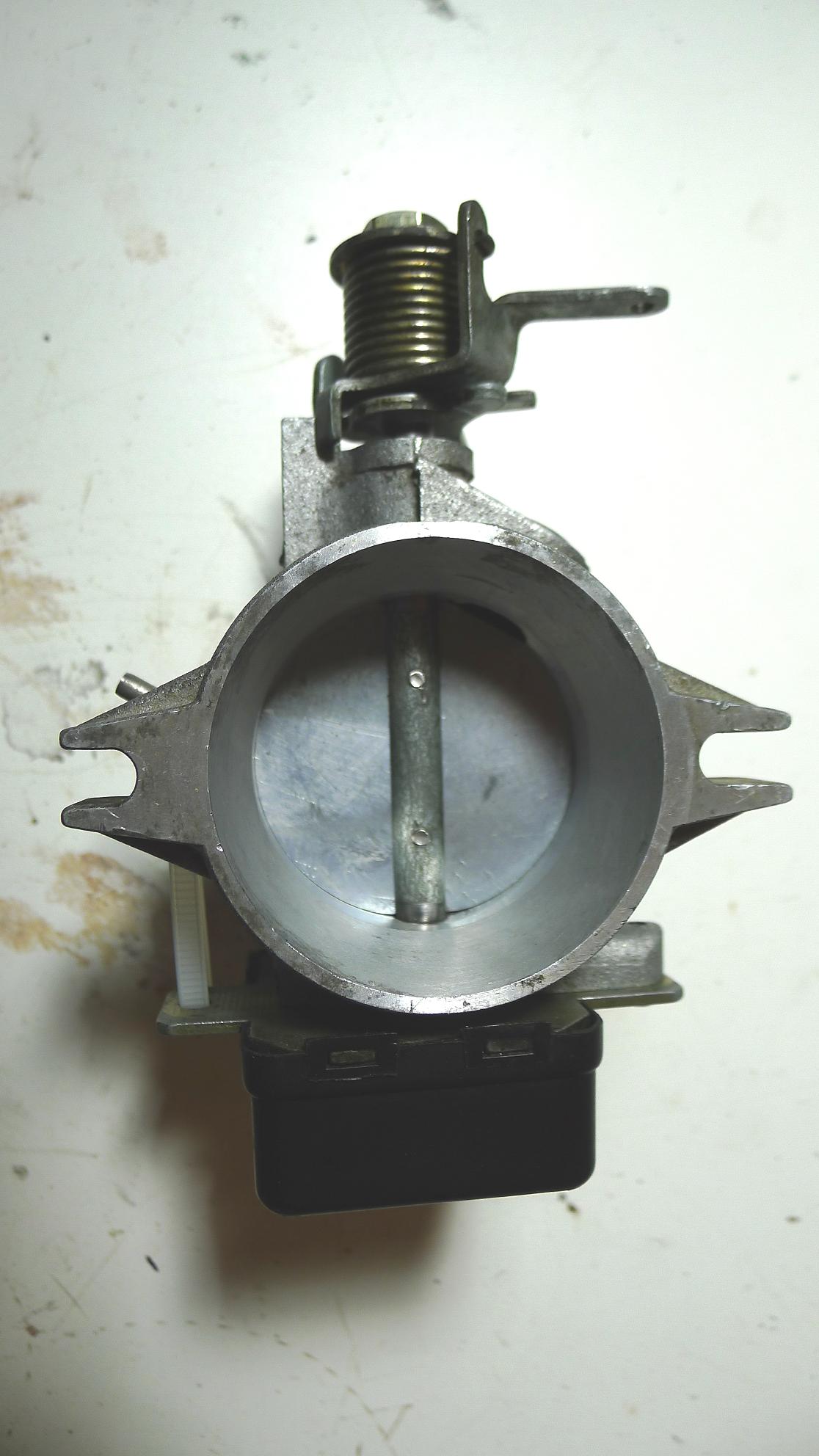

And with that, I inserted the modified shaft in the Vanagon TB, attached the plate, assembled the spring mechanism... and I now have an enlarged TB that will fit the 1.8 L-jet system (for use on my 2.0 engine).
