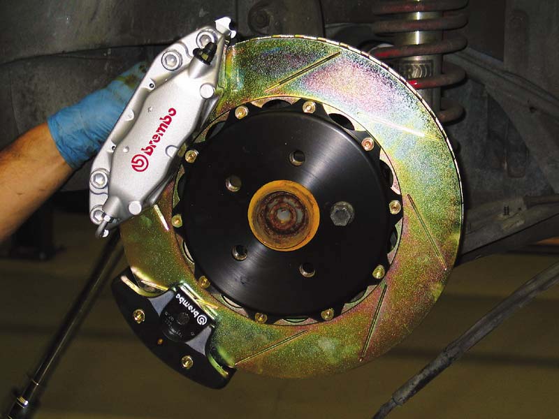

Doing some "surf'n" and came across these being installed on an Audi A4
I never knew that they made a parking brake caliper...

one more shot.....

Mueller
post Feb 1 2005, 09:52 AM
914 Freak!
Posts: 17,155
Joined: 4-January 03
From: Antioch, CA
Member No.: 87
i'm still not sure why we're not investigating using VW GTI/GLI rear calipers, but since i haven't done it either, i have no idea the mounting issues. they stopped the car and had good e-brake / parking brake performance.
"someone" is (IMG:http://www.914world.com/bbs2/html/emoticons/smile.gif) ...that is how I found these pictures...aluminum caliper with built in parking brake....I should get my sample next week I hope....

Sorry boys, I have some dis-hearting numbers...
i've also been working on a bolt-on spot caliper kit, and durring my research the Brembro's came up around $700 each! The hot ticket would be a Willwood spot caliper, but i've been working on making a few myself.

QUOTE (BigD9146gt @ Feb 1 2005, 10:15 AM)
I found the Brembos for $300 each.....ouch, still too much...the pads are another $80 or so per caliper....damn.....
The problem with the Wilwood Spot calipers is that they are only for a .38" width rotor, so if you want to use it outboard on vented rotors, you'll have to open it up and make custom spacers....adding to the cost of the conversion.....
