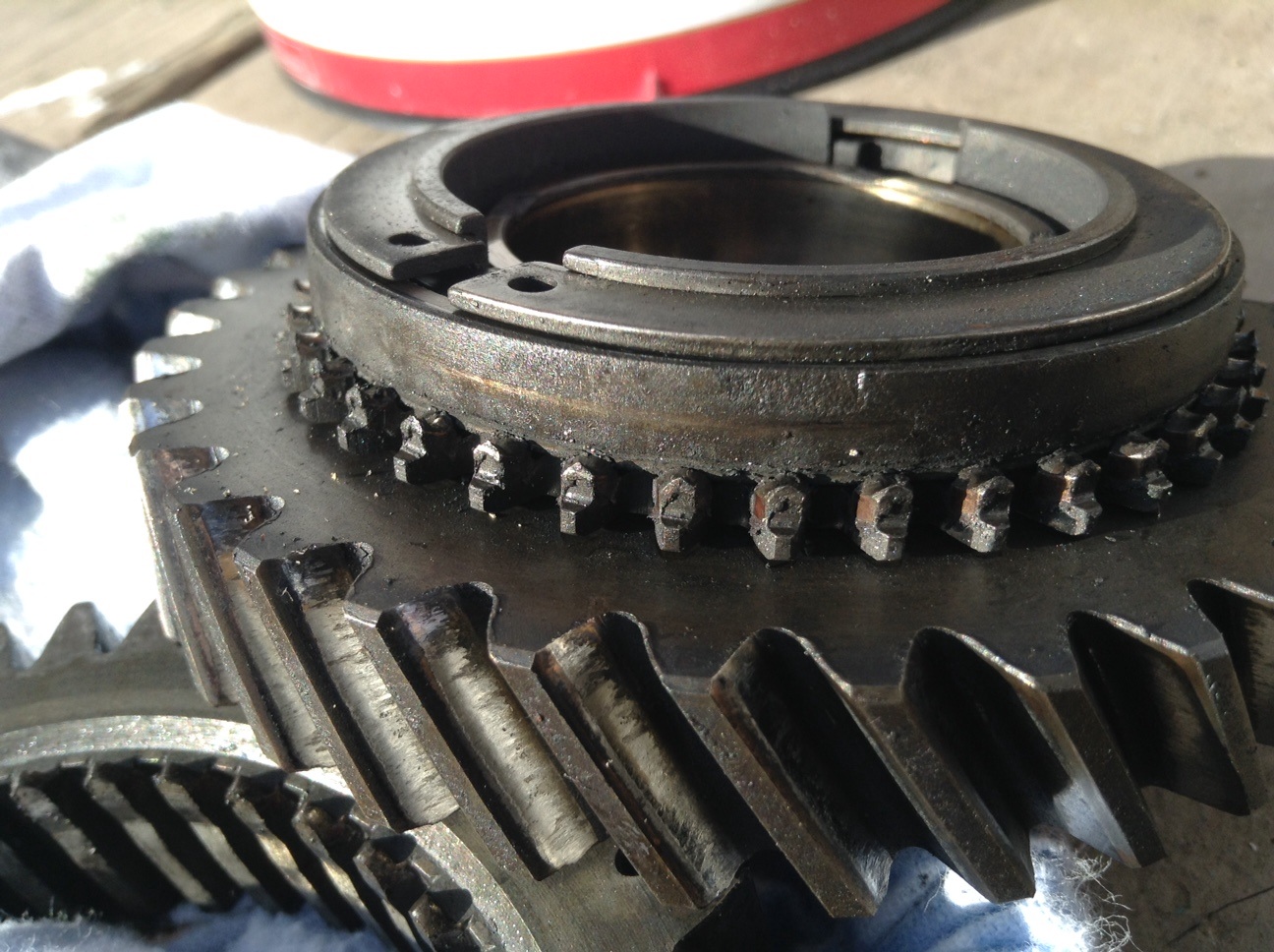

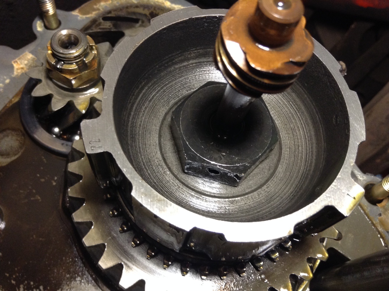

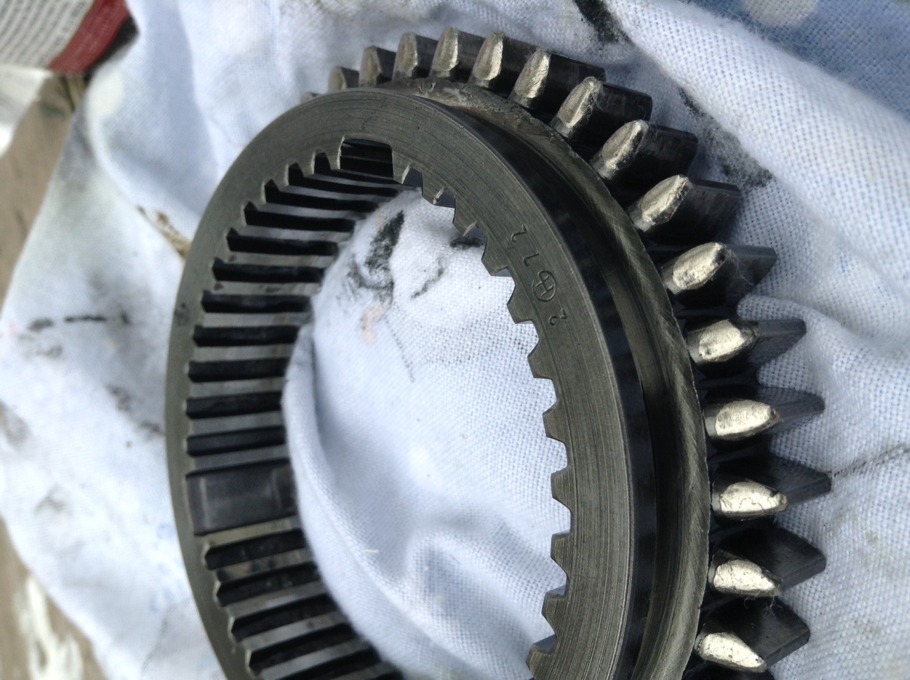

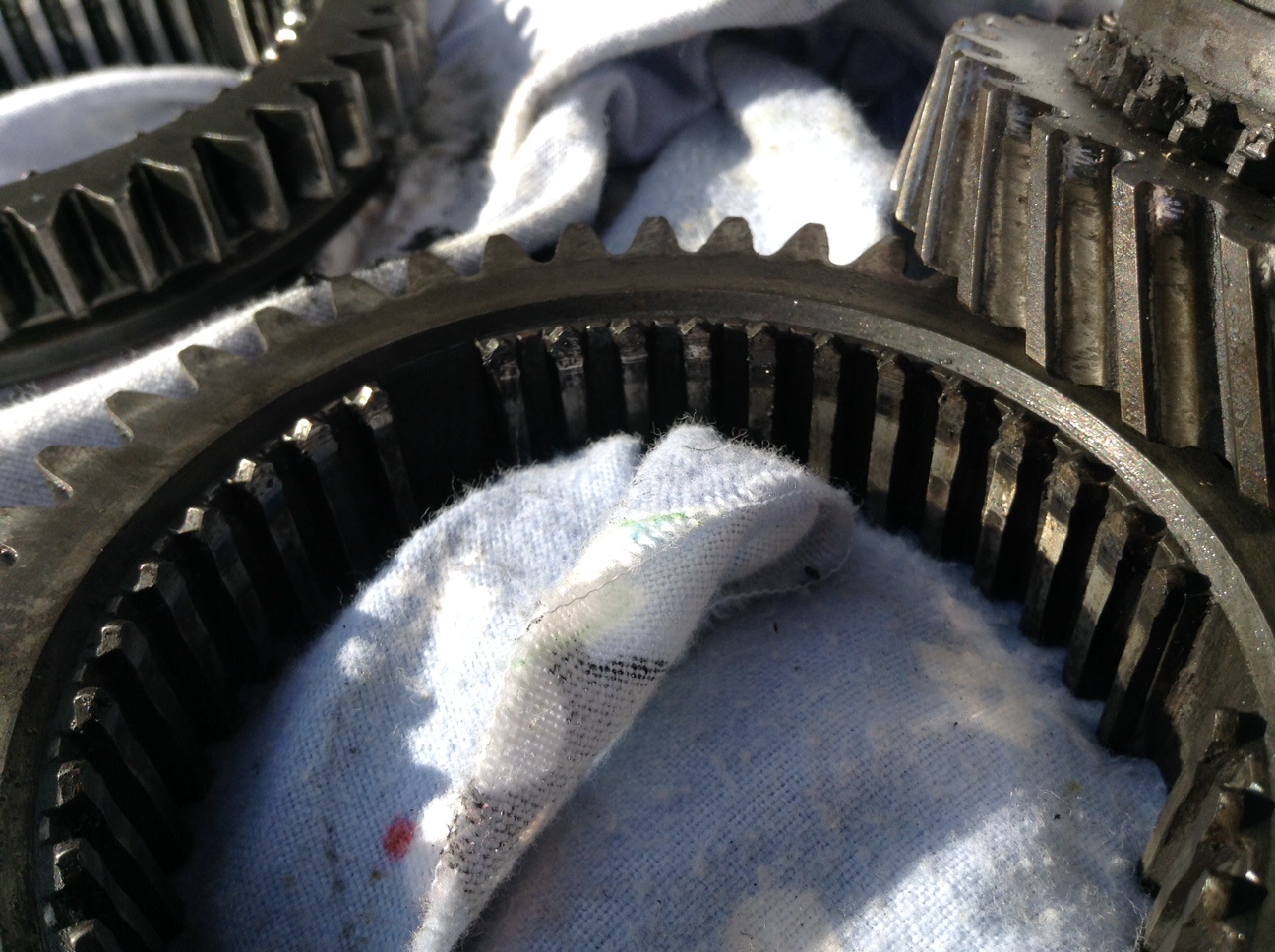

Ok so George,Thepaintedman, inspired me to tear into my transmission. The pictures show what I found, looks like I need a new first gear slider and dog teeth??? Are the parts I need going to be the same out of a side shifted transmission?
I was also wondering how to get the gear off that is still attached to the transmission. Looks like the large nut in the center needs to come off but I don:t know how to remove the speedo drive gear to access the nut.
Attached Image Attached ImageAttached ImageAttached Image
Bartlett 914
post Jan 18 2015, 02:48 PM
Posts: 2,218
Joined: 30-August 05
From: South Elgin IL
Member No.: 4,707
Looks pretty bad. Dog teeth and no doubt the slider are bad (you should show a picture of the other side of the slider). So where did all that metal go? The whole gear box should be gone through. You will need special tools to do this repair. Send it out would be my suggestion

After a look at your photos I would suggest a complete tear down. You may be lucky, but first completely failed, so how far is second? You may get lucky with the higher gears, but looks like the new transmissions are a good idea. Good luck!

all is not lost; you can repair 1st/reverse slider with limited disassembly; you will have to remove that gear stack, and it looks like you're halfway there. read the Birdboard's write up to help get you going in that direction
http://www.pelicanparts.com/techarticles/9...anny_repair.htm

Yea, I realize I'm cobbling it together for now. I'd like to try replacing the first gear parts to buy some time. I don't want to invest money in this trans because I'm real close to a side shift conversion. In the mean time I'm riding my motorcycle 50 miles each way to work in the fog and freezing my butt off. I just cracked open the core and the parts look better. I'll pop some pix this afternoon.looks like the speedo drive gear is held on with a roll pin?

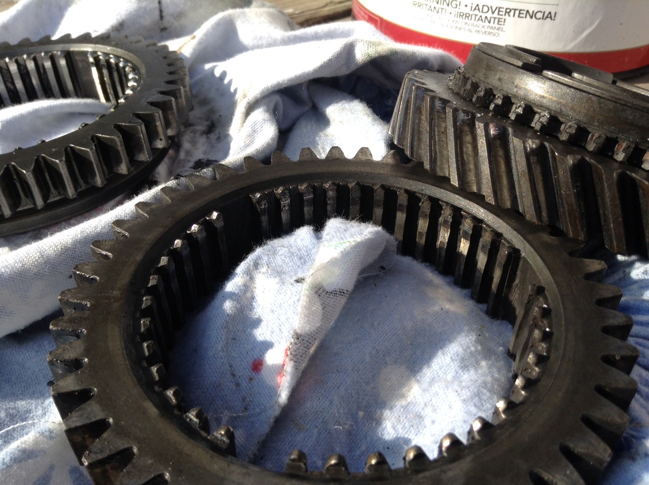

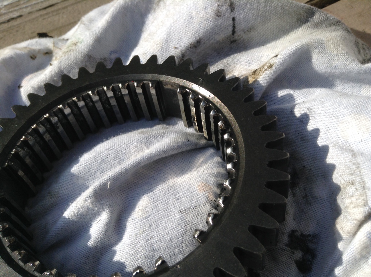

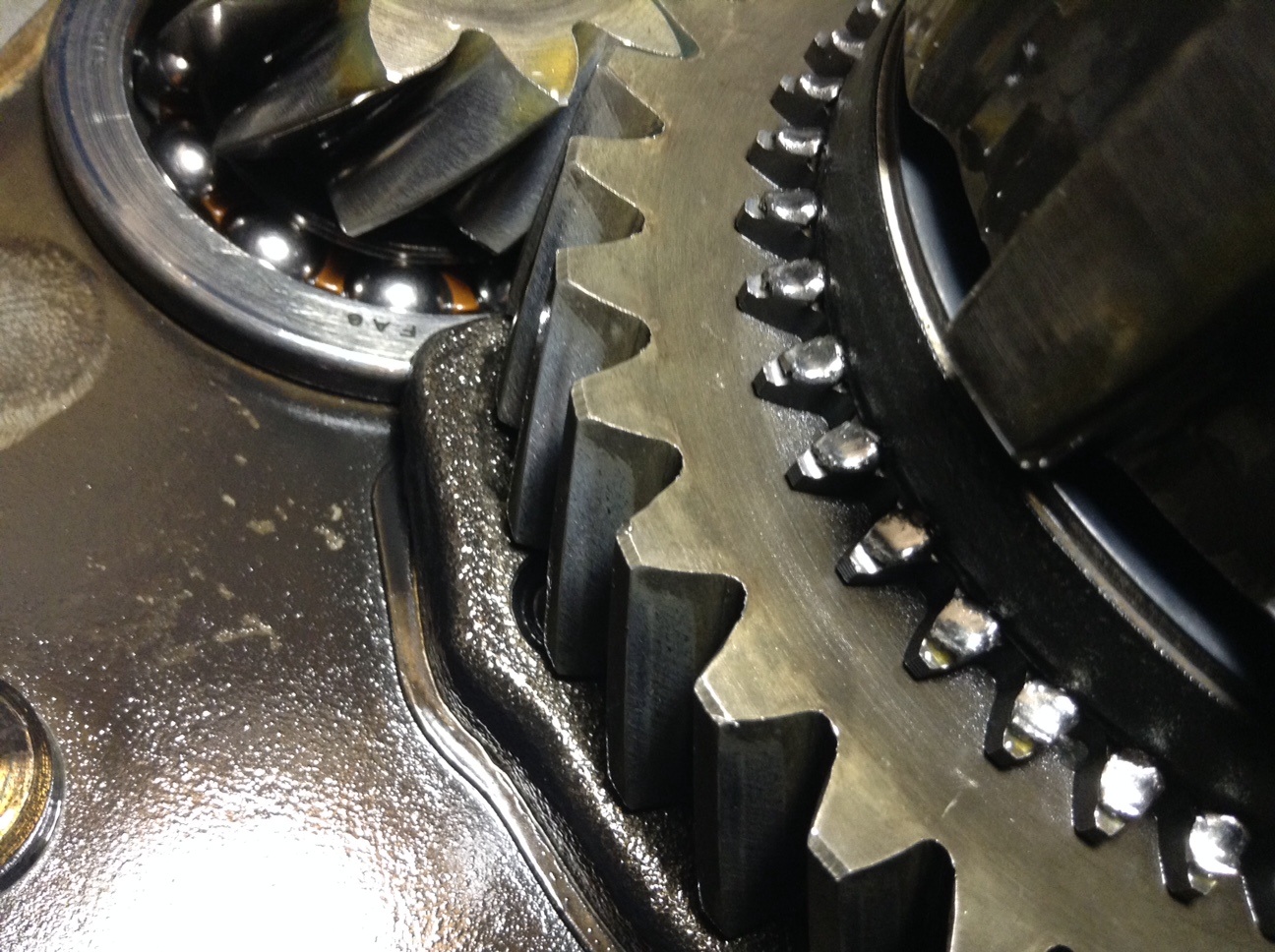

I got the parts out of my core transmission. They look a lot better to me, let me know what you guys think. The last picture is a picture of the slider that came out of my current trans.Attached Image Attached ImageAttached ImageAttached Image

That slider looks useable, clean it up to be sure. The teeth are done. How is the band? Looks possible good in the pic of the original one. That would be weird, but may have led to you issue. Maybe the band and block on the inside failed.
