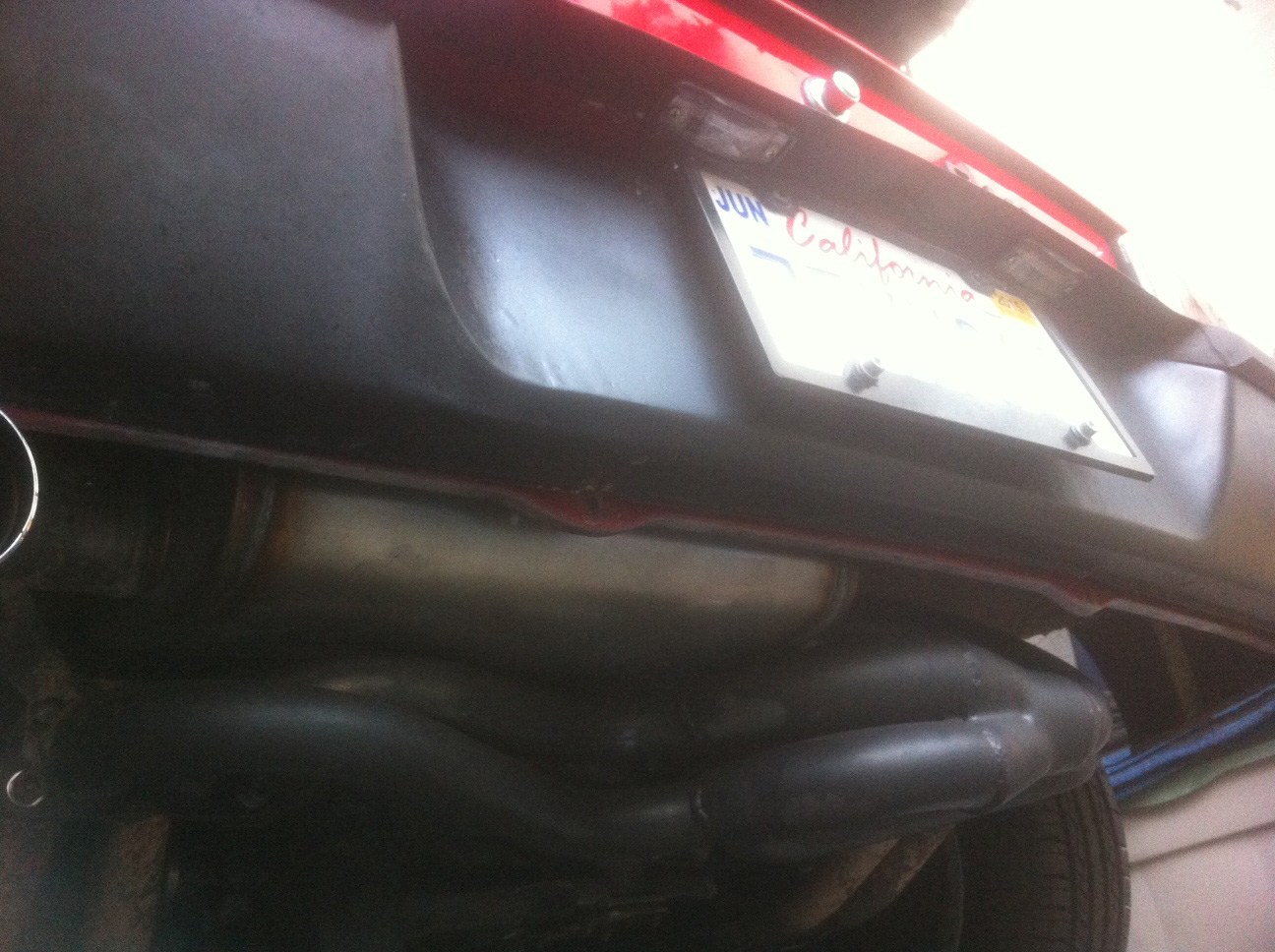

The MagnaFlow came in to my place in Laguna inone day from NV / Summit and was a perfect fit after whacking off 1.5 inches of the tail-pipe end to line up with my rear valance.
The muffler needed no ballpeen adjustments to slide onto the Bursh pipeworks and fits neatly within the space provided in the stock 914 heat shield arrangement.
The sounds now emanating from my tiny wisp of a 1.7 engine is 150% better, less raspy, more throaty, more manly, and mainly more tolerable by all humans, cats and dogs within earshot of the re-teener.
Now for the wait time to evolve further for the 2.2L build to complete....... that should redefine throaty and manliness.......
Special Thanks to Larmo for the relay to this thread......... mine now sounds bigger than his (IMG:style_emoticons/default/bye1.gif)

The welding was the easy part. On my 71, I have the snow-shovel rear valence so I wanted to line up the tail pipe precisely with the existing valence-hole. I sliced off 1.75 inches of the exit-side of the pipe then mated the muffler with the Bursch header(?) assembly then inserted the Bursh tail pipe / then mounted the whole assembly to align all three pieces. The fit is good and tight so I was able to tap each piece into alignment, then bring up the valence to confirm the hole-shot, then remove the muffler and pipe assembly as one unit, put it on my work bench and weld it up. I used my Lincoln wire-feed (no gas required) and found that the muffler metal was softer than the Bursh pieces. Continuous welds around the two pipe connections were completed. The an adjustment to the supporting tab on the tail pipe was made for its new relationship to the MagnaFlow muffler was welded into place.
I bolted it up to the car, fired it up and two of my neighbors popped out of their bunkers, brought over bottles of wine, and listened to the music.
