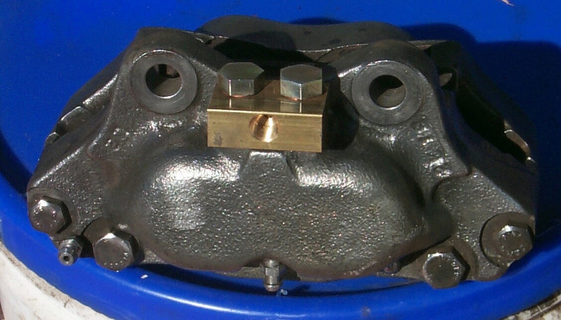

Alright here is the skinny onf the Volvo Calipers:
Come from a 190 and 240 early 80s to early 90s
There are two kinds. Vented and non Vented.
The calipers I have are Girling, have not inspected the ATEs.
They have a 3in bolt pattern on the calipers.
The non vented calipers sit .050 off the centerline of the tock rotor, towards the wheel. You will have to shim them back a little.
The vented calipers will work with a .810 rotor.
Both calipers are the same as far as major dimensions . The vented caliper is not machined as much so it is thicker.
All volvo calipers are dual circuit. They will require an adapter block or a set of custom bent hardlines to be fed from a standard master.
The calipers will overhang the edge of the pads. They will work perfectly with an 11.75 aftermarket rotor. You can either machine the pads or take just deal with the over hang.
I have an aftermarket aluminum hat and vented cast iron 11.75 x .810 rotor that will work perfectly with the Vented caliper on the stock 914-4 cylinder strut (haven't test the early struts). To make it fit, the hub centric ring will have to be machined from the hub or open the hat up to clear the ring. (did want to mess up my prototype). The hat will slip over the existing hub giving you a 1/4 wheel spacer. Don't know if Fuchs will clear the fender wells, yet. I am still in the prcoess of developing this one for my top secret project but will be testing in a street car soon. I figure it will need a 23mm master cylinder. Might be able to use the stock 914 front calipers on the back or even run the Volvo calipers on the back. Haven't gotten that far yet. I haven't tested wheel fit as my steel wheels have all kinds of room for calipers. Don't know about alloys yet. There is plenty of material to clearence the caliper though.
Questions?

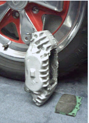

type47fan
post Feb 11 2005, 09:20 PM
It Looks Better In Person. . .
Posts: 860
Joined: 17-September 03
From: Carlsbad, CA
Member No.: 1,170
How about these?
