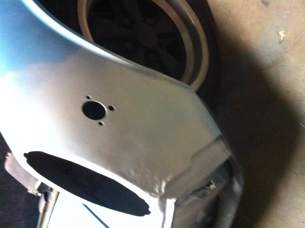

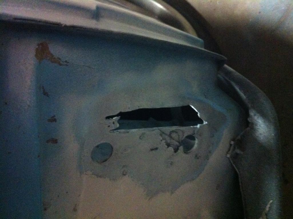

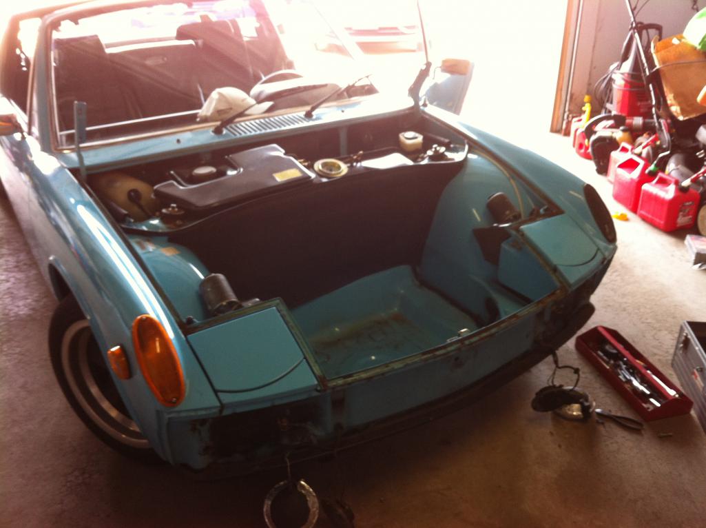

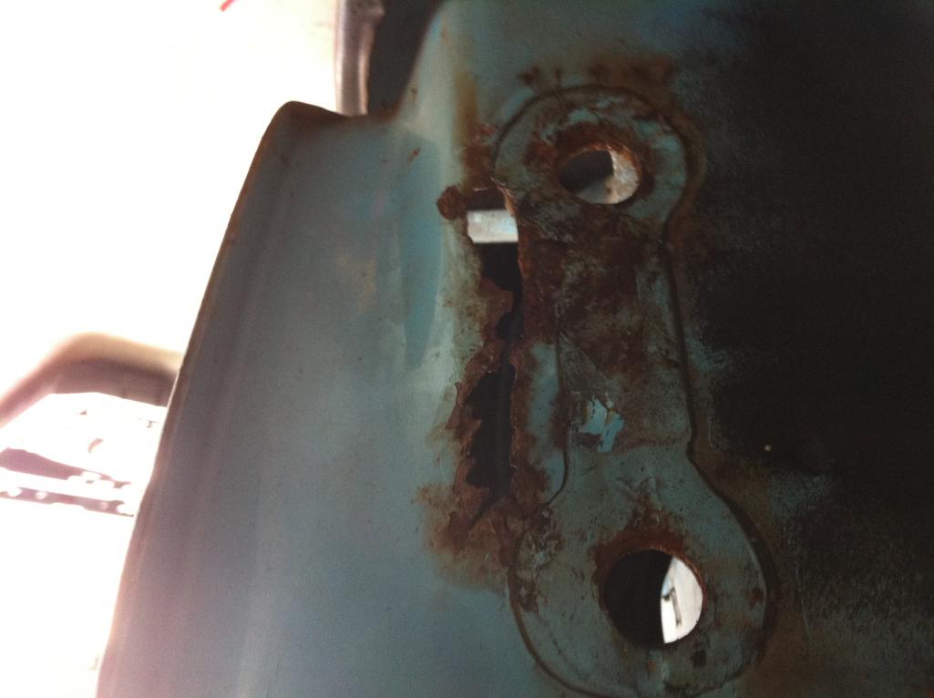

Tore into the car today, removed the front trunk lid and front bumper. Yikes, found rust on the left front bumper mount, not too terrible though, Its already down to bare metal and I will be patching over the next several days. Any tips on welding prep or wiring I need to disconnect before I weld?
Peeking around under the car yielded no surprises that I can see yet, though my rocker covers are coming off next week for the 914 ltd long kit I'm putting on. If anything is present there, I will eliminate it swiftly and as correctly as possible.

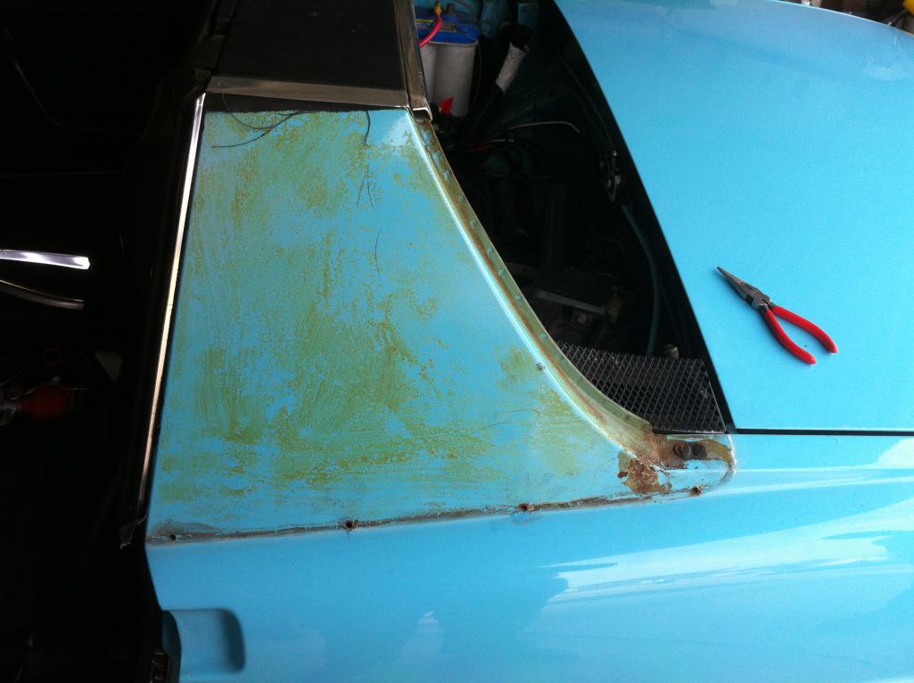

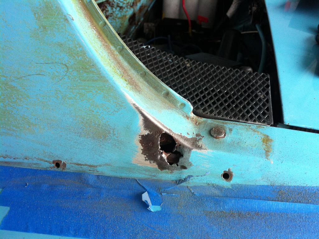

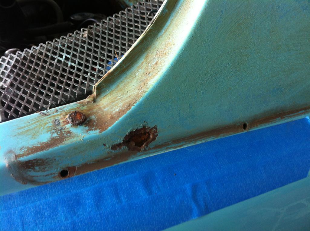

Also, took off the vinyl on the sail panels, found some rust, which I knew about. Not too bad; planning on taking down to metal and welding in patches.
Also, I neglected to mention in the previous post, I removed the trunk seal and found a few spots in the channel I will be patching as well. Any tips or suggestions for welding those?
I also sanded the car (some severe paint blemishes) and buffed it, seemed to turn out well. I will be wet sanding the body as well just to keep getting it closer to shine. That will probably happen closer to my finish date. I do plan on dropping the engine in the next month or so, so I can fix the small spot of rust I know exists, and explore for more and kill it. (IMG:style_emoticons/default/sawzall-smiley.gif)

Got a bit of work done yesterday. Sort of squared the rust hole next to the mounts. I'm planning on cutting more out between the holes and patching after I get the other patch in. Hit the front quarter with a hammer a bunch to fix the fender profile and hit some dents out. Definitely took a bit of mental strength to tell myself that I was about to hit my car with a hammer, but the profile is correct now. Just have to smooth the small stuff there, and put some filler on once I weld the patch over the wart hole.
Attached ImageAttached Image

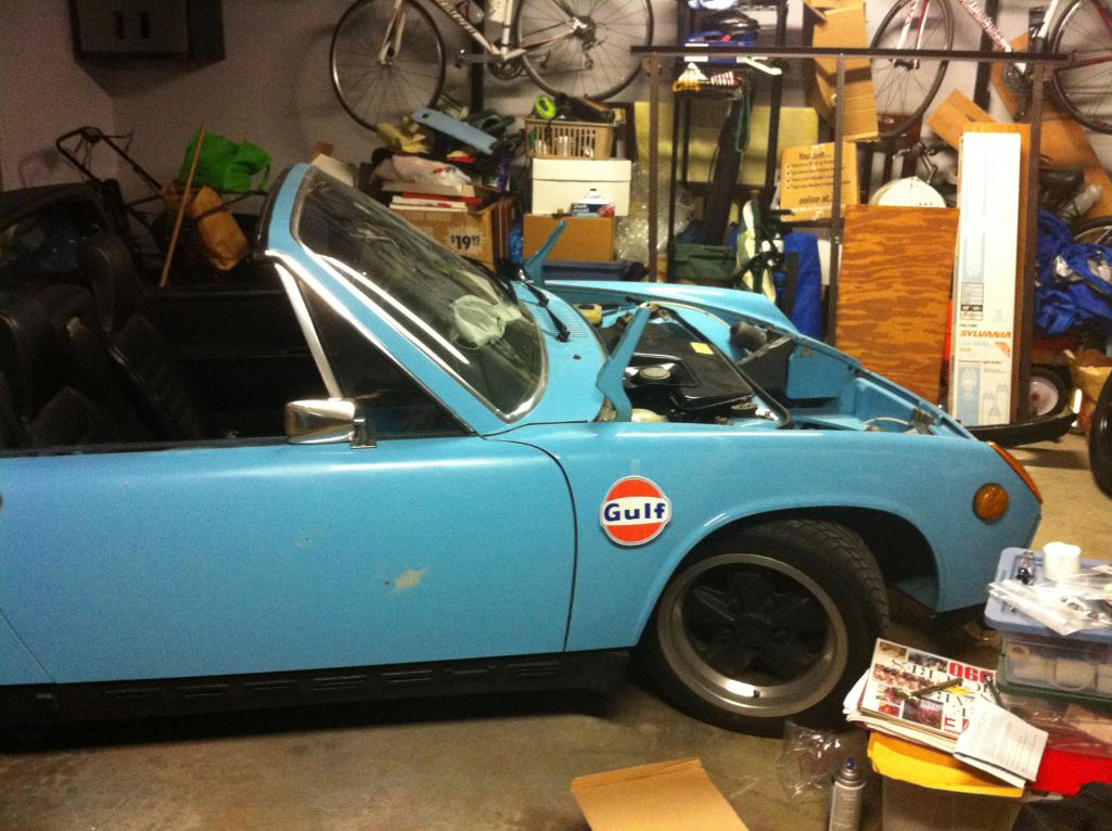

Also, tested placement of the Gulf vinyl, I like it! (IMG:style_emoticons/default/aktion035.gif)
-Alex

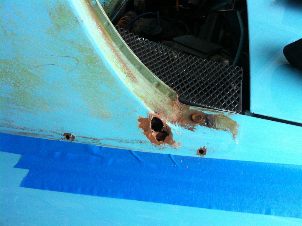

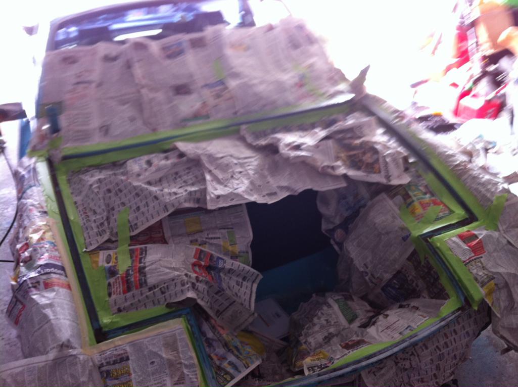

Here are a few pics of progress again. I squared the hole next to the bumper mount and wire wheeled it, but forgot to take a pic (IMG:style_emoticons/default/headbang.gif) Will have to do that later.

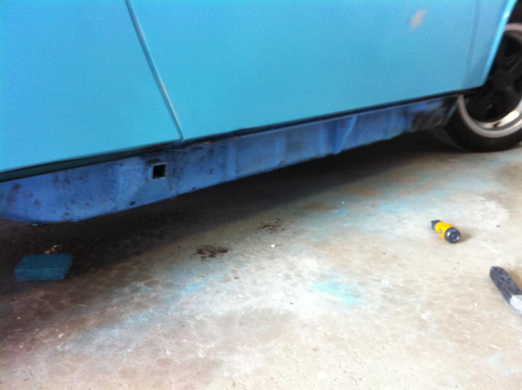

Took the rocker covers off, was fearing the worst, or at least a bit of rot, but nothing to my sight or in reach of my awl poking for rust. The splotchy matter what appears to be a rubber sealant, I stabbed through and hit solid metal every time, so I think its pretty good. Though there is a patch on the right side long about 3" long and 1" wide that I have to remove and weld correctly.
I will be using Eastwoods Internal frame coating in the longs (as well as some of Eastwoods other fine products on the car), just as a precautionary measure. I know a bit of very small particulate rust has come out of the drain holes, so I want to nip that in the bud now.
I ground/hammered/pryed out the rust on both sail panels and wire wheeled them. The right side hole has solid metal behind, Im thinking because of how it is, I can just pop in a few beads into the spot, fill it, and grind it flush. The right side however, I am going to cut out and patch with a small piece. Suggestions on sheetmetal gauge?
Also, are there any precautions or procedures I should do to the car before welding on her? I know disconnect the battery, but should I do anything else?
Thanks for the support and help thus far guys! Attached Image Attached Image

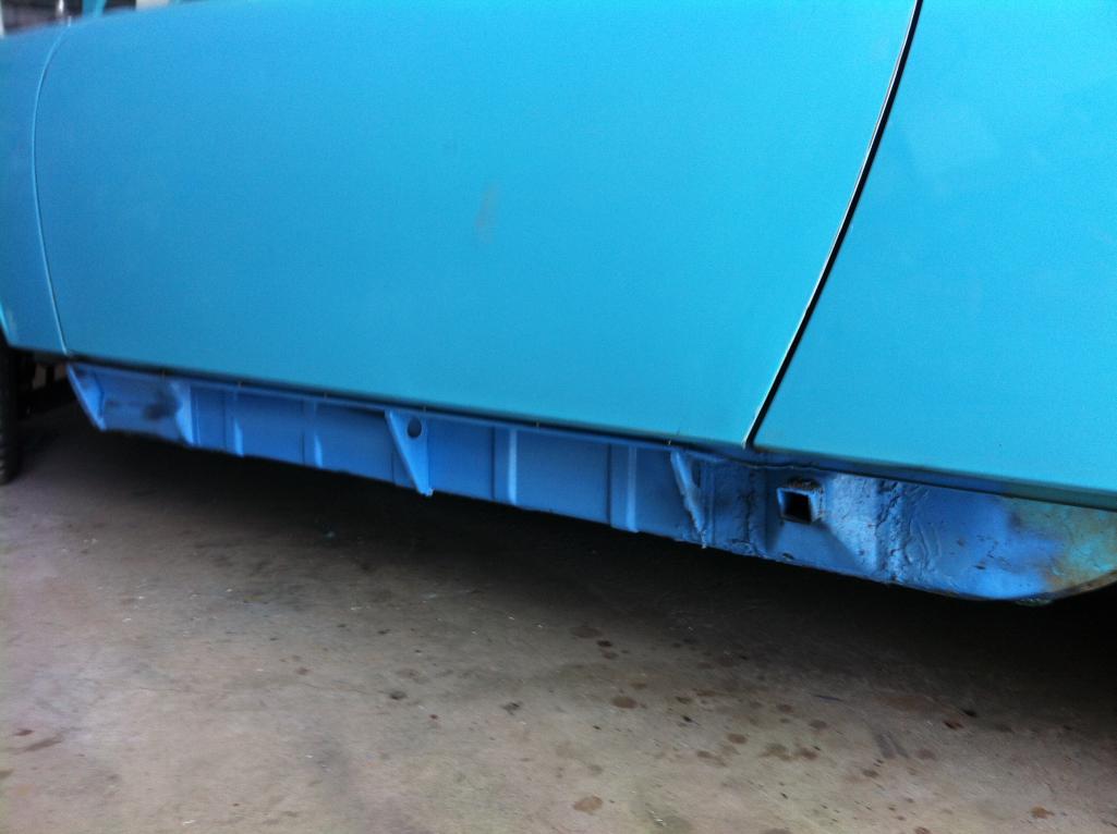

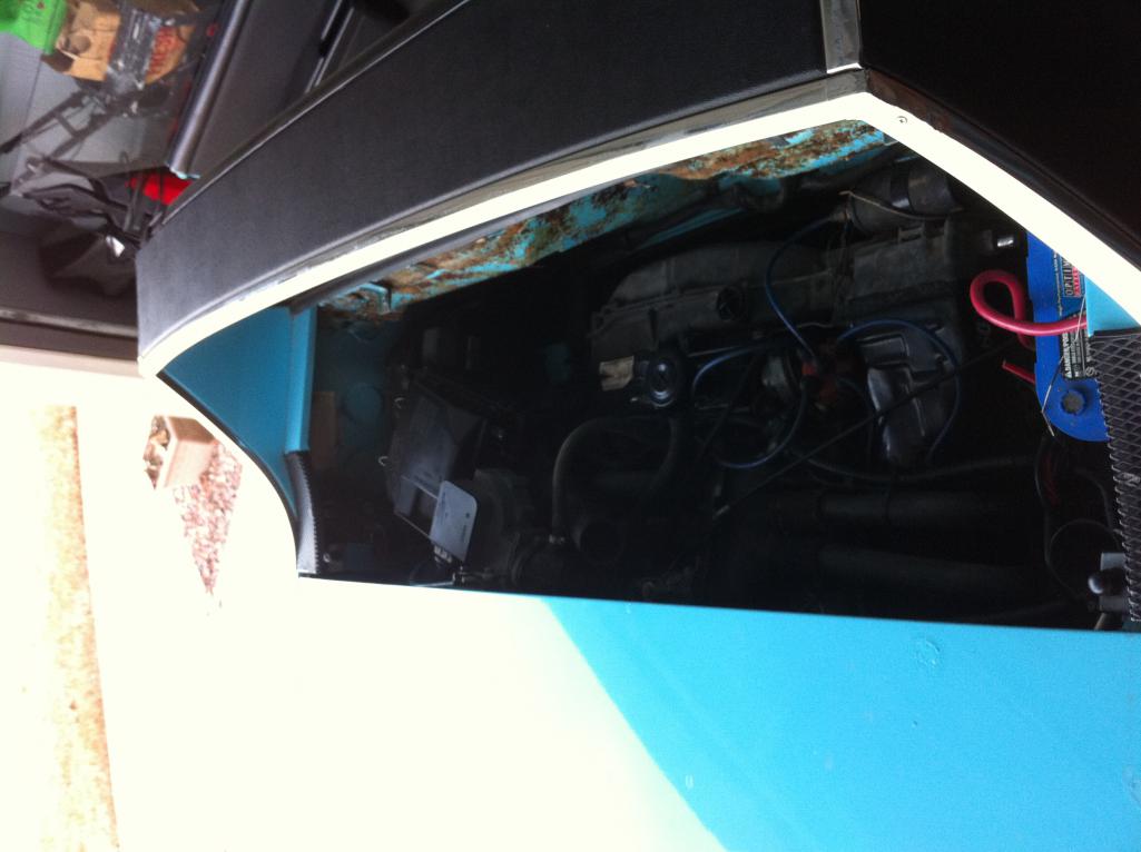

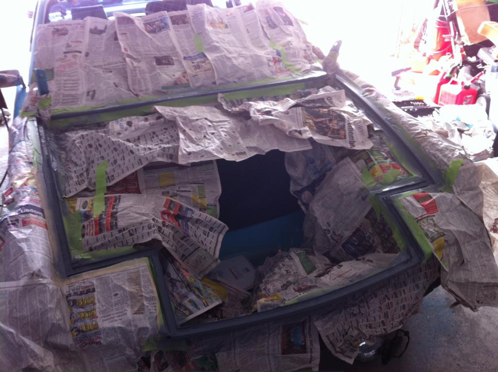

Got the better rocker covers and long kit in yesterday. Wow, thats all I can say, excellent work from 914ltd on this kit, very impressive.
So I masked the trunk seal channel (some rust in the channel) and prepped and sprayed Eastwoods rust converter on it. Going to probably leave it the grey color for a while until I get both fenders to the point of paint, so I can touch up the little areas that need to have blue put on them.
I got to use my favorite hammer and popped out a few other dents on the passenger side (IMG:style_emoticons/default/smash.gif)
Hopefully going to put the car on jacks tomorrow or Thursday for prepwork for welding.
-AlexAttached Image Attached Image
