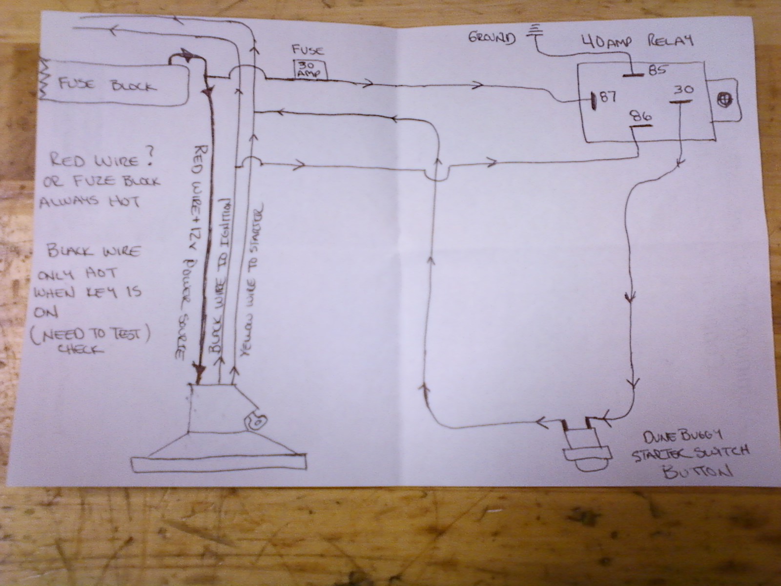

Hello John, here's a diagram of what I did for mine, the button only works when the
key is ON , and this fits under the dash, I also use a hidden pump switch (ground based for my fuel injection) ,
if you stall the motor while driving just push the button , no need to turn the key off and back on again, I hope this helps Bill D.

Does the yellow wire going to the original ignition switch require a diode to protect it when the button start is used ?

QUOTE(jim_hoyland @ Mar 31 2015, 07:40 AM) *
I didn't put one in my setup ,I don't see a need for it , the yellow wire coming out of the
switch goes to the starter solenoid , the key switch will still operate the starter ( if it's still good/ working properly)
you have the added benefit of the button ( which I prefer to use / it takes a load off of the secondary part of the key switch, which
is the part I think goes bad ) maybe I'm wrong about the diode , but I haven't had a problem so far . Bill D.

I think this is a good case for the "hot start relay" A simple relay located by the starter. The ignition switch pulls the relay and the relay contacts engage the starter. Look at the size of the wire that pulls the starter solenoid. It is a pretty big conductor. Your switch needs to handle all this current. Put the load on a cheap relay and save the load on the switch
