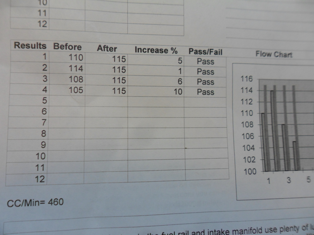

Injectors cleaned & tested by Mr. Injector. The worst one was only 10% flow deficient, so I had my doubts that the injectors were the problem. Installed the fresh injectors and still have the same problem.

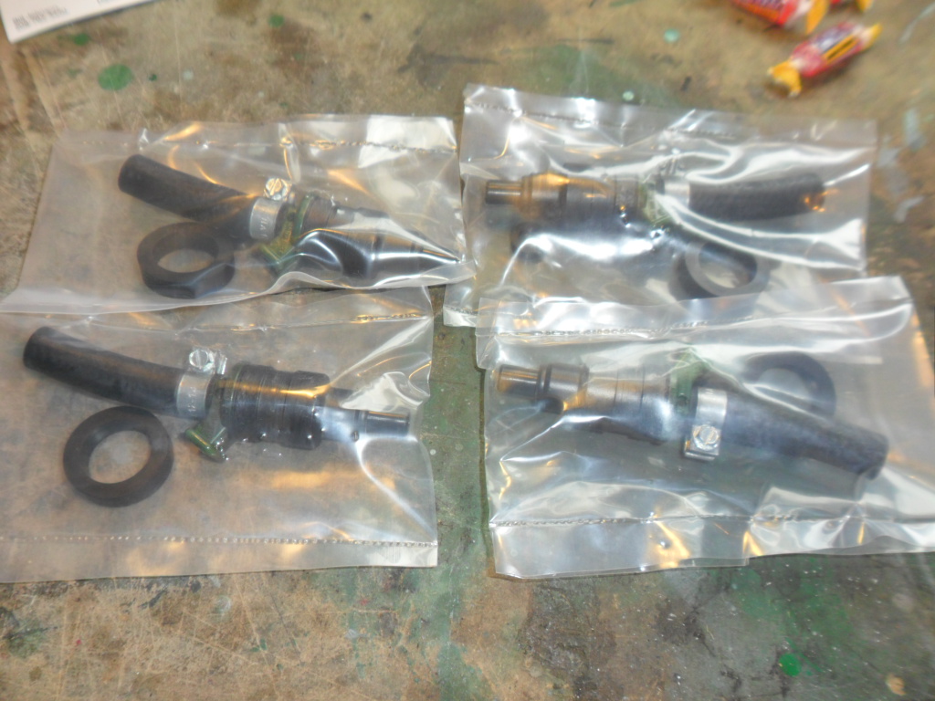

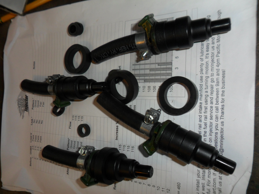

Props to Mr. Injector. Total turn around time, including shipping was 9 days. Injectors came back cleaned & inspected with new FI seals, FI hose clamps, lengths of hose and documentation on how the injectors tested. A true value at $17 per injector.
