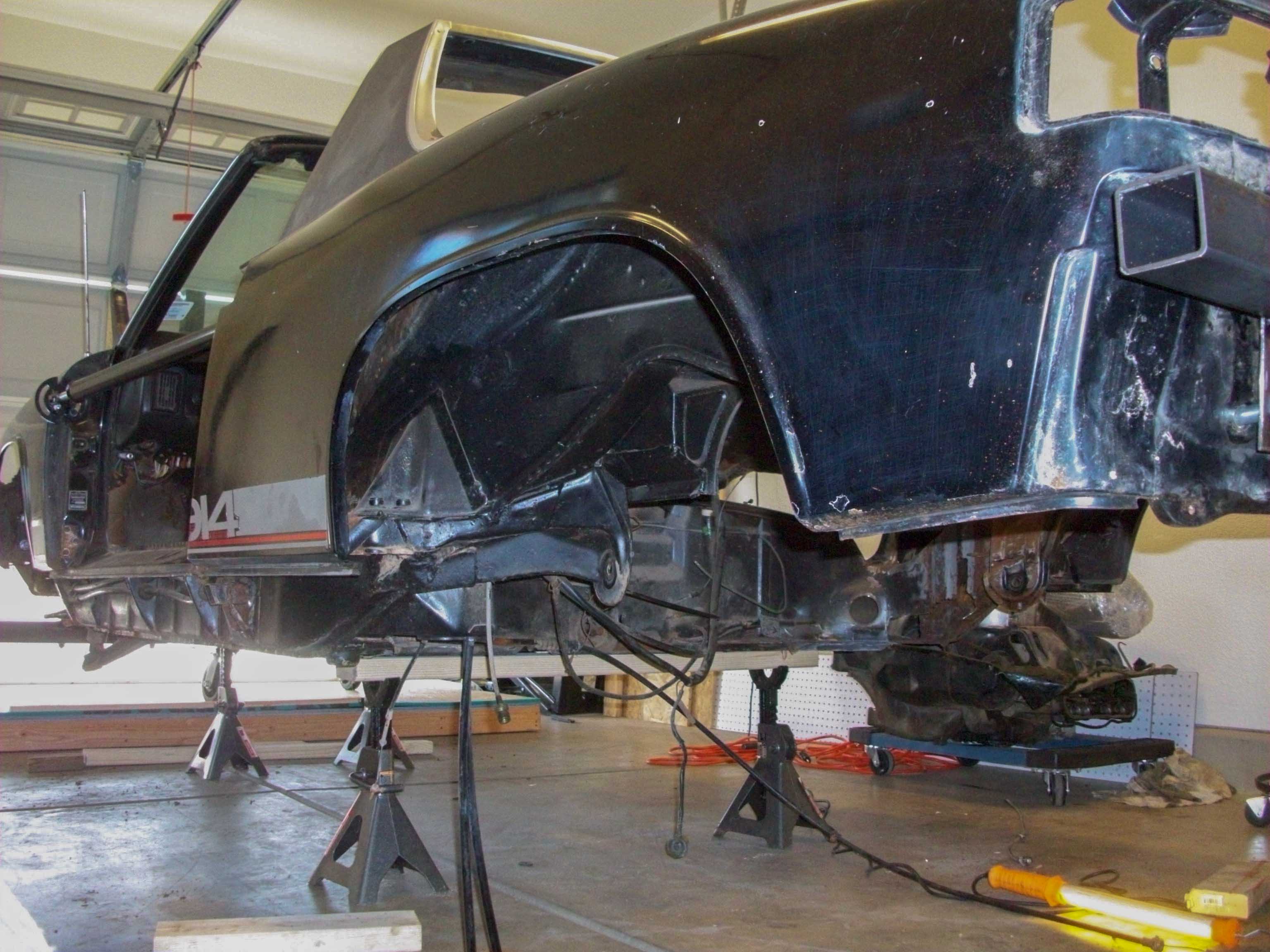

I had every intention of making an introduction video, but I found that I had ruined my wide angle lens trying to film some cool shots of grinding. So while I'm waiting for the new lens to be delivered, I will go with this novel:
I bought the car about a year ago with the shortsighted intention of throwing it back together and having a driver until its turn came for rustoration. I bought the car and a carload of parts from a guy in Dallas who did some really shady work and an incredible job hiding other rust; magician style he distracted with his obvious poor work. The drivetrain was out of the car and registration said it had been sitting for 12 years, so I don’t know what made me think I could get it driving in a month… Soon after buying the car, my daily driver VW went down and needed a bunch of work and Uncle Sam gave me orders to move 800 miles. I fiddled with the 914 now and then, mostly just probing for rust, but focused my attention on prepping my other projects and VW for sale, knowing I could only bring one car with me and it had to be rolling so I couldn’t really tear into it. I’ve been here in the new, much smaller shop since June and have been slowly tearing into the 914 between honey-do new house projects, new job training, and getting the new shop in order.

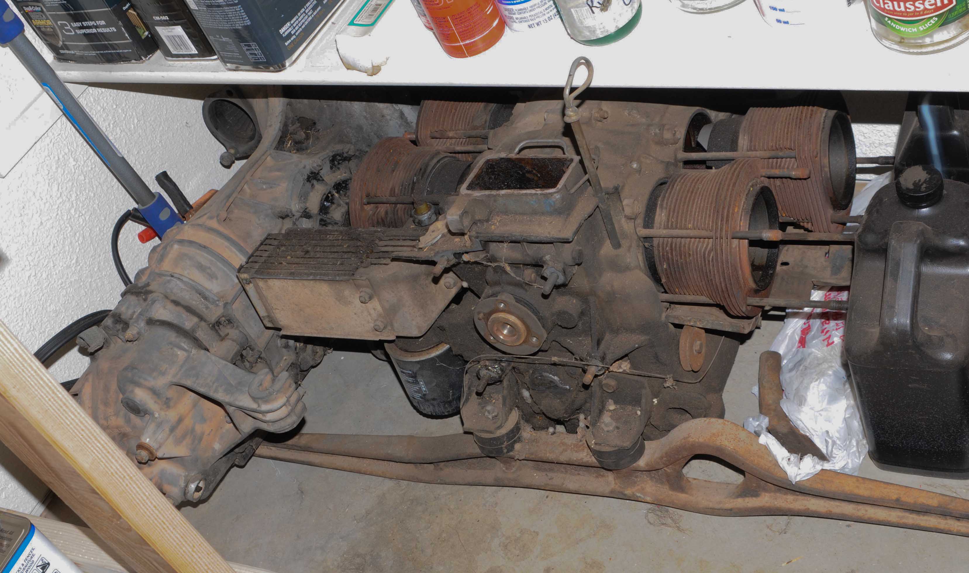

As we sit now, the car is on jackstands with the rotisserie acting as additional bracing, the engine and trans are under a workbench, the bigger pieces of the car are using the extra bedroom (the one my wife says needs to be vacated when we get pregnant) and others in boxes in my closet. Tearing the car down, I’ve found almost everything worse than I expected. The gas tank is pretty nasty with rust, all 4 calipers are locked up and the wheel bearing grease congealed. Removing the bumpers I found some evidence of prior damage and filler. Further probes into the longs found some rust on the driver side, and the passenger side nearly shot. The hellhole was a known problem, and turned into a chasm. I haven’t really dove to much into the floor, but found rust around the firewall and under a seat mount. The good news seems to be in a relatively dry trunk and pedal area.
My project’s Big 5 jobs are: 1) Rust repair. 2) Body work and a complete repaint. 3) Complete overhaul of the brake system, bearings, CVs, getting the window to work and stuff like that. 4) Engine rebuild. 5) Customization: wart removal, interior work, and an attempt at making custom made bumper tops.
In this build off challenge I face multiple fronts of challenges: 1) I grew up helping my Dad fix VWs, redid a Triumph Spitfire in my early 20s with his help, and have done numerous small projects over the years, but this is my first full rustoration on my own. 2) I have a severely limited budget. I am active duty Army, and everybody knows that NCO paychecks leave much to be desired. 3) I’m often short on time. My current assignment is as an instructor requiring me to work 10-12 hour days and 50-60 hour weeks. 4) I have a bum knee that makes it almost impossible to crouch and am fighting a shoulder issue that makes working overhead painful (praying for no surgery). 5) Nothing but the windshield and fine machine work like the heads and crank will be farmed out, I’m doing this on my own.
Well this is where we are starting, and honestly, who knows where we’ll end up. I haven’t really decided on color, engine, or upgrades, though I’m leaning towards keeping the 1.7 Liter Fuel Injection unless a good deal on another engine arises. I’m also thinking of keeping the car black but going minimal chrome, but who knows what the good idea fairy will deliver. I hope you enjoy the journey as much as I do.

Some more pics to show where we are starting. Yeah, I have a month's head start on the challenge, but I don't think it'll help. I will also say that if anyone has any requests for photos, stories, explanations, or what not, just let me know and I will do my best to oblige.

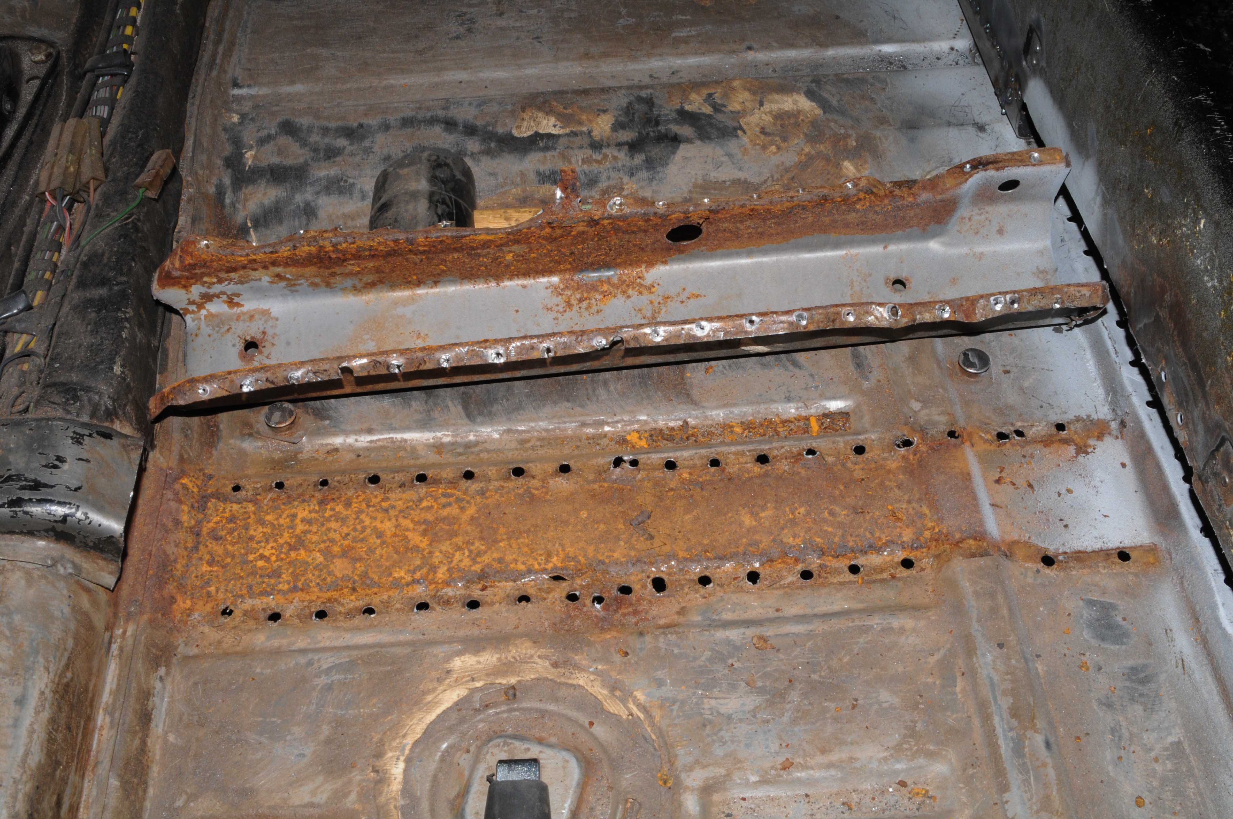

I just noticed in the pictures (then ran out to verify), but it's pretty rusty inside that cross member... what to do...
Tomorrow is wire wheel, some sandblasting, primer and begin to fab the pieces.

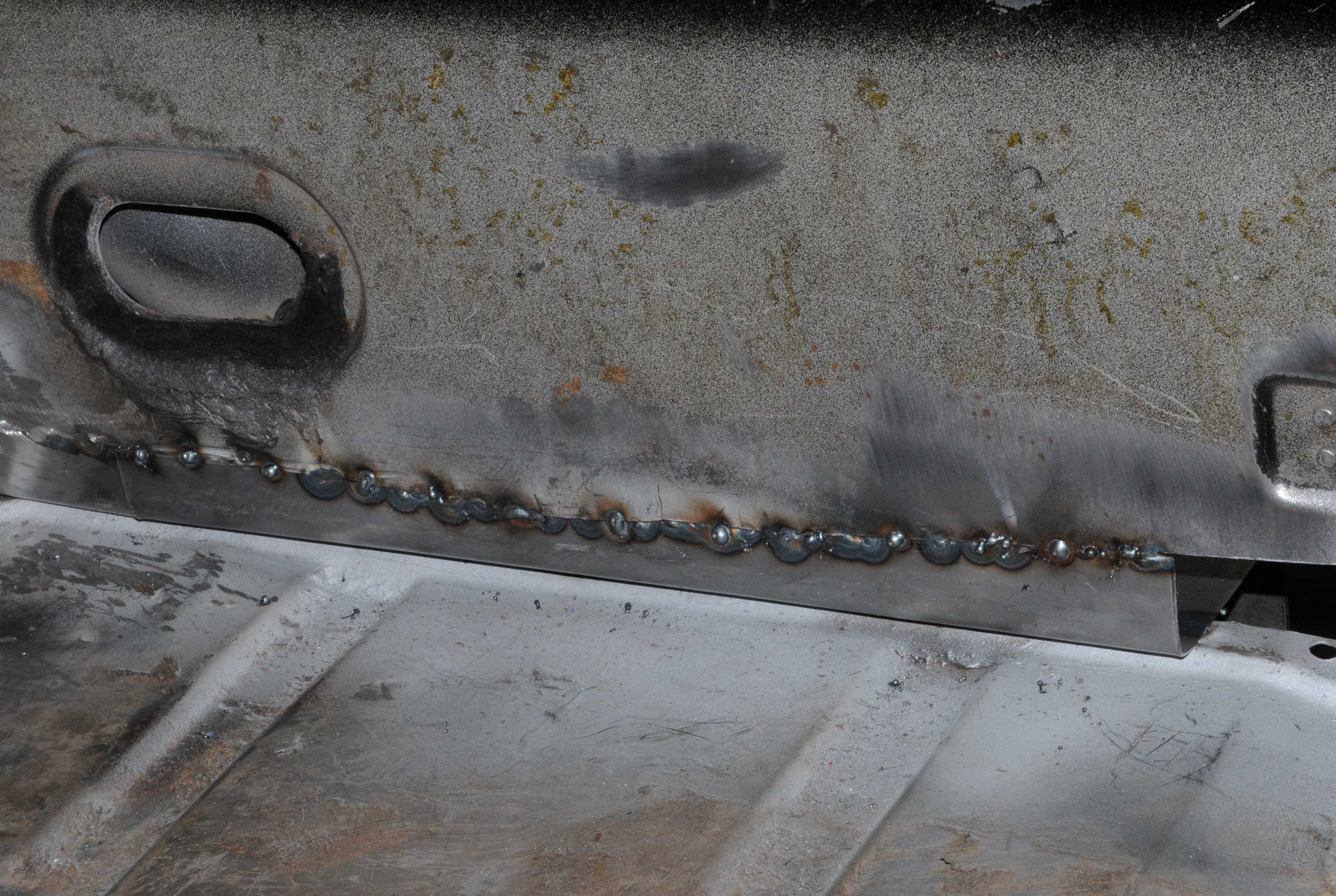

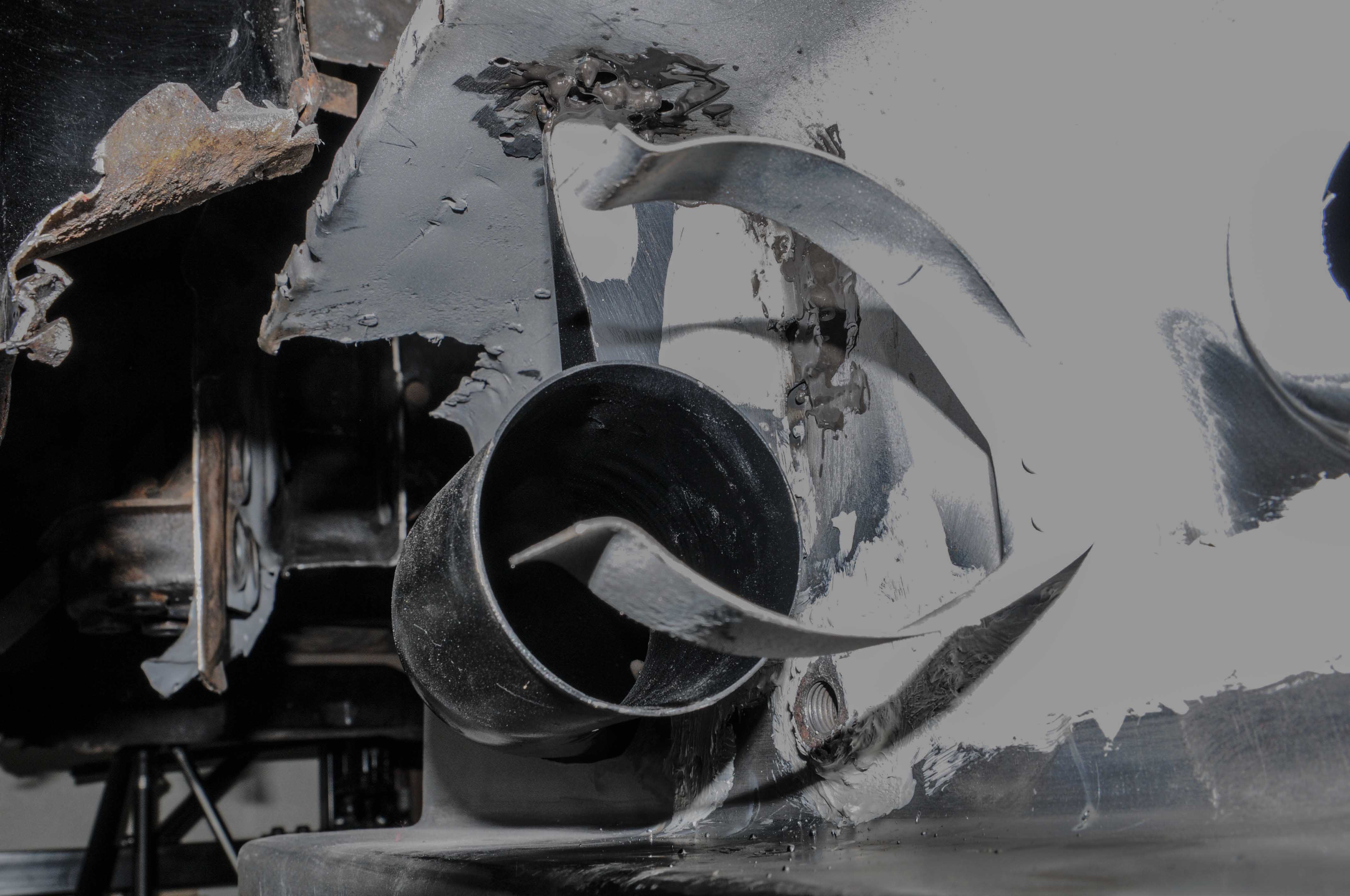

Felt extremely productive this weekend fabbing and welding in some pieces. I've ordered the internal rocker panel from Restoration Design, but the inner long piece is $300 and would be a huge blow to my budget, not to mention that I really only needed 20% of the panel... So here I am bending, cutting, grinding, and welding some 18 gauge sheet metal. The front piece has more curvature to it than you can see in the pic, but the weekend's biggest trick was the twisty piece that handles the spot where the floorpan has a little slope. I'm a bit concerned about the fabbed area not having the slopes and textures of the stock piece, but I guess even the factory slathered and covered the whole area with sealer...
Random extra info: My old, cheapo digital camera seems to have bought the farm, so I have to use the biggun. Some of these welds had to be done with my left (non-dominant) hand, I'll let you guess which...because I can see no increase/decrease in quality with either hand. I hope to go back and do some stitching this week. And note to others and future self: welding on the inside under the tube makes it impossible to grind... Raw video is currently being uploaded and I hope to make a video of the long's progress soon...

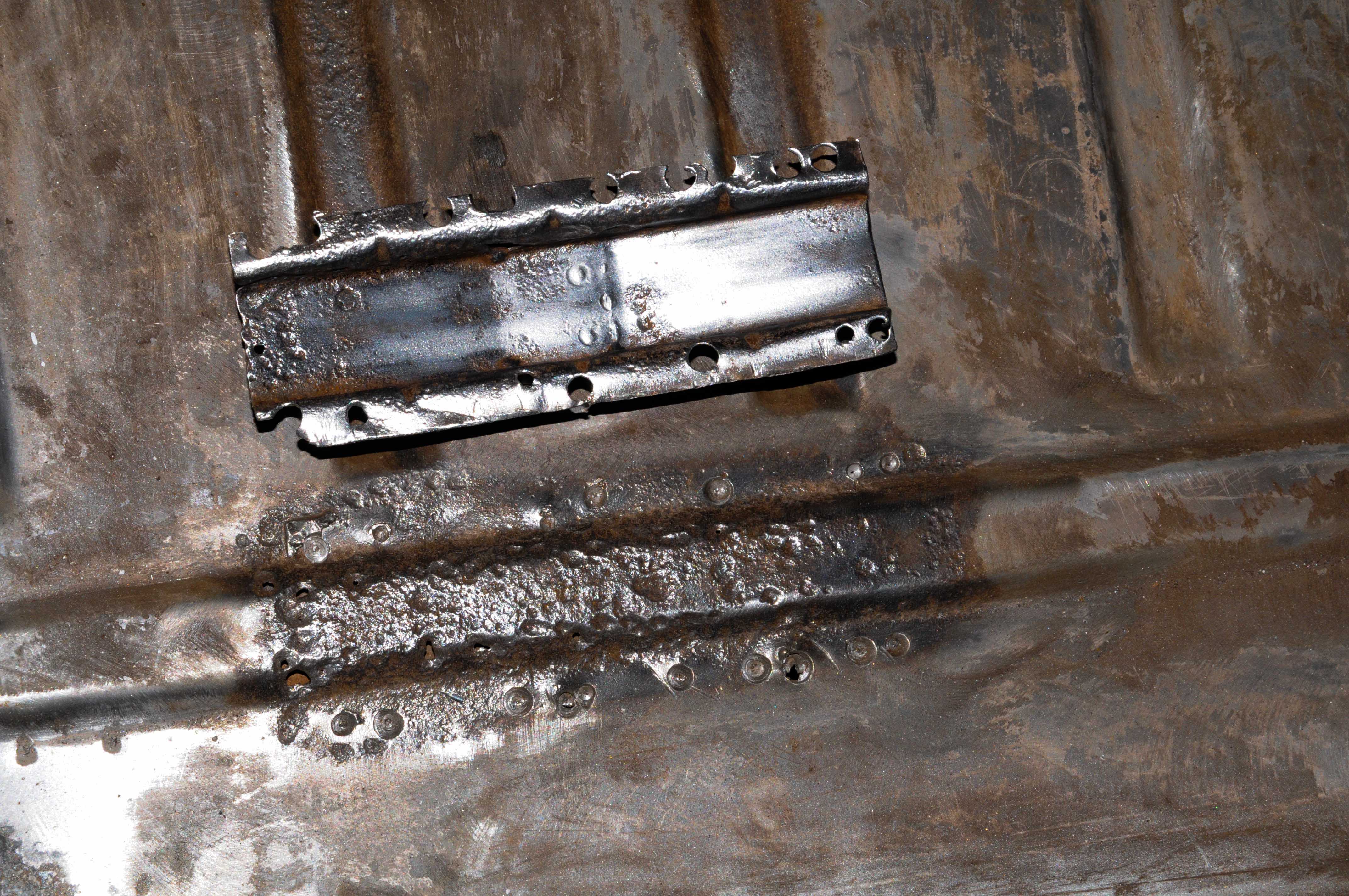

And on the front piece I drilled/ground out the oddly patterned rust that was part of the inner fender and used the subsequent holes to plug weld the new piece. I figured this killed 2 birds with one stone.

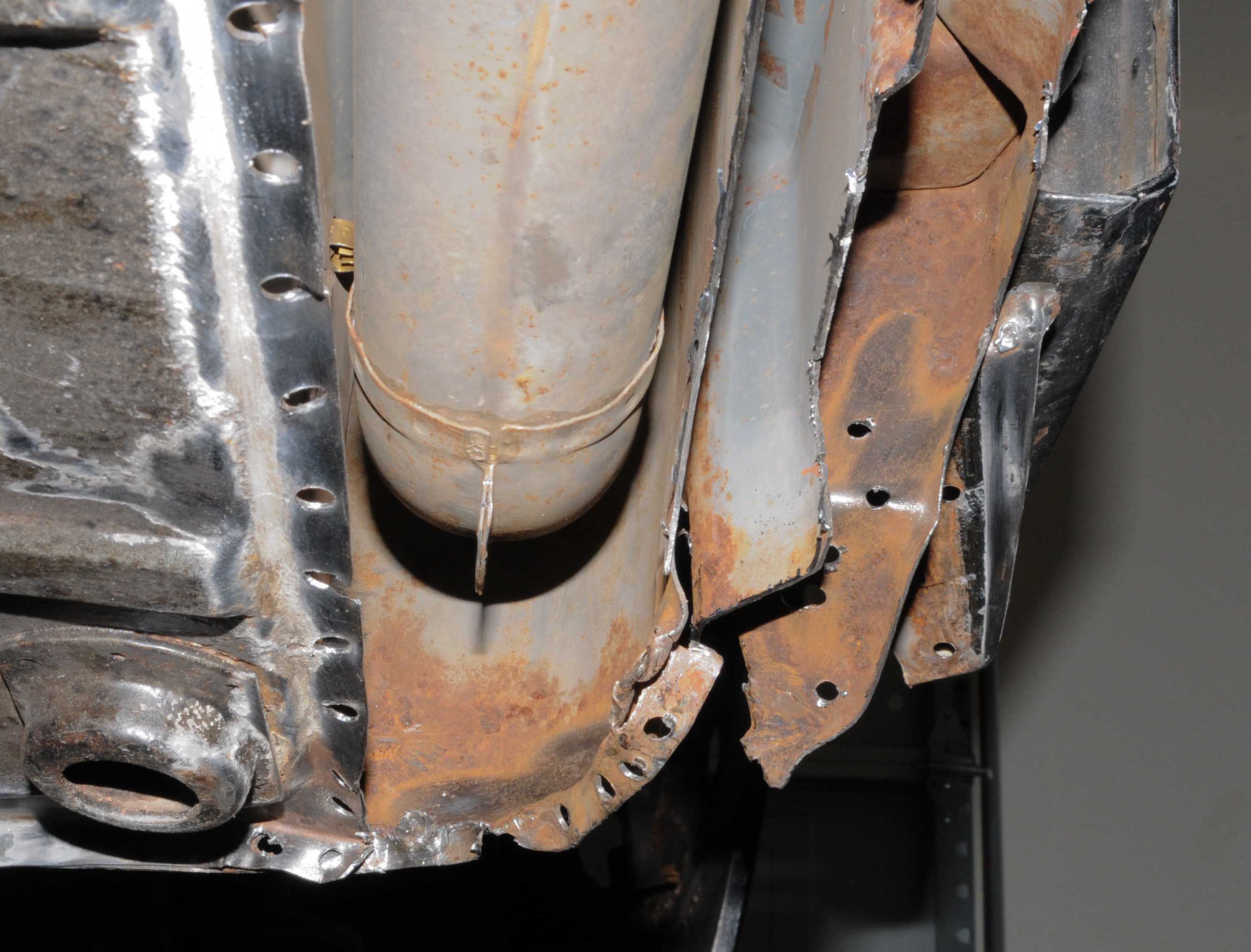

I thought I was to the point of putting pieces back on the car, but instead I removed and cut out more stuff! Pulled the cross member and seat mount to clean up some flaky stuff. It made me realize that I will need to buy a floor section from Restoration Design, but I'm going to try and finish up the long first so I can utilize the rotisserie for the floor. You can't see it in the pic, but the floor section where the triangle would be is gone, there are holes under the far right seat mount, and the other passenger seat mount was cut out...so another RD order is forthcoming.

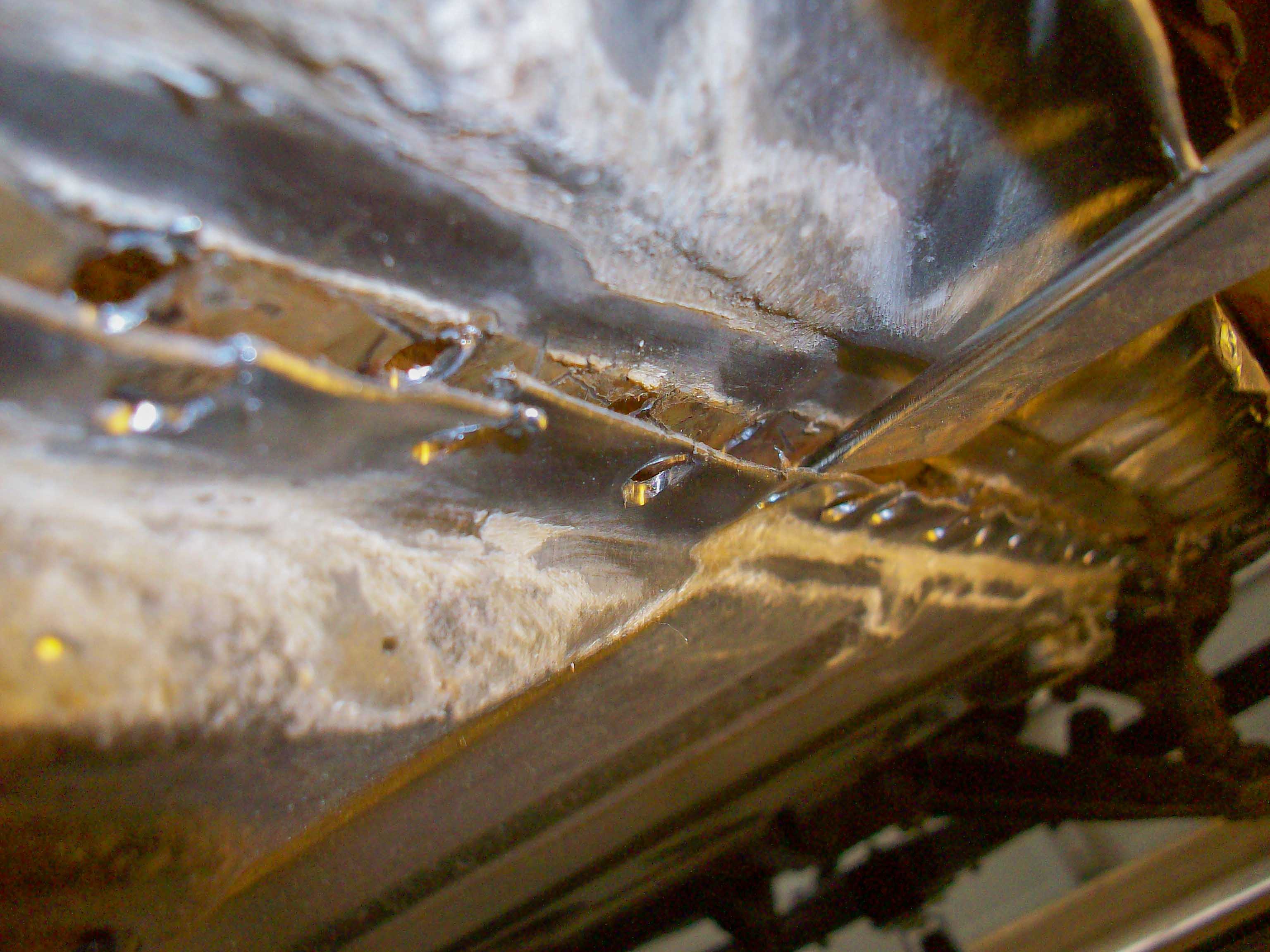

Last weekend was spent getting the last piece of that inner-long made and welded in and some grinding. This whole week had the old seatbelt mount soaking in rust dissolver since I couldn't find the right sized nut. This Saturday was more grinding, some more little welds, trimming and welding in the seatbelt mount, and more grinding before a lot of cleaning. Today involved the panic moment that the cross-member and heater tube thing needed welding in before I could I could seam seal. So the tube got wire brushed and naval jellied before a painting and a hole patched with JB Weld.The cross-member got prepped and tack-welded in (I kept the floor part mostly loose for a future part of the project). I used wait times to seam seal stuff way inside the front part and stuff.
The inside of the long isn't pretty, but I figure it doesn't really need to be...The part in the passenger side could have and should have turned out better, but it's not too bad and won't need more than a skim of filler to make smooth. Carpet covers it anyways...right?!? haha

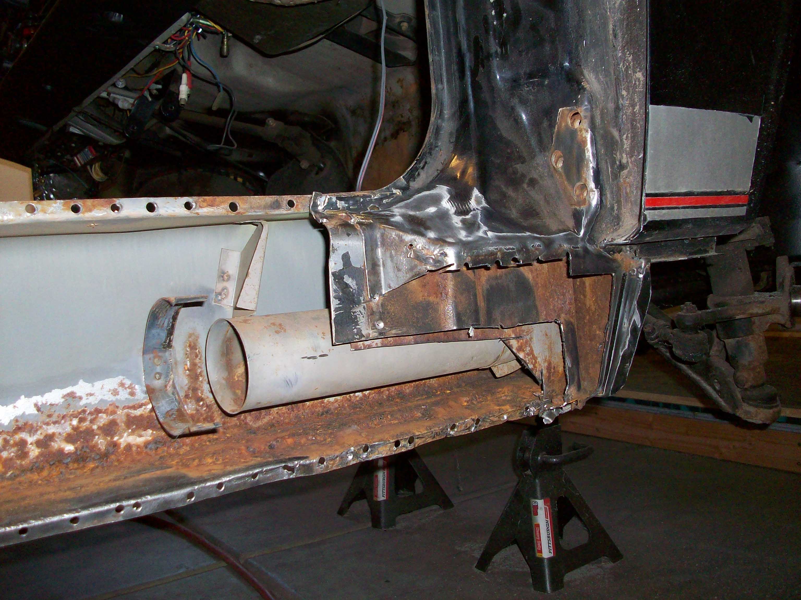

It's weird how parts of the heater tube look like overspray, but it's solid black except in the weldy areas which will need painted later. I also found that it's mounts were kinda weak and thin, so I took some JB Weld to assist the real welds in their job.

Also, word of advice to future me: Weld the long from inside the car and not inside the long under the front heater tube. You can't grind behind that pipe. Actually, just get a better paying job and just buy that whole piece from RD instead of making your fancy little patch panels.
