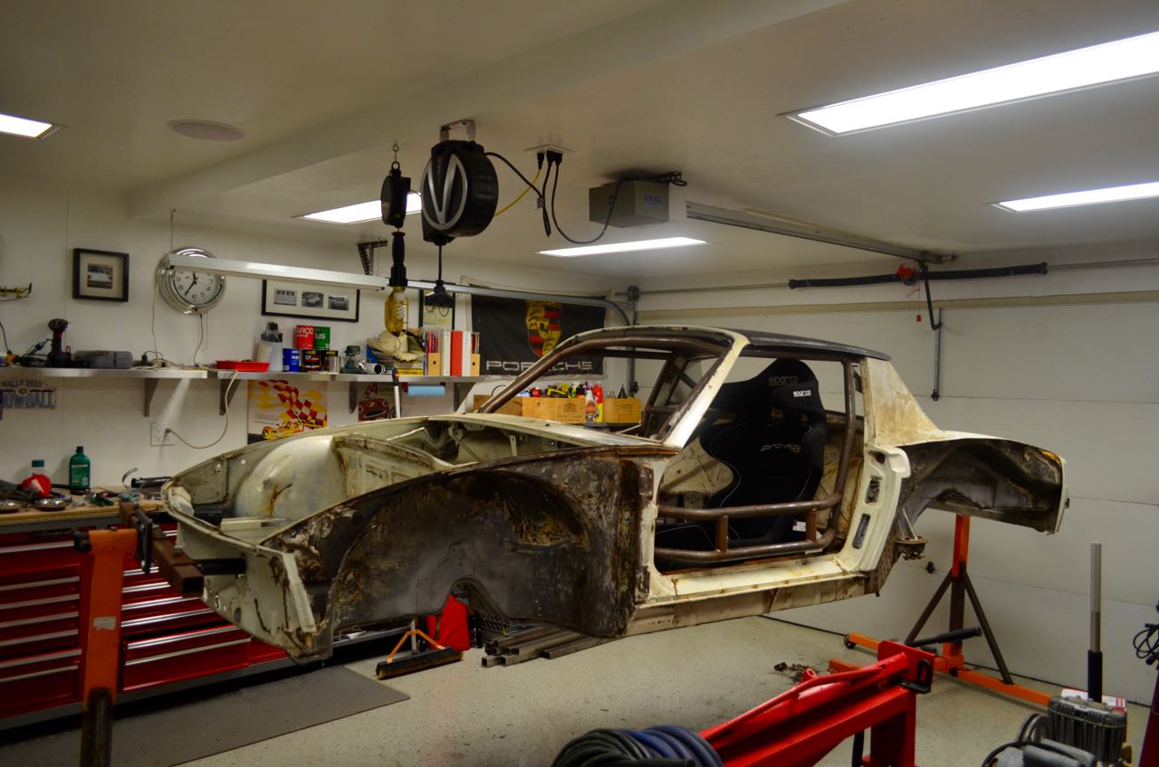

Its been a long time since my last post, the holidays really sucked up all of our time. My brother and I were able to get his car out on the road and I was able to start finishing up projects on my 911. The 911 is just about wrapped up so the 914 will be coming into the garage shortly, so I get started on the 914 floorpans.
So the floorpans... The plan is to cut the bottom out of the driver side of the rear pan and drop the driver seat down by an inch or two. I've seen a few examples, Patrick Motorsports has a couple of cars that they've done this to, I think its smart:
(IMG:http://www.914world.com/bbs2/uploads_offsite/patrickms.s3.amazonaws.com-6222-1452980232.1.jpg)
I had to cut the entire floorpan and center tunnel out of the car to fix the longs, so before I can start putting in the pans I need to fit the seat. I've been hedging about what seat to buy for a few weeks now, but was lucky that a friend had the exact seat I was thinking of. I picked it up this morning and will start fitting it with a custom tunnel.
Progress is slow but it'll start ramping up in the coming weeks.
