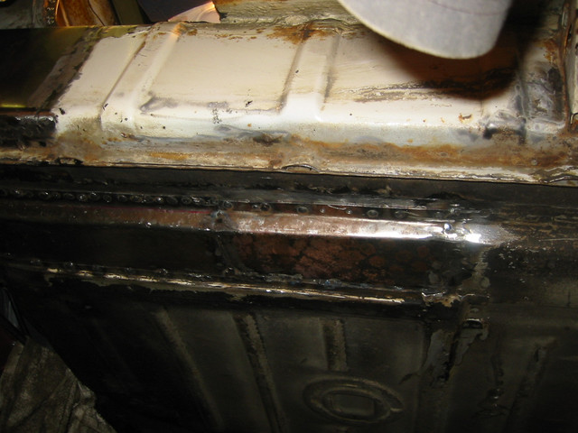

While I was in there I figured I'd repair the small section of the floor that was fiberglassed by the previous owner. Well as usual there was more rust than expected... The more I cut the more I found. (IMG:http://www.914world.com/bbs2/html/emoticons/sad.gif)

At least the hell hole looks good. How many people actuall get to look inside their longs? (IMG:http://www.914world.com/bbs2/html/emoticons/huh.gif) Not sure that's really something to be proud of though. (IMG:http://www.914world.com/bbs2/html/emoticons/unsure.gif)
At least they looked pretty good. Just a little surface rust.

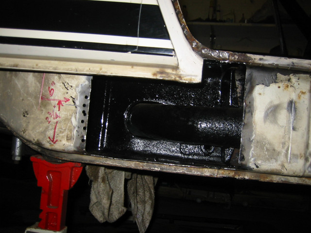

Got in there and cleaned as best I could then got a spray gun with a long wand and shot the whole inside with por15.

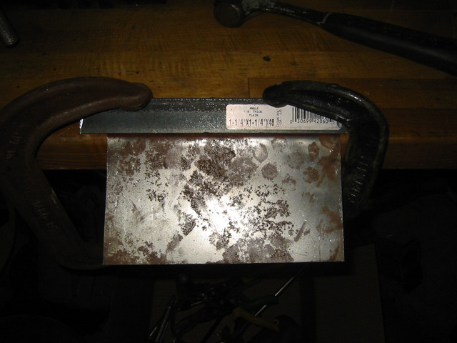

Now that everything was cleaned up I was ready to start making the floor pan sections and patch for the rocker. Expert metal worker I am not. But the sections came out pretty well considering I used the side of my bench as a sheetmetal break! A little (IMG:http://www.914world.com/bbs2/html/emoticons/smash.gif) and (IMG:http://www.914world.com/bbs2/html/emoticons/beer3.gif) and (IMG:http://www.914world.com/bbs2/html/emoticons/sawzall-smiley.gif) more (IMG:http://www.914world.com/bbs2/html/emoticons/smash.gif) much more (IMG:http://www.914world.com/bbs2/html/emoticons/beer3.gif)
Finally I was done. I had to make the floor in 2 sections because I just couldn't bend the entire length.

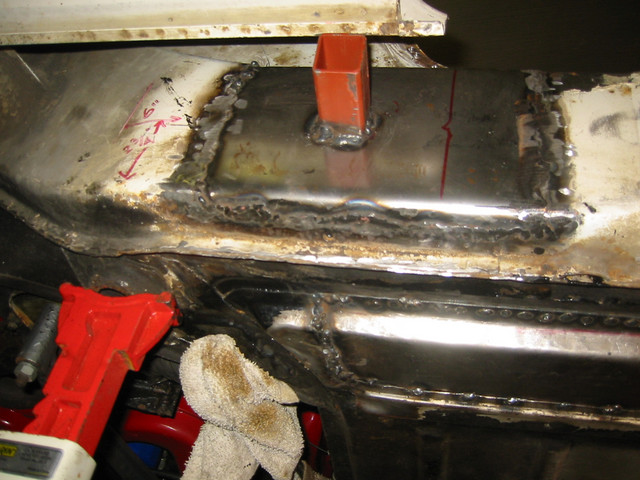

Here's the floor patch and the rocker patch welded in.

The welds ground and the jack post welded on.

Here it is welded on with seam sealer and a quick coat of primer to prevent rust. I have to clean those dirty longs, sand and repaint them.
