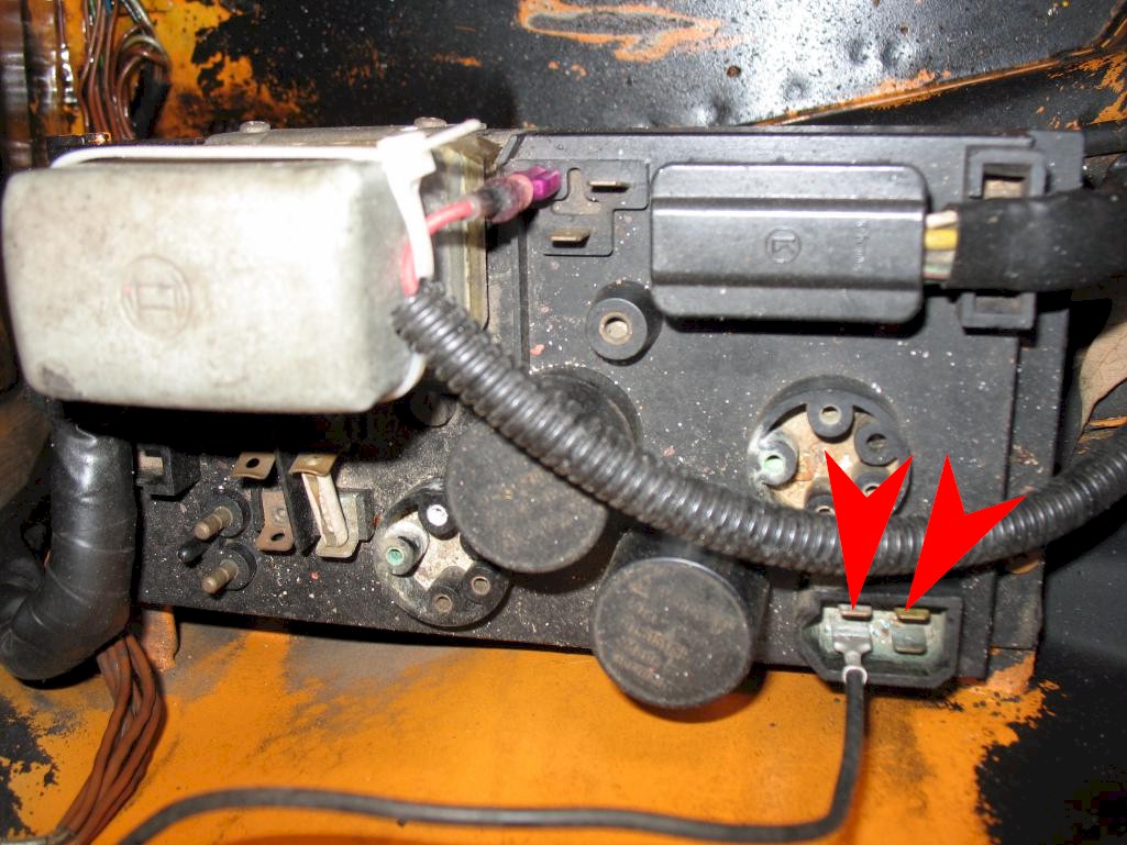

i thought hot start had to due with hot gasoline and fuel pump being in engine bay.
that aside, i put a bosch relay near my starter, one problem i have is from driving in bad weather, is corrosion on the terminals.
i've installed a wire from battery to a momentary switch and the end terminal is near starter, and when my car won't start, i pull the ignition wire to starter and install the wire from my half assed momentary switch and it starts fine. meaning the starter turned engine and car starts. i should wire this switch to my dash as an always available back up.
when my wires are wet and corroded, starter does not turn at all. i hate rainy salty days : (

QUOTE(jimkelly @ Mar 21 2016, 12:28 PM) *
All you have to do to get the engine to crank is to hook a wire from the battery to one of the rear two pins on the 4 pin connector that is located on the right rear of the relay board. Both those connectors go straight to the starter solenoid.

QUOTE(jimkelly @ Mar 21 2016, 01:28 PM) *
that aside, i put a bosch relay near my starter, one problem i have is from driving in bad weather, is corrosion on the terminals.....
Jim,
I'm a Ford solenoid fanboy, one reason is because it's waterproof, only one that has failed on me is one that the metal back rusted through.
If you are going to use the bosch relay, mount it in the engine bay in a shielded area with the terminals facing down.

good points and info.
i may switch to a ford solenoid for that very good reason.
do i have arrows on the correct 2 terminals?

QUOTE(jimkelly @ Mar 21 2016, 01:39 PM) *
No. In your picture, it would be the two on the right.

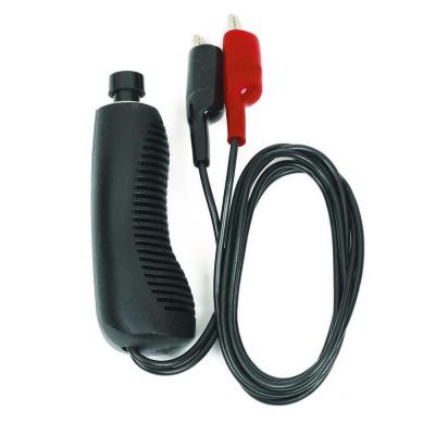

It sounds like you merely energized the starter motor, but not the solenoid. Thus, the motor spun in the resting position.
With ignition ON, this merely energizes the fuel pump and ignition.
You must energize the starter solenoid in order for the pinion gear to engage the flywheel ring gear while the solenoid plunger simultaneously energizes (sends current to) the starter motor armature/field coils.
To energize the solenoid, momentarily connect a jumper wire between the large 12V battery cable terminal and the yellow wire terminal on the solenoid. Use a remote control starter switch to make this connection from a comfortable distance.

QUOTE(jimkelly @ Mar 21 2016, 04:24 PM) *
got ti, thanks.
That would be correct. Both of those go to the starter circuit.
got ti, thanks.
Where is this relay board located?
jimkelly
post Mar 22 2016, 06:43 AM
Delaware USA
Posts: 4,969
Joined: 5-August 04
From: Delaware, USA
Member No.: 2,460
in the engine bay opposite the battery. its behind the driver.
