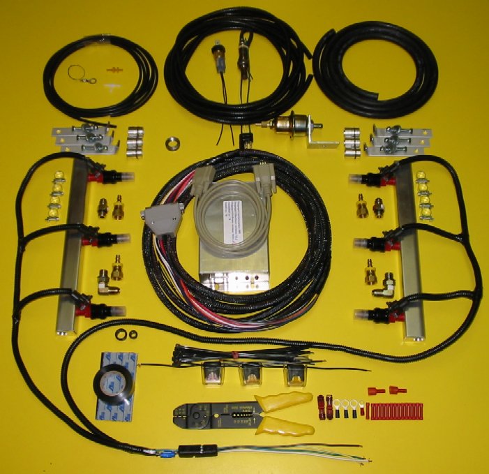

Have any of you megasquirt guys followed this thread:
http://forums.pelicanparts.com/showthread....rt&pagenumber=1
This guy has developed a complete EFI kit for the flat six using Megasquirt. The horsepower gains over CIS look pretty good.
Here's his home page
http://www.bitzracing.com/index.html
The kit:

I'd be happier about paying that price if he offered decent electrical connectors and a proper crimp tool. That hardware store stuff he has in that photo is junk. If you buy the CIS to EFI injector adapters from them ($120 for the set), and bought all the rest elsewhere, I'd guesstimate you could do the whole job for $800 or thereabouts. That includes a pre-assembled MS ECU ($250). Paying a 25-30% premium to save yourself some hassle seems fair. Paying 100% seems excessive.
I'd expect a top-end power increase simply from removing the CIS airflow meter. Much more power could be obtained by using better cams than CIS can handle, which an MS swap would allow.
As far as I know, this is the first complete kit to use MS. There's been some anguish in the MS community over commerical reselling of the product. I think it's only a matter of time before someone contracts with an overseas firm to assemble MS units at an industrial scale. Zero R&D costs would mean very low unit costs ($50 per in quantity, I'd venture). You'd then see a lot more similar kits offered for sale. I would not want to be in the aftermarket ECU business right now, except for the high-end guys like Motec. SDS, Perfect Power, Wolf, et al are very probably going to find business increasingly hard in the next couple of years.

He might appreciate your comments regarding the connectors. He's obviously put in lots of hours figuring out every detail of the installation so I don't begrudge him a 100% profit at this point. I imagine as the Megasquirt gets more well known in the 911 community more people will be making kits or parts for kits which will allow one to easily do it cheaper. He also sells a partial kit and I think he will even sell just the fuel rails if you wanted to do everything else yourself.
For the 911 guys I think it's an ok deal considering you don' t have to do any fabricating. I'd still like to see proper before/after dyno runs on the same car with CIS and then with Megasquirt.

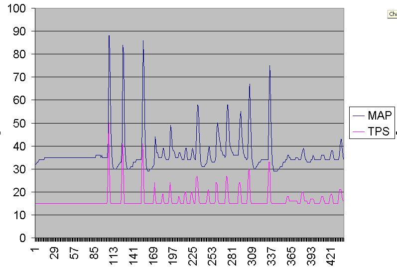

I noticed he was able to do this without a TPS. This is part of new code in the megasquirt, right? Can we do that for the 914 and not need a TPS?
I believe for most applications the TPS is really only needed for fuel enrichment during acceleration (it should be a little quicker than MAP based) and for decel, so the motor will get less fuel on coasting...the MAP will do the rest...

QUOTE (Mueller @ Apr 6 2005, 02:07 PM)
I believe the very latest code (the "extras" code) has a mode that allows you to only use the MAP sensor, even for accel enrichment and fuel cutoff. Decel generally results in a MAP value below idle MAP, so you just set a threshold below the idle value for fuel cutoff. Accel enrichment can be done using a MAP rate of change as easily as a TPS rate of change. There probably is a better response rate with a throttle sensor, but ditching the TPS seems to be a win to me. Using a TPS makes things a touch more reliable, as the MAP thresholds are going to change from car to car (even engine to engine). Set the fuel cutoff too close to idle and you'll find the car stalling at lights regularly. Set it too low and you'll get popping on the overrun because the cutoff never happens.

On page 5 of the Pelican thread he posted a graph of map vs. tps response and found them to have almost the same response rate. I'll repost the graphic. You guys can look at the link if you want to read his description.
