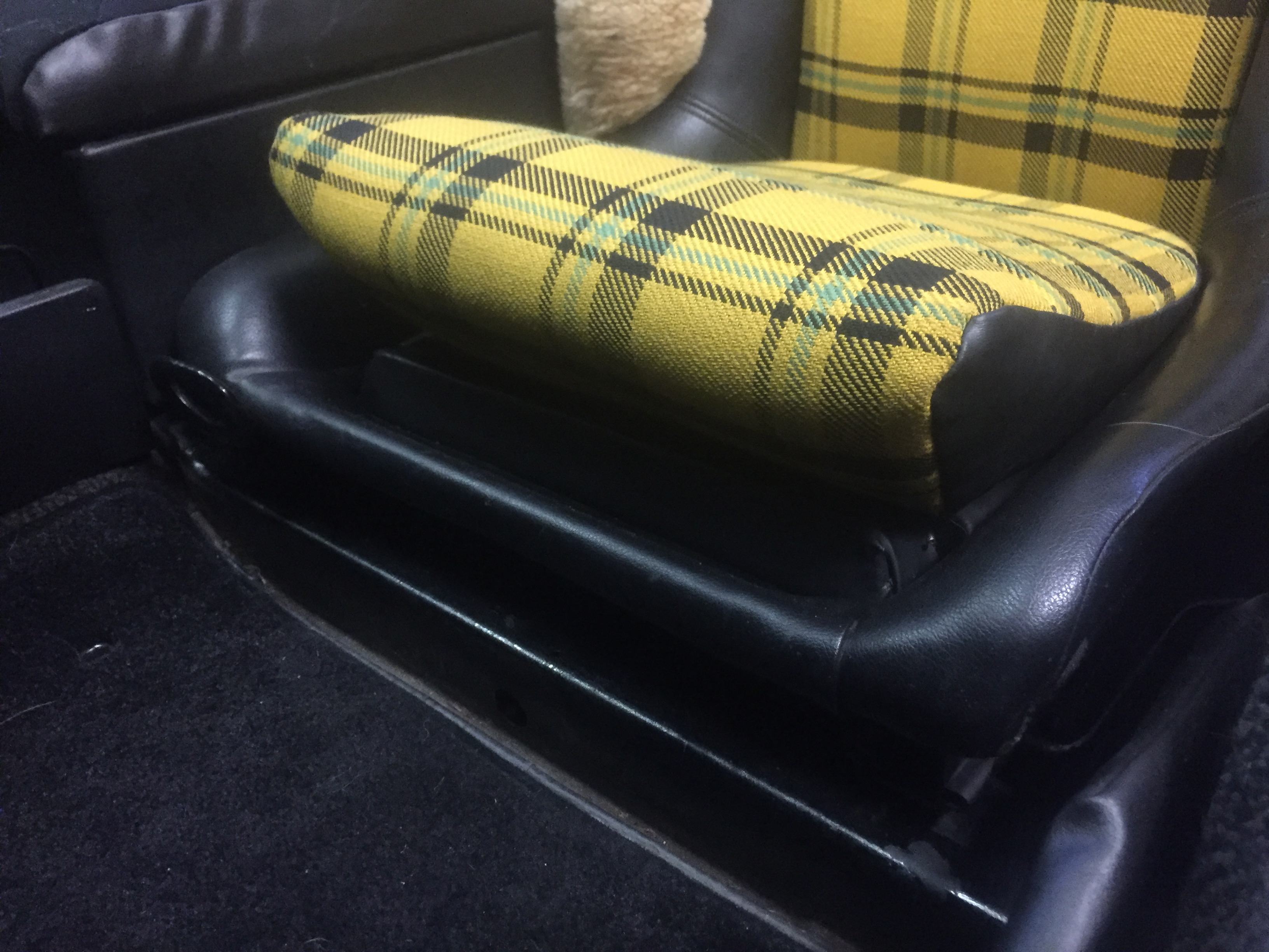

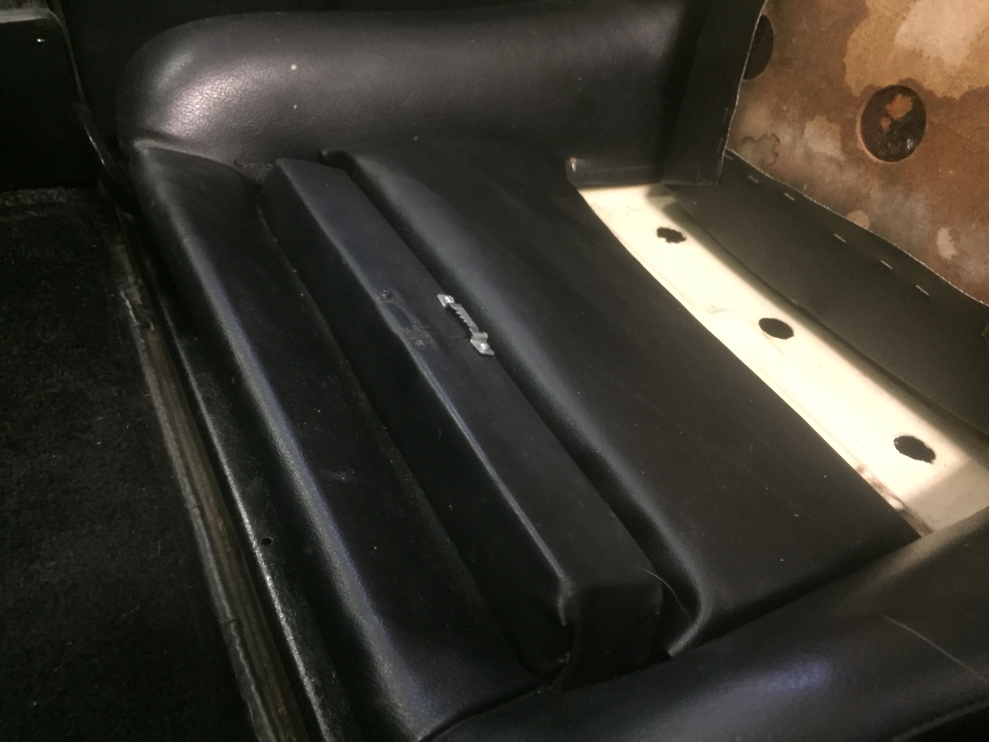

One modification I made to my drivers seat, since I am tall, is to raise the front edge of the seat about an inch and a half. This gives my legs much better thigh support and reduces leg fatigue. I need the seat all the way back, so tilting the seat back to raise the front edge is not an option. I fastened a piece of vinyl covered wood to the fiberglass bucket, across and under the front edge of the cushion. Then I used a picture hanger hook attached to the top of the wood lift to act as the hook for the seat cushion's front tab, to hold the cushion in place. I also added some dense vinyl covered foam behind the riser block to support the center of the seat. Here's a couple of pics to give you the idea.
