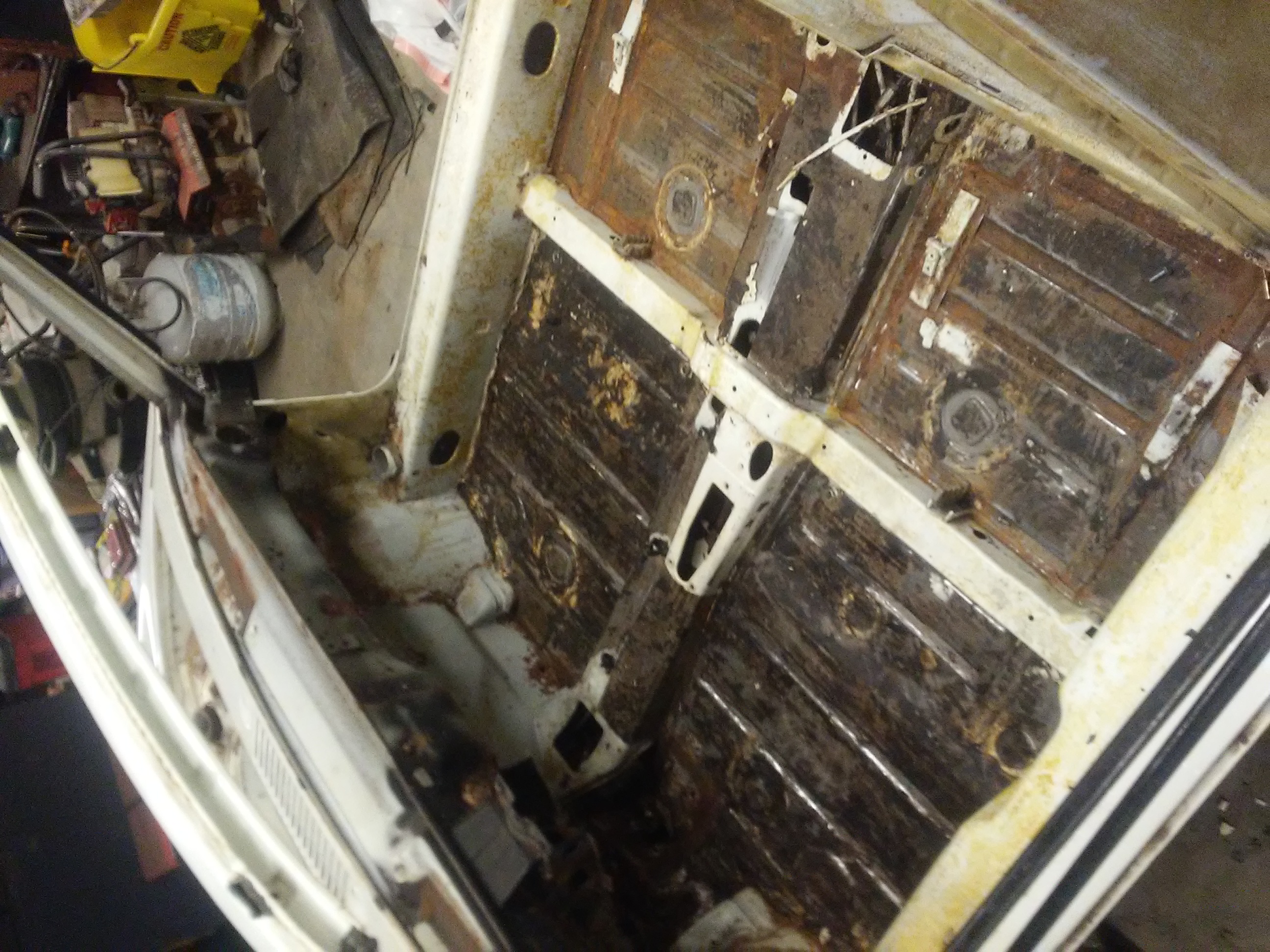

Since the pictures were taken i have gotten a little more done. I have pulled the wiring harness , taken out the dash frame and have the inside fully stripped. Just scrapped the tar off the floor pans and was plesantly supprised at how little rust was found.Attached ImageAttached Image

Congratulations! That looks like a decent car to start with.

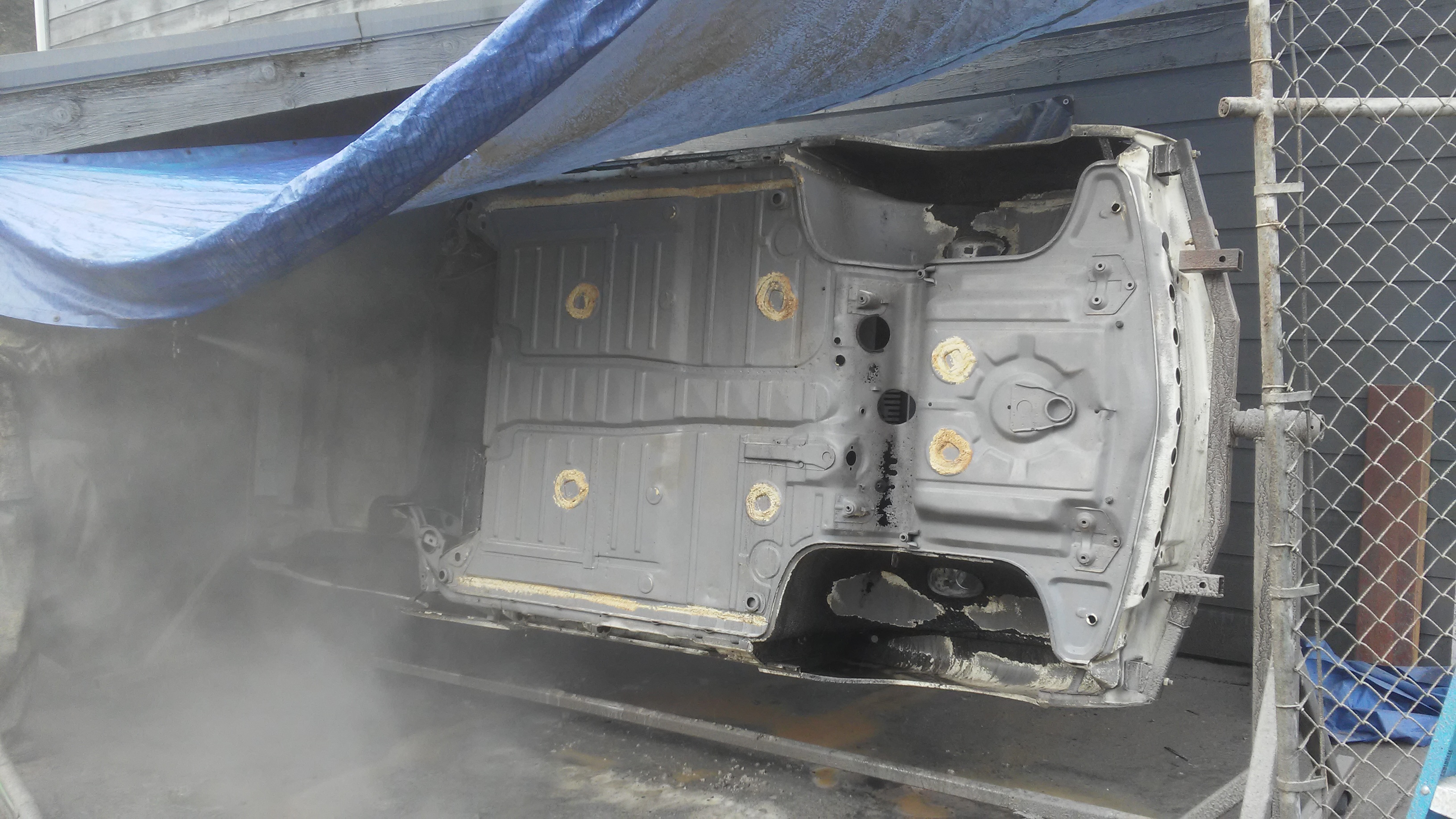

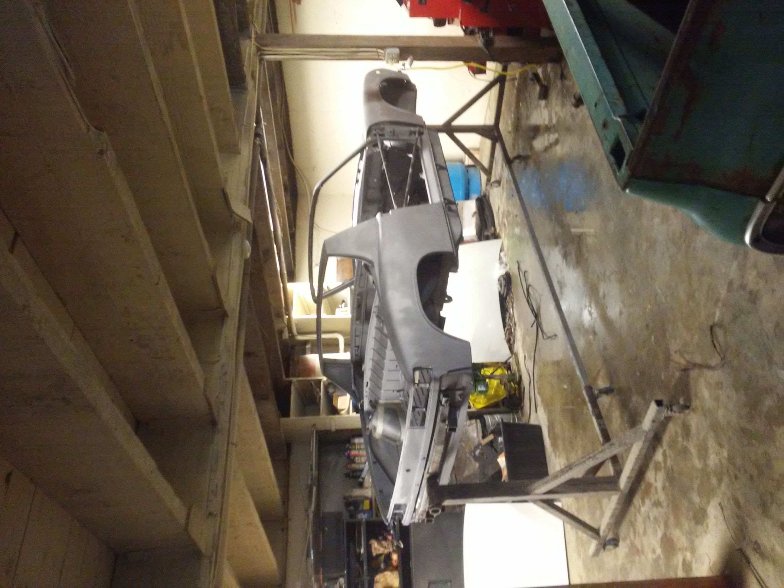

Just a taste more pic later. finished the blasting and looking good. Attached Image Attached ImageAttached Image
