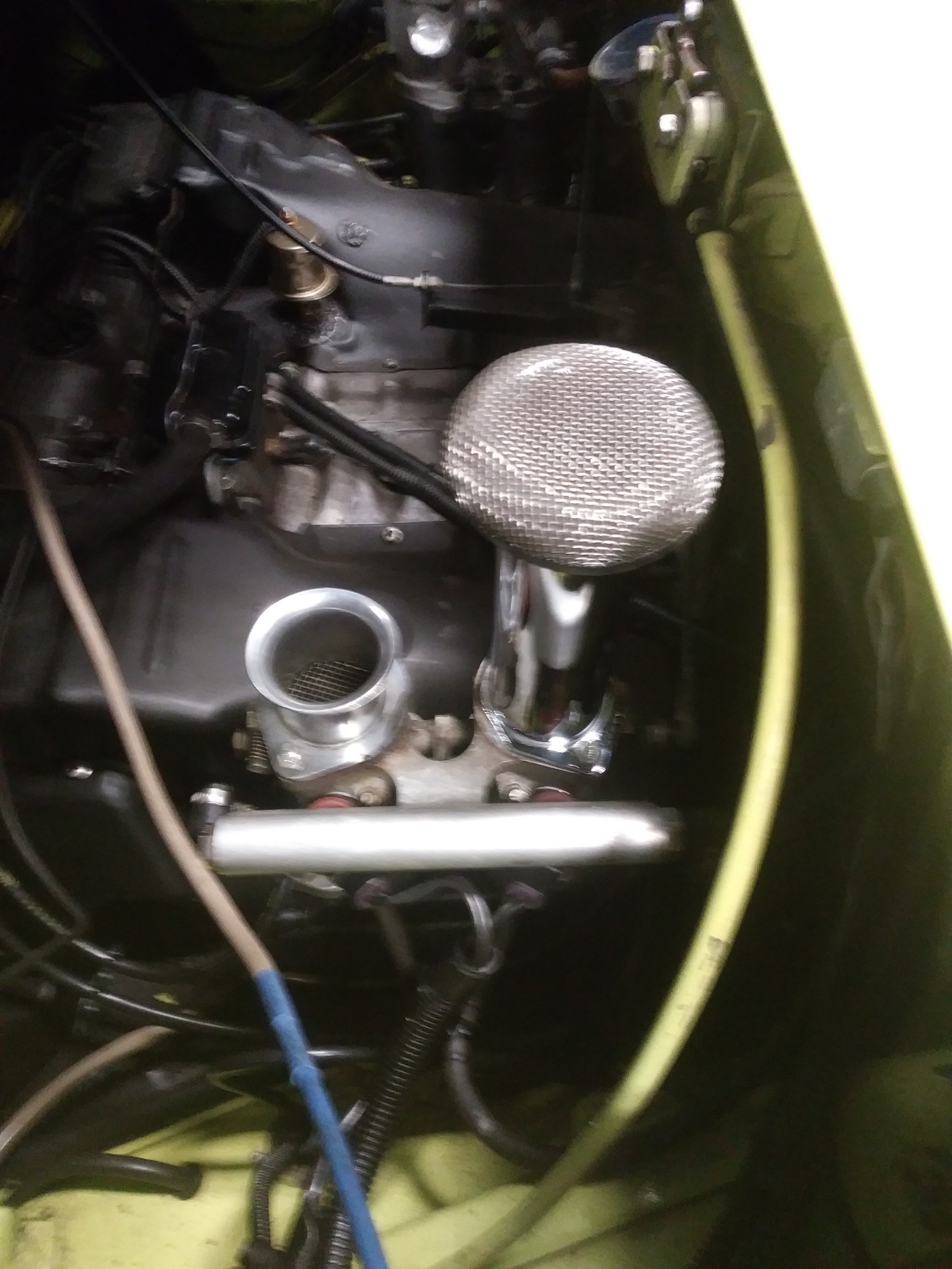

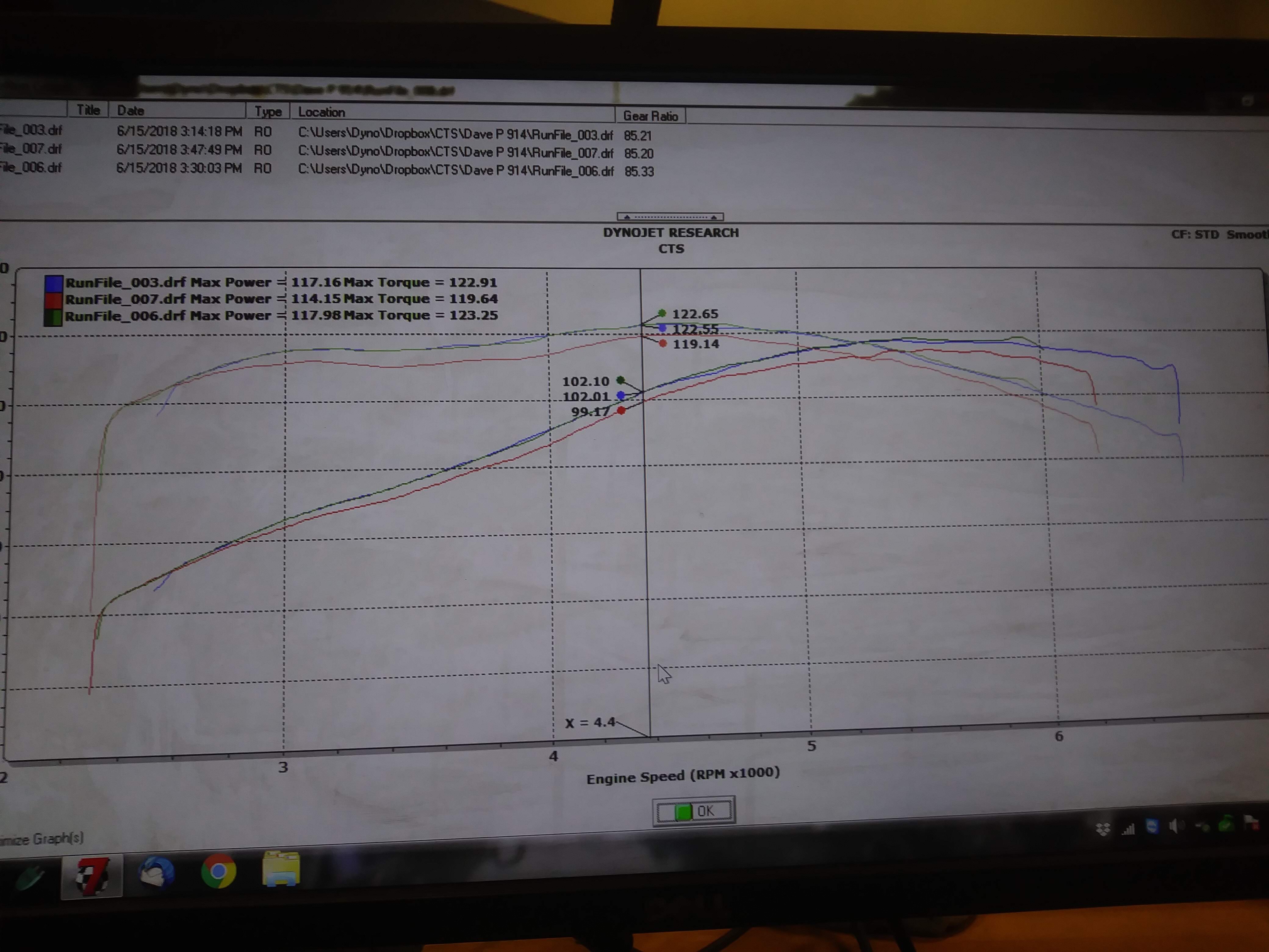

Well, now we got to see how this works out. Motor is built as outlined above, but with 9.5:1 cr and running BP 93 rather than corn. After many long discussions with my good friend and owner of Complete Tuning Solutions we decided pump would do for now. I have plenty of injector if I wanted to try E85 at a later date.
We have 4 hrs of dyno time booked this afternoon, 2 for the 914 and 2 for the CTS vette. The afternoon will be brutal, on cars and bodies. There is a heat advisory in our area till 7pm tonight. But the time is booked, we both took time off work, so here we go. Lots of fans, cool down between runs, watch the oil temps and pressures. I have CHT and EGT gauges to watch also. The bonus is that if we can safely get to the best the motor has to offer in these conditions the car should be understressed in most all others.
No idea how many runs we might get. We have been working on a good road tune for the last year, so after a baseline run we’ll see where the maps might be improved. The SDS has a nice feature to dump more fuel in if you go way to lean. Hopefully with the heat and stress of the runs we never need that feature.
If time and energy permit I have 3 different sets of air horns to try. It would be cool to see how HP/TQ are affected by the different lengths.
Of course there will be a full report to follow.
Still on the rollers. Place your bets on what it makes.

Still trying to get video of final run on to you tube. Had dyno issues. Could not print charts and their wideband was jacked up. We did have the SDS wideband to be sure we were safe, but no way to overlay dyno to sds for the data. Run 6 is tall stacks. Run 7 was short stacks. Other photo is stacks, 1 1/2 vs 6”.
Final numbers were 120hp @ 5500 rpm and peak tq of 124 at 4500 rpm. That’s 138/142 at the crank if a 15% driveline loss is assumed.
Tq is over 100 from 2500-6000 rpm.
I am surprised a little and well pleased at how it all came out.
