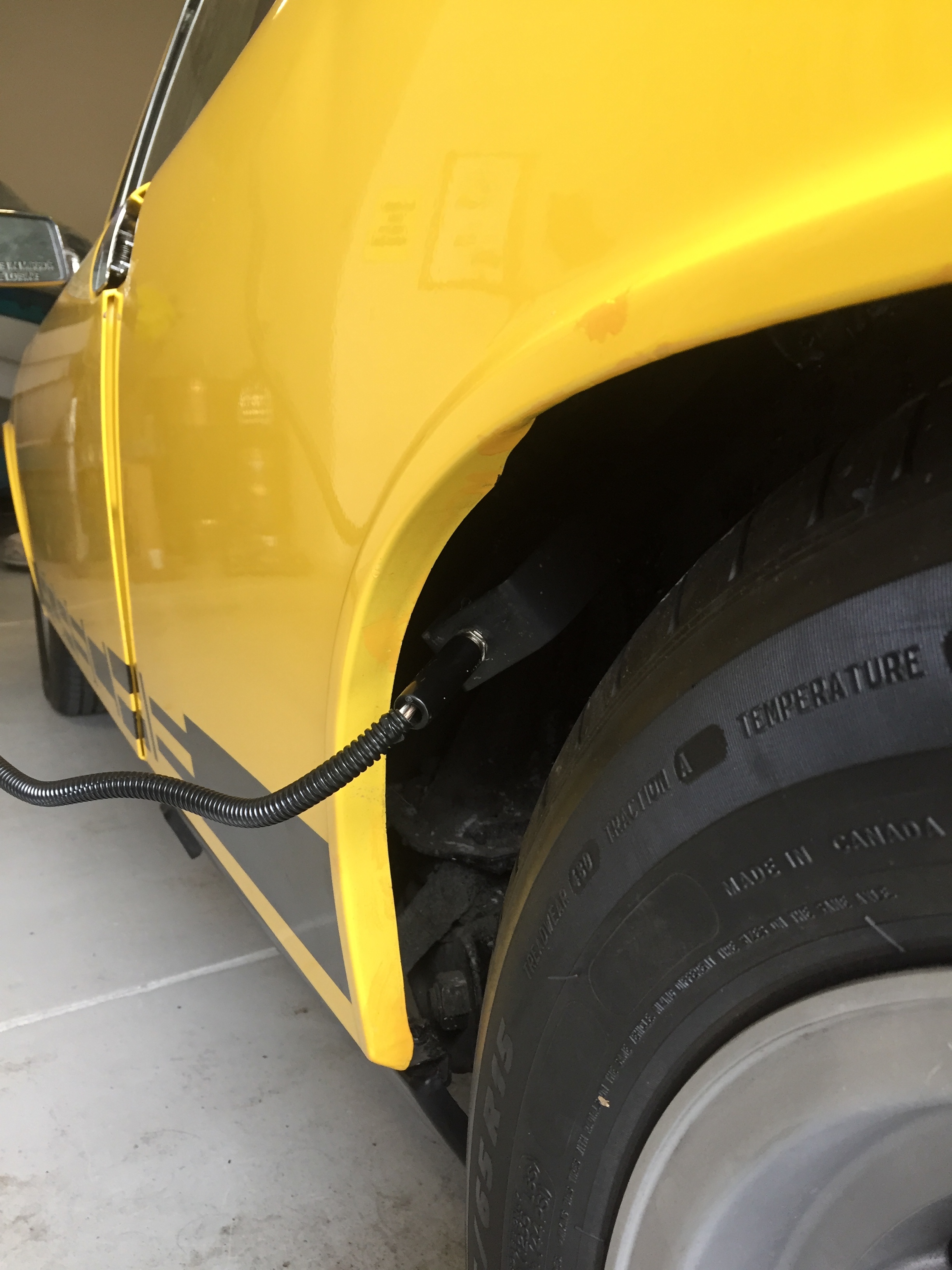

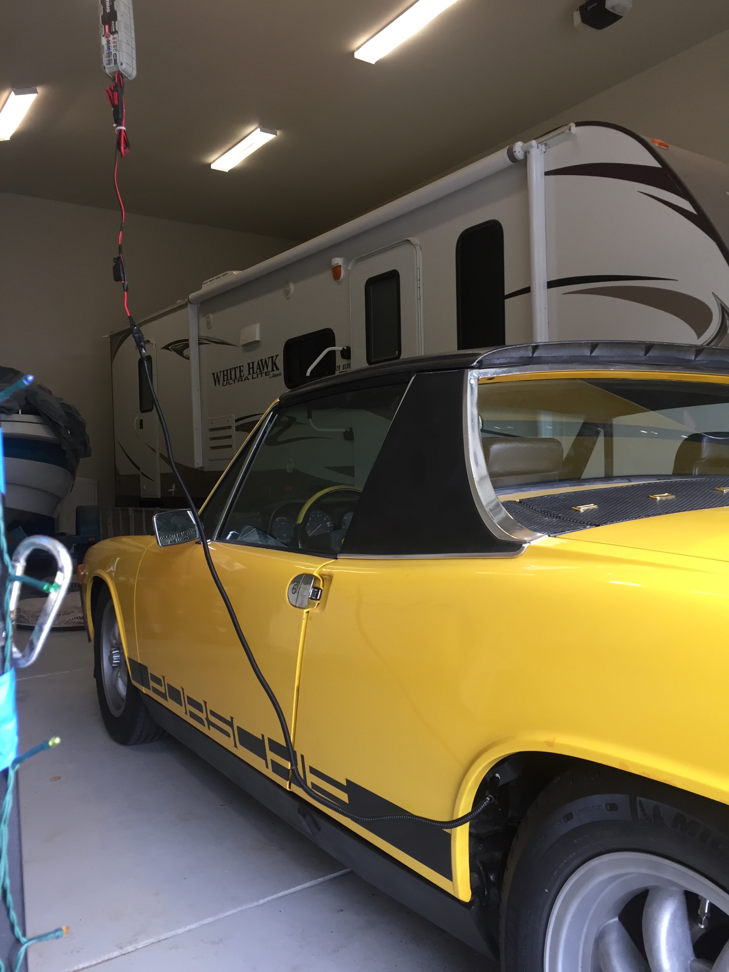

I've used a Noco trickle charger on my Optima Red Top battery in my 914 for many years whenever I'm parked in my garage. Sometimes with bad weather I don't drive the car a lot in the winter. I always open the engine lid and hook up the charger when I pull in the garage. I got tired of opening the engine lid every time and hooking up the charger jaws to the battery posts, and removing then charger and closing the engine lid every time I wanted to go for a drive. Open, close, open, close.....I finally made a 1/4 inch jack port holder under the rear wheel well and connected it with a wire lead to the battery positive. The negative is the jack grounded to the body by the steel jack holder bar. Now the charger hangs over the car, and when I go out , I just switch off the Noco charger, unplug the charging jack and hang the cord over the charger. When I return, in goes the jack and on goes the charger. I'm big on simple!

Good idea to have the cord running past the driver's door so you can't forget to uplug on your way out.

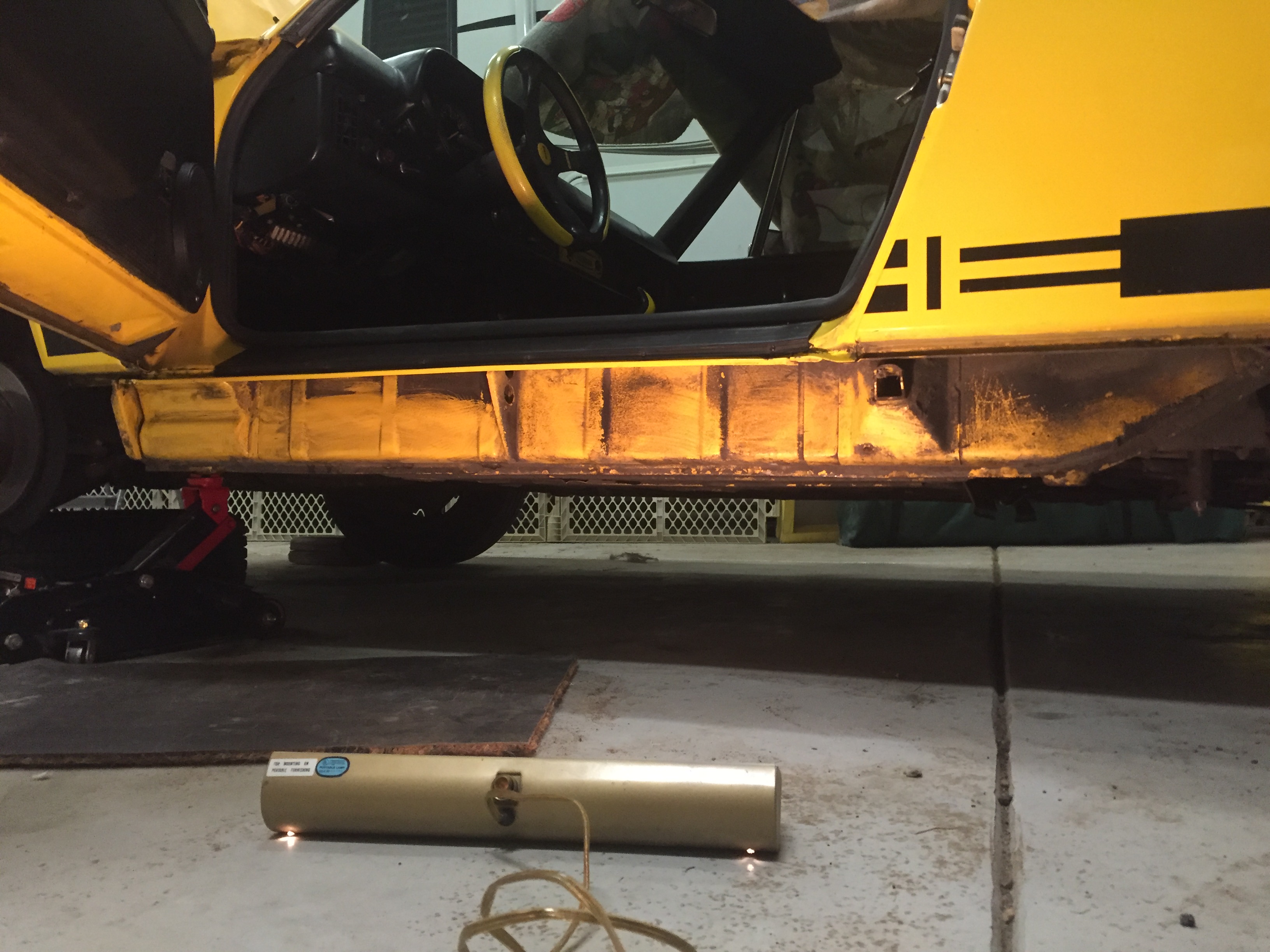

Thanks for the notice, but I just didn't have the door closed tightly. Here's a pic of my California kept dry car longs.

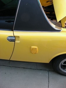

I've added a 110v plug to the side of my car - it has the auto-eject feature that was mentioned earlier in this thread. I've never gotten around to using it, though.
http://www.ev-propulsion.com/charging-accesories.html
The reason I never did is that the plug is right near the driver-side door, so I can't get into the car without unplugging it. (IMG:style_emoticons/default/smile.gif)
